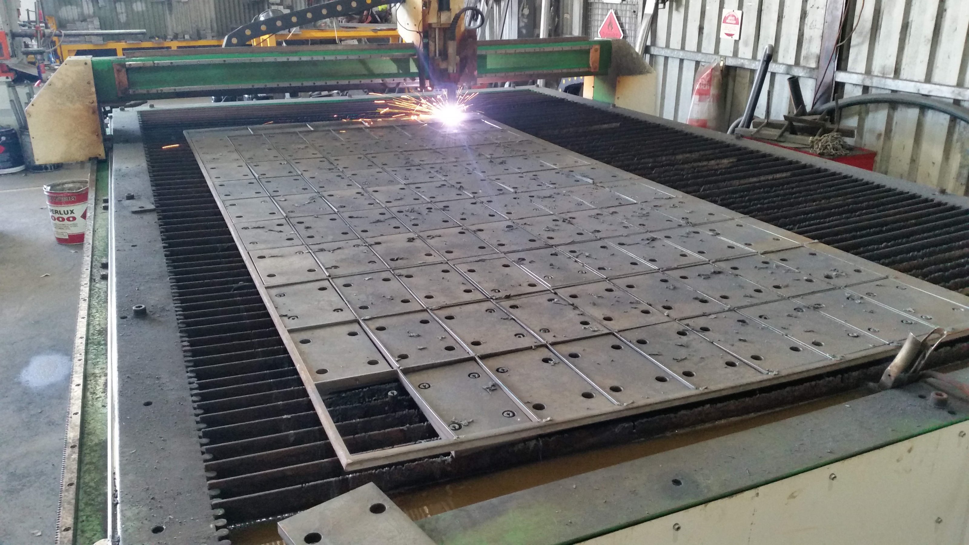

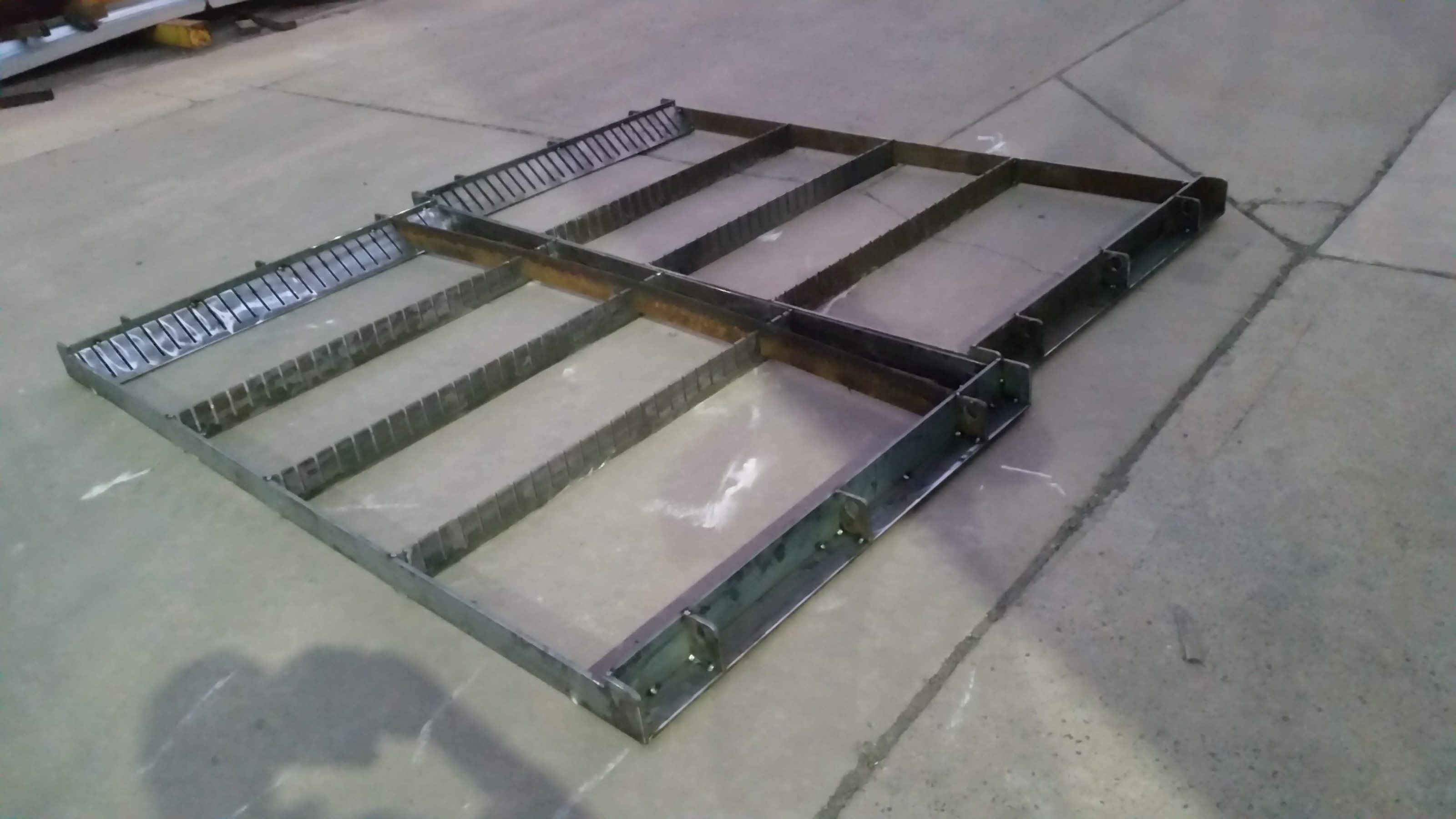

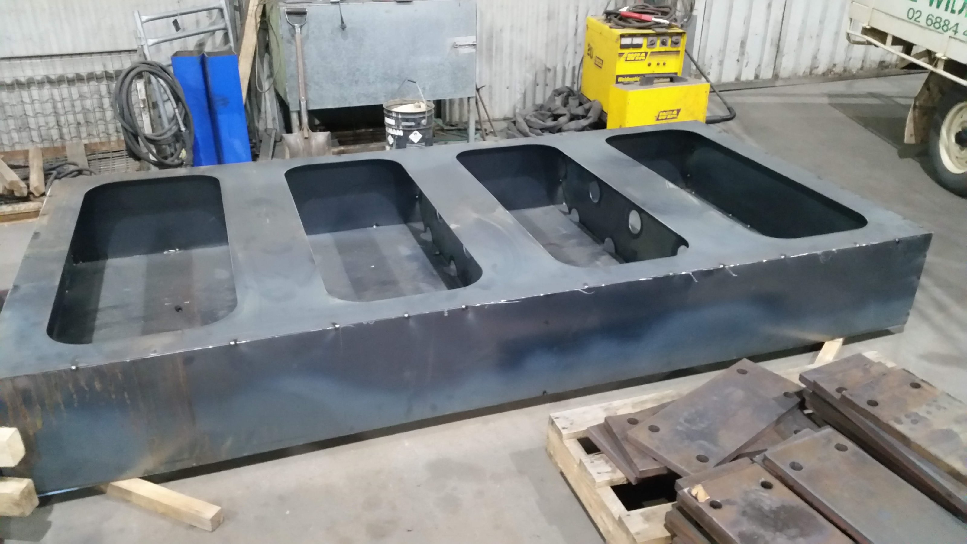

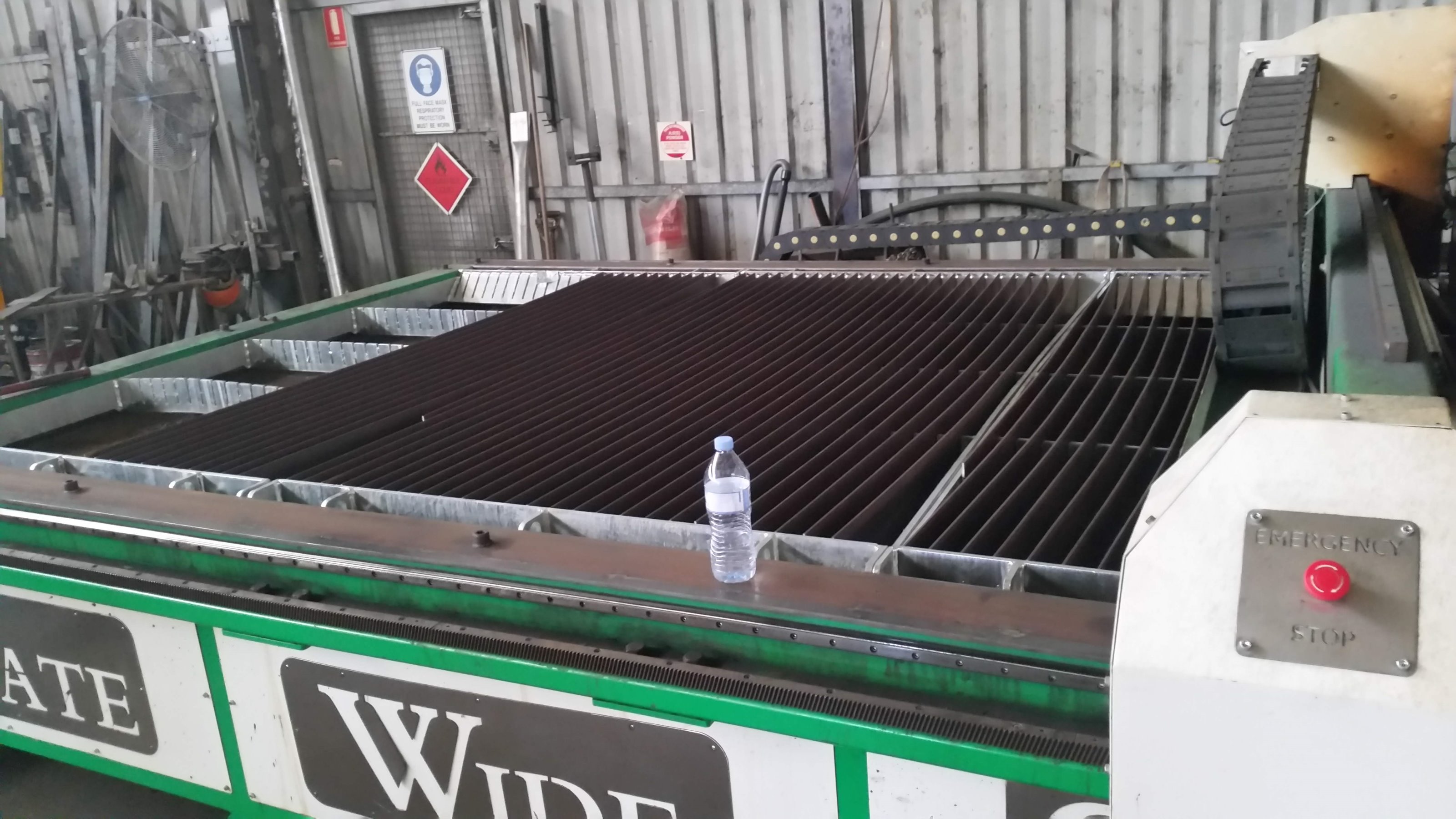

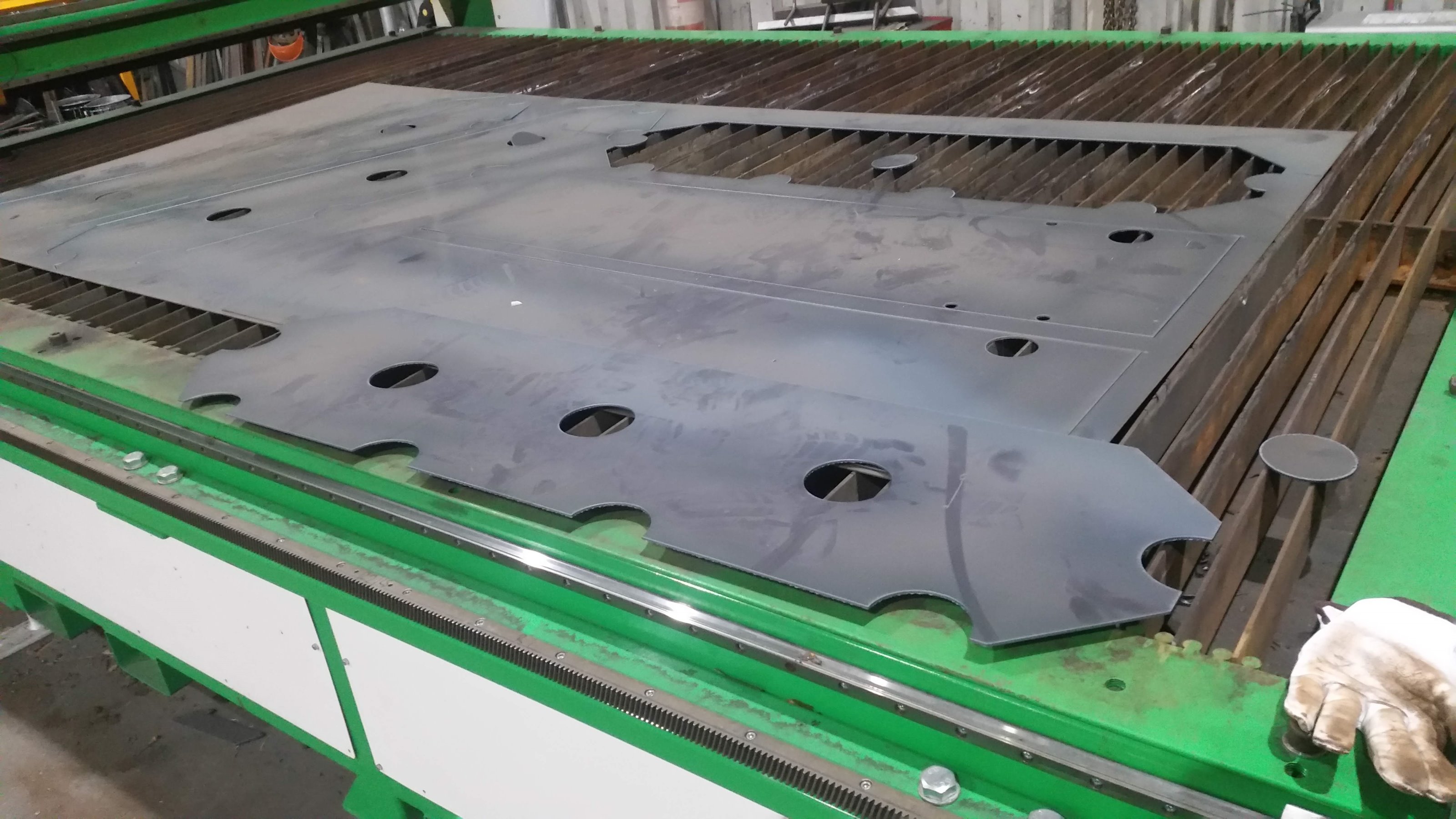

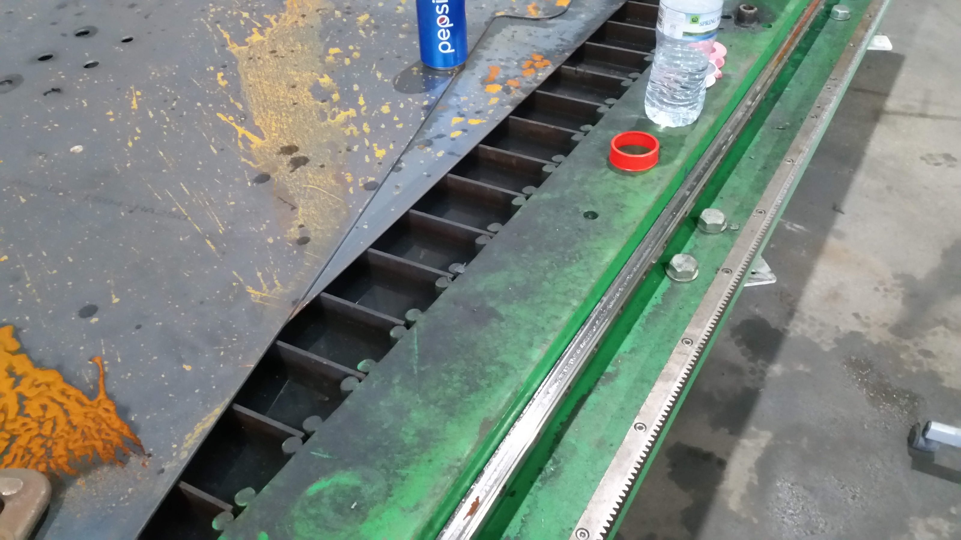

Ill add some of my experience in this thread, lot of good info in here already,
Production plamsa is messy, really messy. My machine cuts at up to three of these type of sheets per day,
After two weeks of cutting I had to clean out the machine and filled up half a 44 gallon drum full of plamsa sludge,
Due to the need to clean out the machine constantly I had to redesign how my slats fit into the table.
My first design had the slat holder as part of the machine frame. This meant I had to put out each slat every time I needed to clean out the machine.. Very time consuming.
My new design incorporated removeable sections that the slats fit into,
Now when I need to clean out the machine I lift out each section with a forklift and a jib instead of removing each slat at a time,

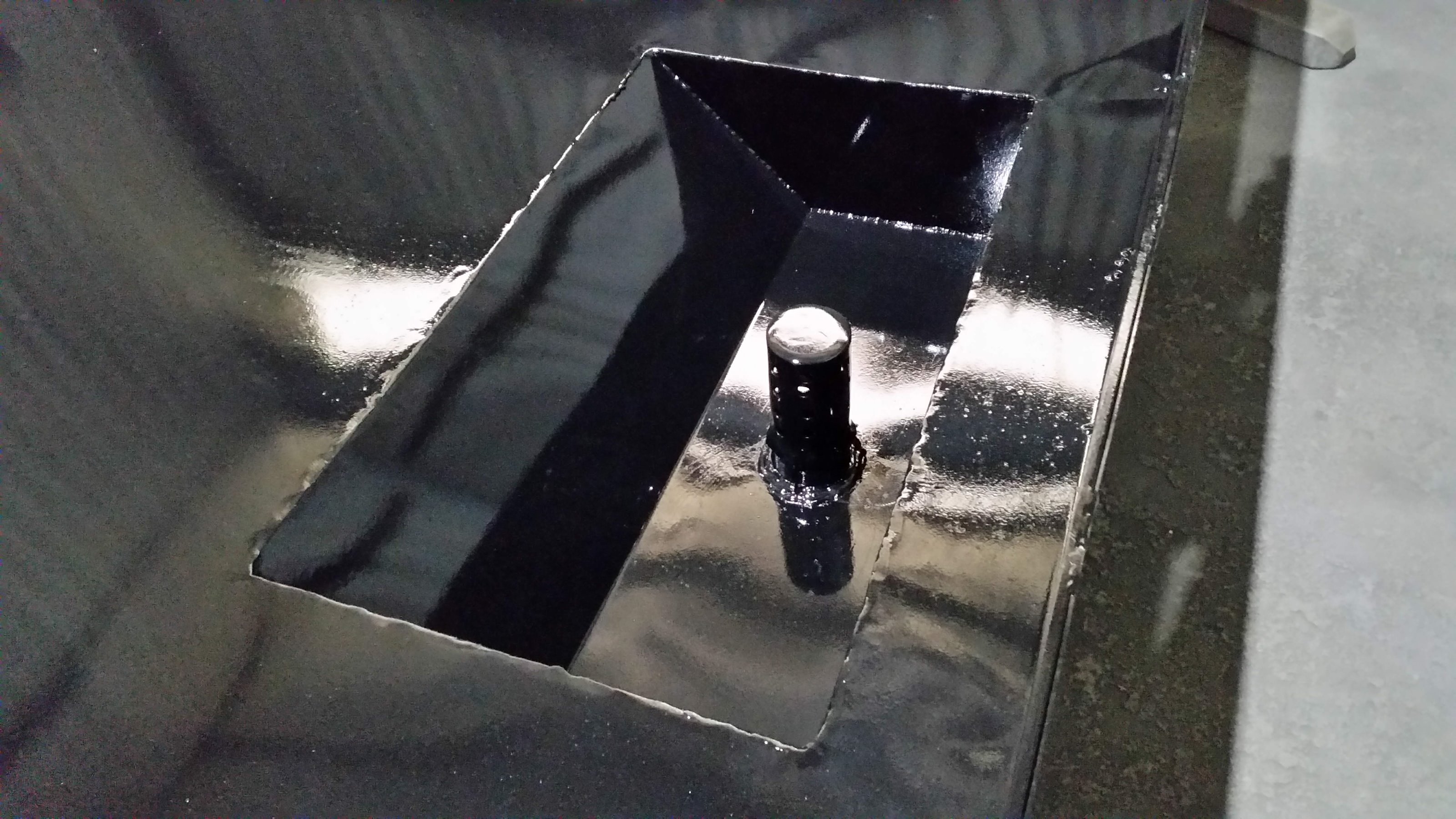

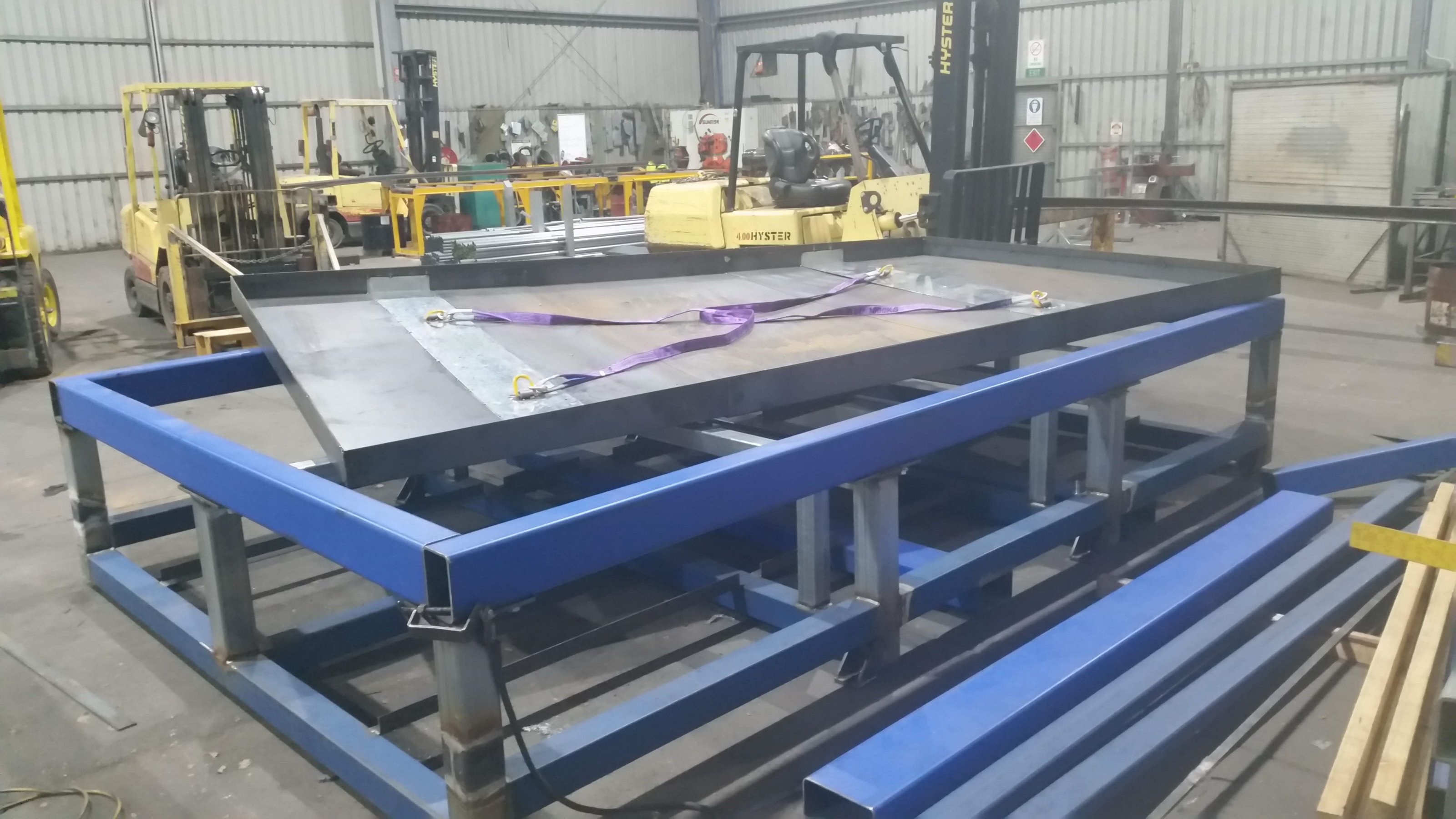

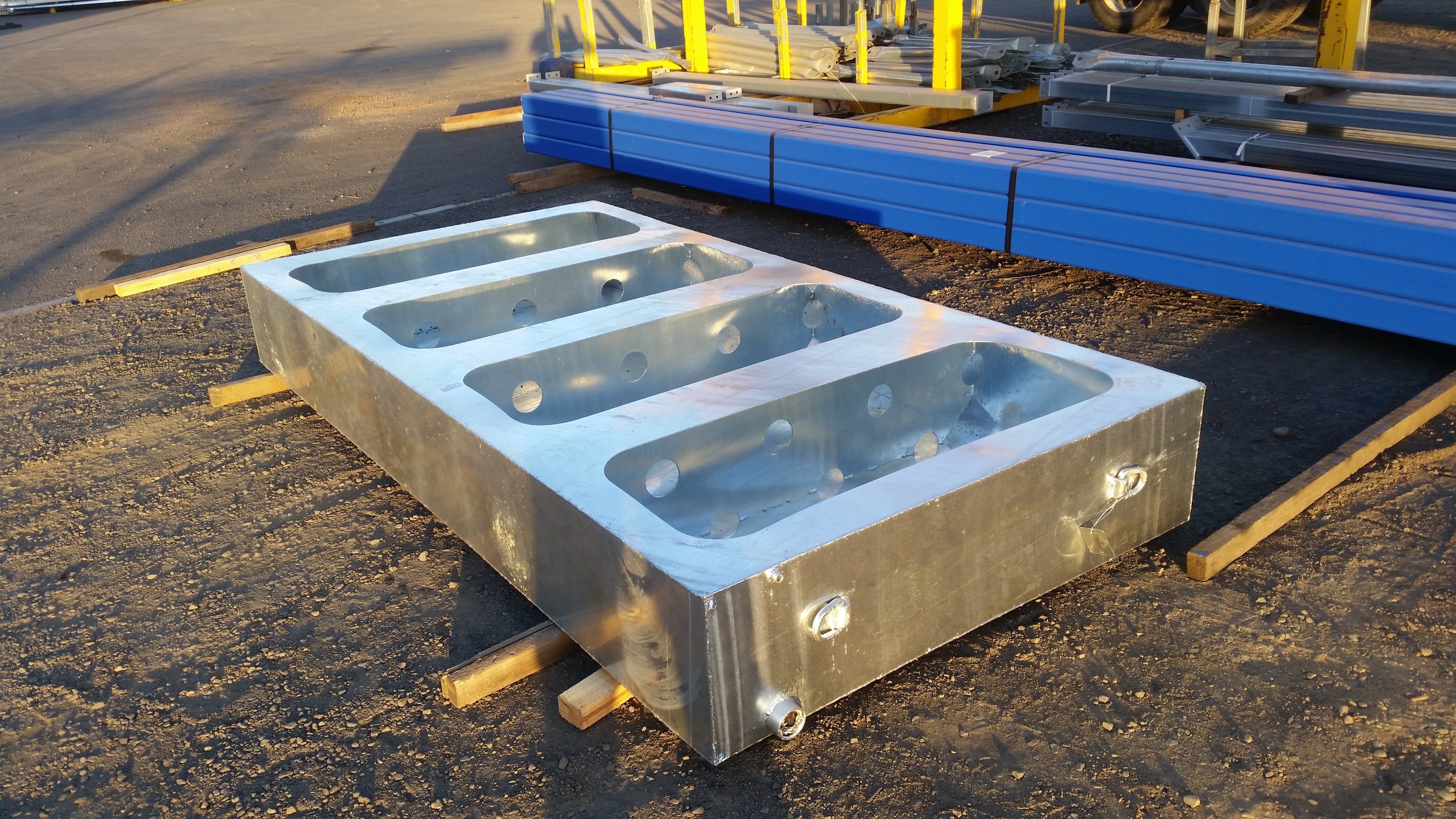

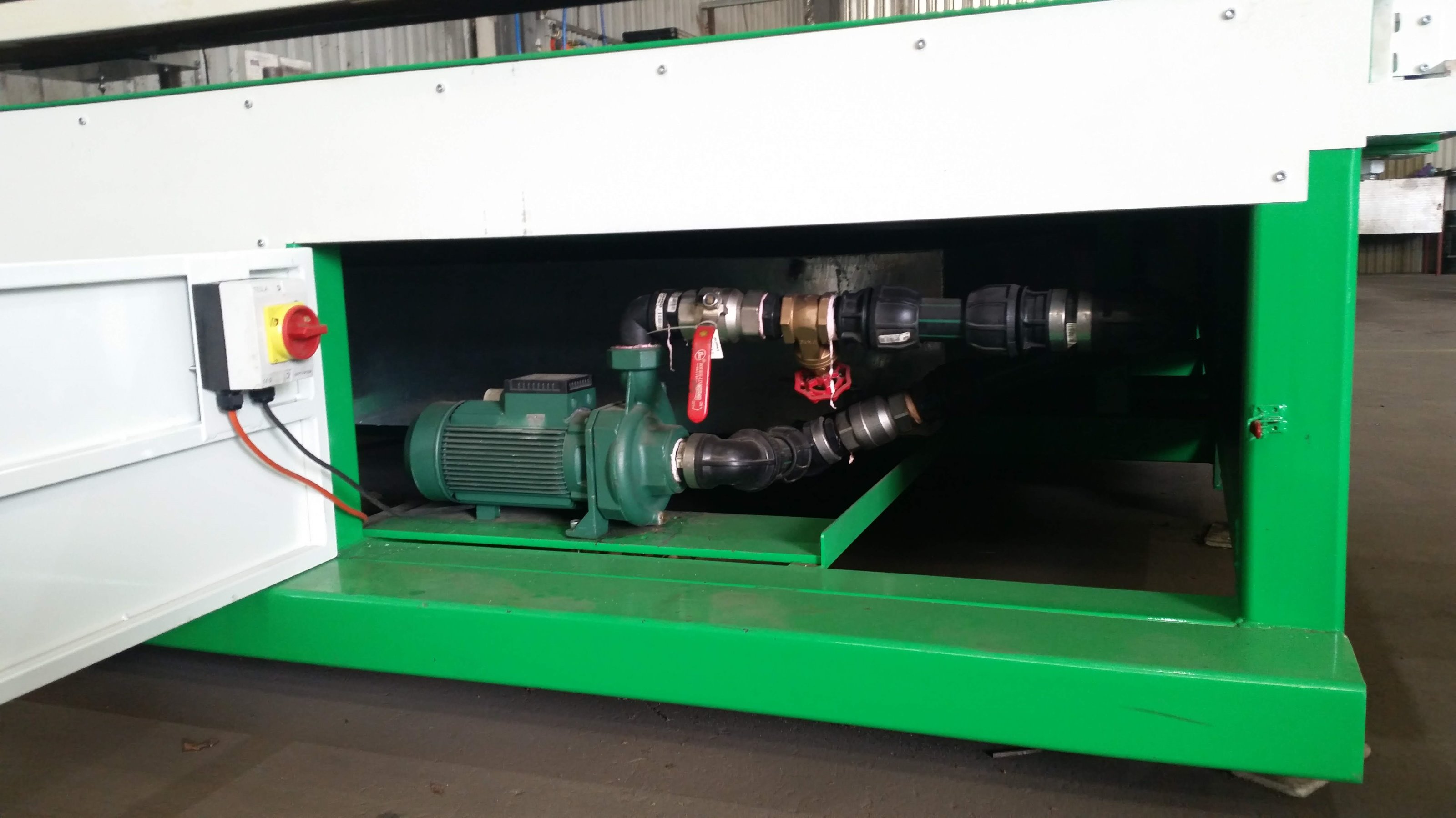

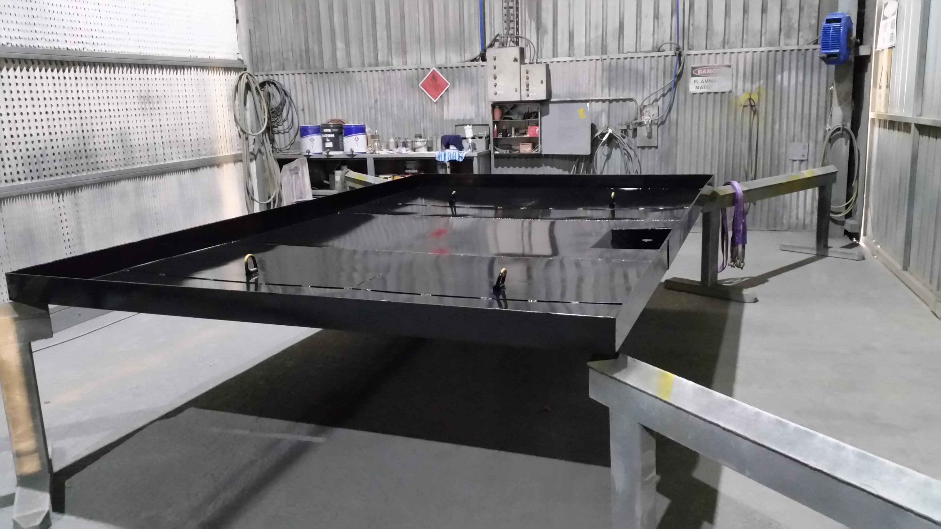

Water table design,
My table incorportates a large water pan made out of 1.6 black steel sheet,
My slat holder mount laps over the pan so the water level can come up to the top of the slats.
To move the water I have used a pump instead of the common approach to pressurize the water tank. This is for safety in a work place environment.
My tank is made from 3mm black sheet, I had the tank galvanised after I made it to ensure it will last a long time.
I have left the top of the tank open to allow easy cleaning of sludge. I was meaning to make covers to stop evaporation but I have used it for about half a year with out them and have not noticed much everporation occurring.
