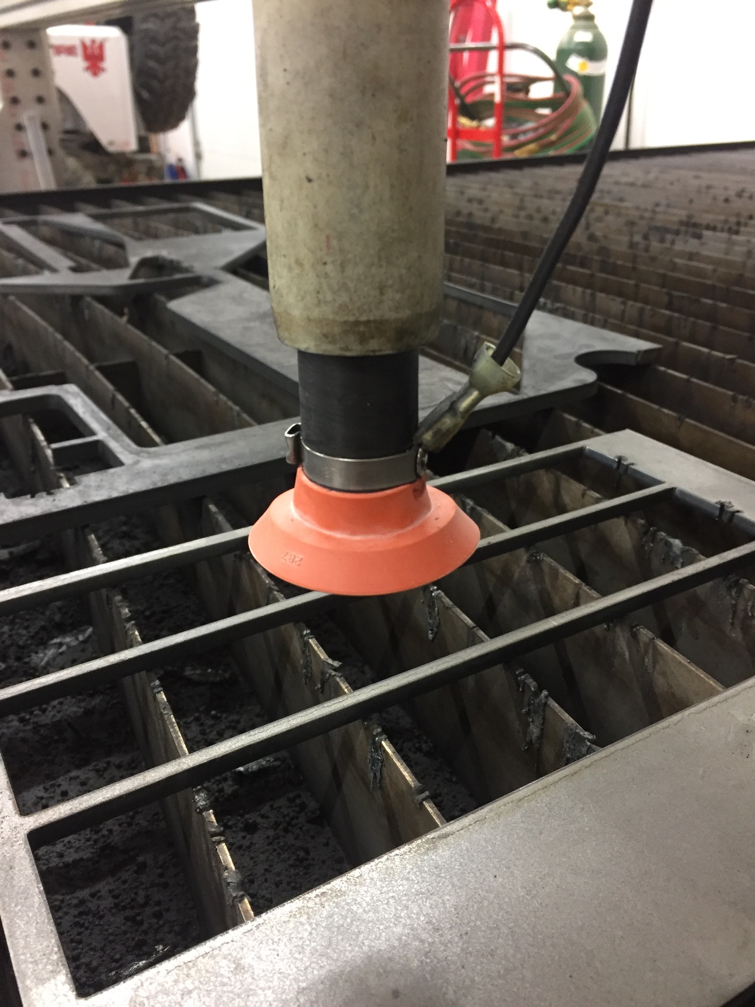

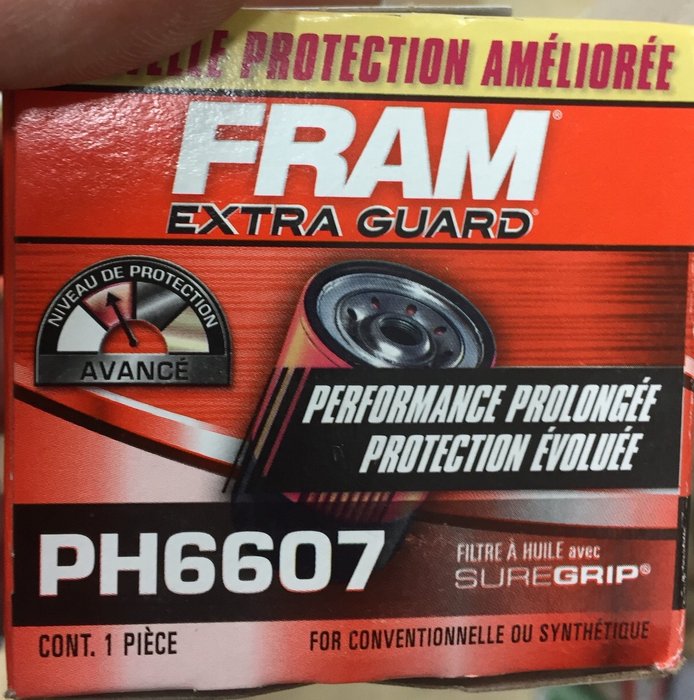

not my idea but something i came across that was worth re posting here. it would not be hard to make a mold to make something like this for any torch or shape you wanted but it would not be as cheap as stealing one from an oil filter. so a cheap solution to a real problem with water tables. i think it was for hypertherm torches if i remember right.

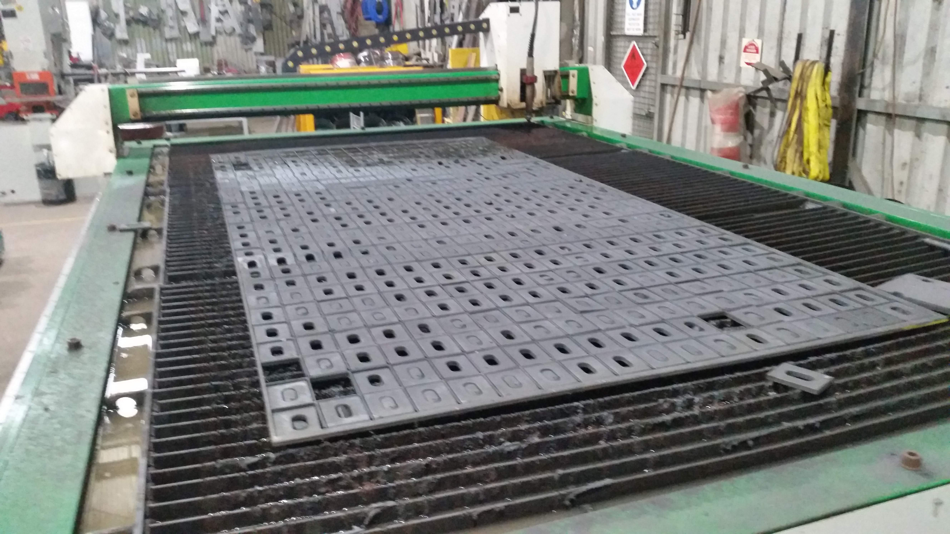

How do you think one of those cheap machines would go with this? Its only 10mm thick so should be within the capacity but I think the duty cycle would be a problem.
