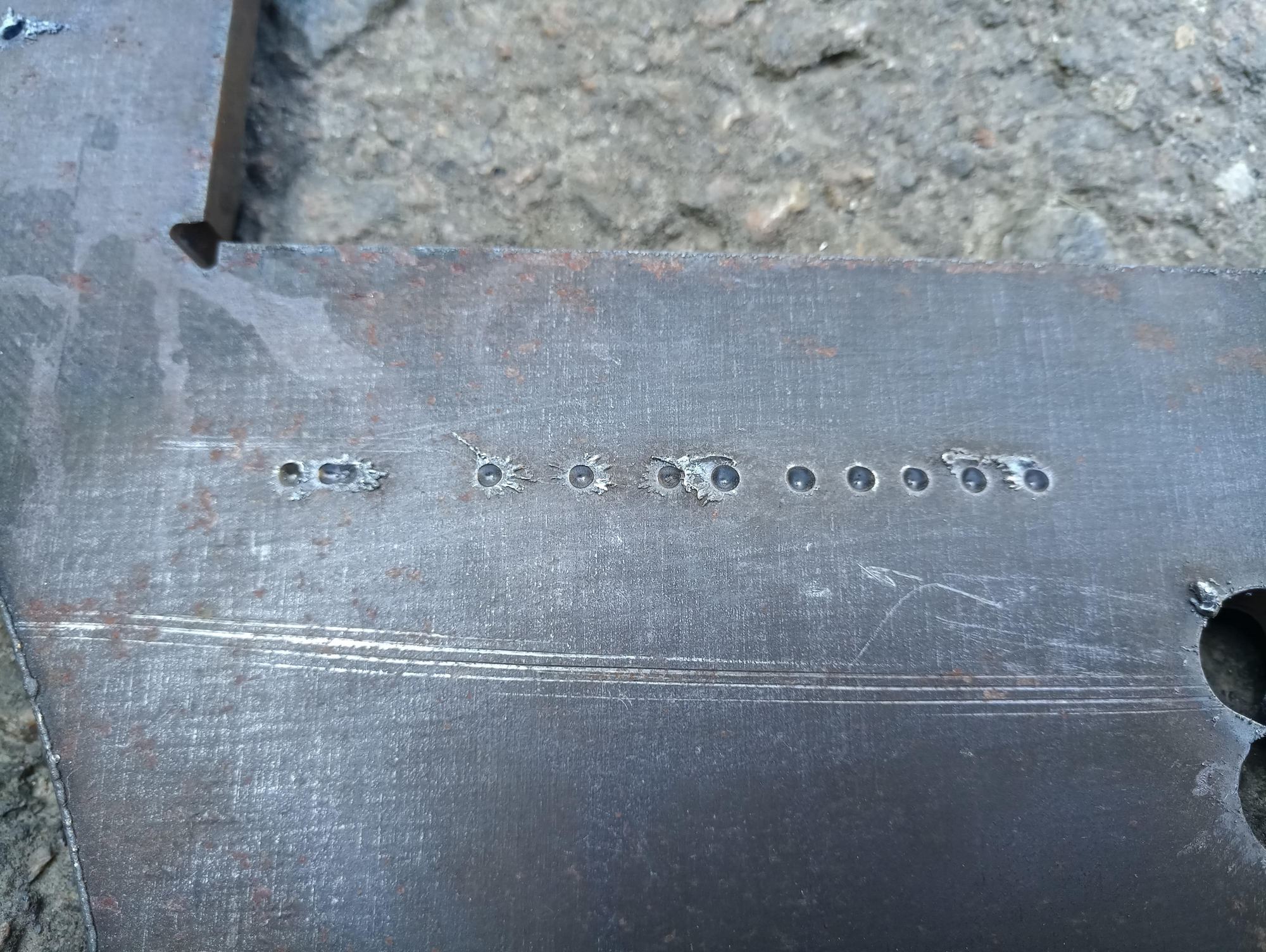

Yeah, I have been playing around with a sim, I was using an X move of 0.0000001, pierce and cut height of 6.4 and pierce delay of 0

Why do you HAVE to have movement between M3 & M5?
a 2mm dimple is not that bad, remember that the normal kerf width will be somewhere between 1 and 1.5mm, so if you are blasting hot air (up to 20,000ÂșC) at a piece of steel it will first form a crater where the metal from the middle is displaced outward and upward.
I've not measured a dimple from a centre punch before, but its provably at best only half that, but would take much more time to mark out (with better accuracy) than doing a number of dimples on a cnc table and then bench / pedestal drilling them.

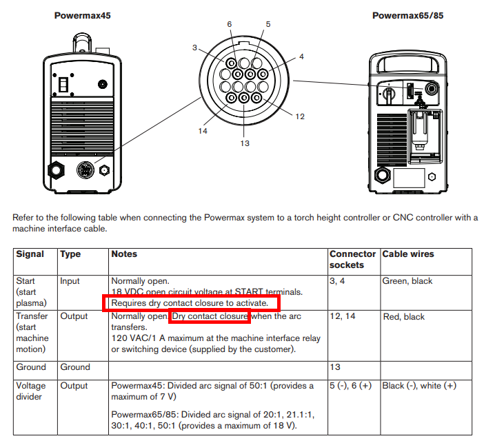

The ArcOK signal is normally a dry contact closure (i.e. a mechanical relay), and depending upon which relay the plasma cutter manufacturer used, they will all have some delay between the "actual" arcOK signal and the time it takes to close the relay.
I have in the past (with other THC's) changed the relays to be much faster acting.... to reed relays for example. Like the datasheet for this relay.
cotorelay.com/wp-content/uploads/2014/09..._relay_datasheet.pdf
operating time - 0.35mSec (350uSec), release time 0.1mSec (100uSec).... but only 5V or 12v
other variants are available at 24V......
cotorelay.com/product/8l-series-spartan-dip-reed-relays/
All just depends what you want / need.
Point being, maybe just check the front end specs within the plasma cutter if you are curious to see what they have left you with for the ARCOK relay within the machine. (be honest, I've not actually checked the PMX45, but will do tonight out of curiousity as I have the cover off).

Hi, I'm using HF ignition plasma. And for marking holes I use M10 code
I added or2 and connected with motion.digital-out-00 and with plasmac: torch-on
Empirically I determined that at a height of 5 mm and a delay of 0.15s make good marks for drilling.
And before marking I remove the mass clamp.

01 Aug 2019 11:24 #141087
by robertspark
what is the "mass clamp"? Do you mean the "work clamp"?
Bascially its all trial and error, and if you try a few setups then whatever works best for you works!
point being try different heights, and different times, I've not removed the work clamp, but no harm in trying it (just you won't get an ARCOK signal as the arc won't transfer...... but I can see the reasoning behind it as the torch fire duration is so short its just another start sequence.

01 Aug 2019 12:10 #141096
by Franklin
Replied by Franklin on topic Another plasma component...
yes i mean the work clamp. Sorry for my English.
I do not wait for the ArkOk I make marks with the pilot arc
when the work clamp connected, the marks are deeper but not round enough.
- robertspark
- Posts: 915
- Thank you received: 216
01 Aug 2019 15:07 #141113
by robertspark
Rod, those relays are solid state using a Mosfet, normally you'll see that with plasma that the datasheet asks for "dry contact" (i.e. non-solid state).
I think it is to do with the leakage current and also maybe the minimum switching current.
To be fair those solid state relays seem fine, but some optoisolators probably are not a good idea. Hence why I switched to reed relays.
Just something to consider or be aware of .... if it works, it works.... but may not work for everyone... if it ain't broke don't fix it etc.
I agree 100% about the 1kHz (1mSec) loop, anything being faster than this is fine. It was actually Keith (aka Beefy . mancavedweller) who pointed it out a couple of years ago now to me, about looking for relays which are consistent. i.e. a 10% variance on a 1mSec relay is not much.... but 10% variance on a 500mSec relay is a lot more of a consideration... hence again I try to find a branded product with a good believable datasheet if my aim is consistency in something.

- robertspark
- Posts: 915
01 Aug 2019 15:22 #141116
by robertspark
Replied by robertspark on topic Another plasma component...
Rod,
Also the thing to probably watch is the switching frequency at 50Hz, i.e. you can't (or shouldn't) switch it faster than 20mSec, even though it makes in 250uSec, and breaks in 2uSec
also the RS datasheet does not really tell you the switch on and off voltage (it says mnimum switching voltage 10, maximum 30V)
docs-apac.rs-online.com/webdocs/1696/0900766b816969f5.pdf
compared to the ones I posted say for a 24V one, it says the switch on voltage is 18 v and the switch off voltage is 2V
(i.e. a clearly defined wide window of high and low so noise is less likely to be an issue)..... but magnetism / magnetic field effect may be a consideration with a reed switch relay I admit.....
again If it works ... it works.... (maybe someone else reading this may want to be aware of trying to understand all considerations)
