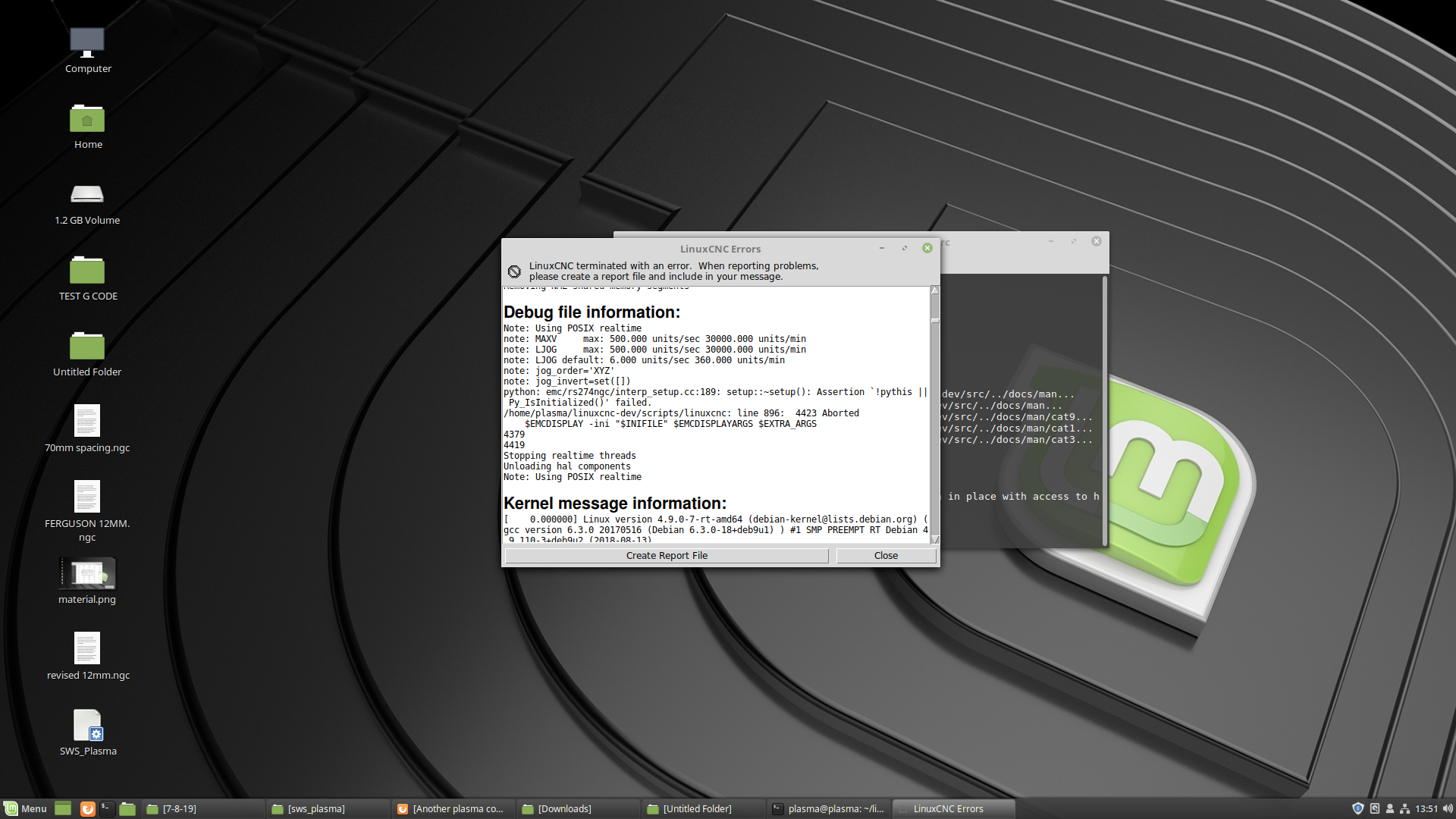

07 Aug 2019 03:53 - 07 Aug 2019 03:54 #141564
by thefabricator03
Replied by thefabricator03 on topic Another plasma component...
Phill,
Sorry to be a pain but still having problems,
Did a git pull today and still not working,
When I open linuxcnc I get this error,
When I try to load g-code I get this error,
And when I close linuxcnc I get this error,
Any idea what Ive screwed up?
I have run materialverter with my lastest tool setting from Sheetcam.
Last edit: 07 Aug 2019 03:54 by thefabricator03.

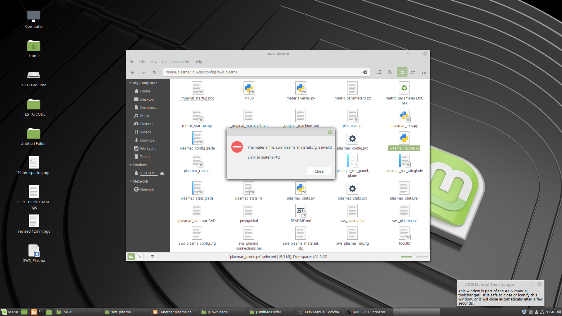

07 Aug 2019 03:58 #141566
by phillc54
The shutdown error has been reported
here
, it doesn't seem to affect anything.
Check your material file (sws_plasma_material.cfg) to see if anything is amiss in tool number 2

- phillc54
- Posts: 5711
- Thank you received: 2100
07 Aug 2019 04:19 - 07 Aug 2019 04:19 #141568
by phillc54
SORRY, that is something new I have brought on.
After a recent report I added error handling in the materials file.
All entries now require a value.
You are missing entries in a few materials for THC and Cut Amps and Cut Volts.
If you fill them in you should be good to go.
I could probably default THC, Puddle Jump Height, Puddle Jump Delay and Cut Amps to 0 if there is no entry but the others need to be there.
Last edit: 07 Aug 2019 04:19 by phillc54.

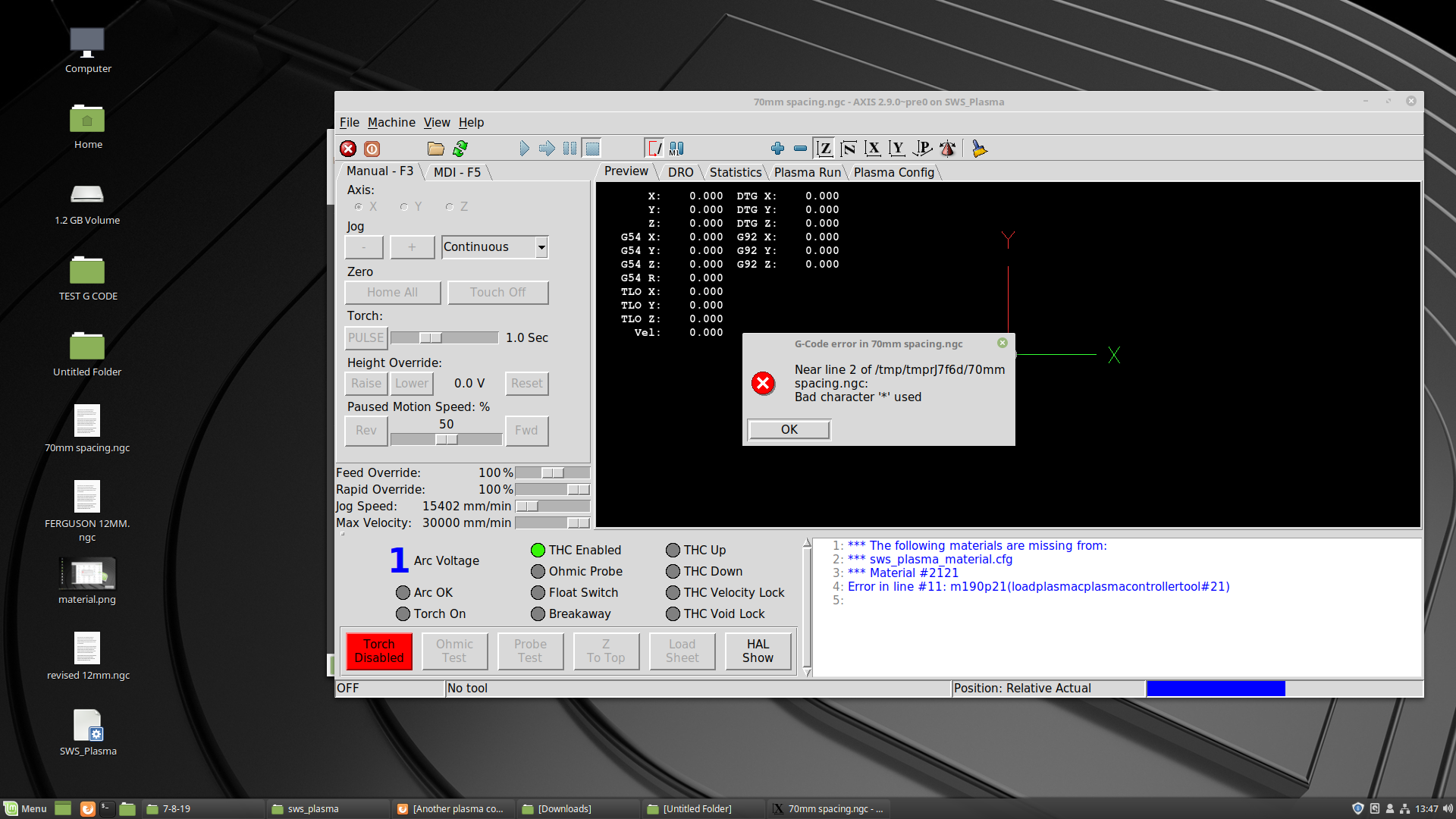

07 Aug 2019 04:26 #141569
by thefabricator03
Ok thats sorted now, And yeah that would help if you could make that change for future revisions,
Still having the problem with the G-code file tho, I haven't been able to manually edit the g-code since I cannot find the * symbol anywhere in the code.

07 Aug 2019 04:33 #141571
by phillc54
The * is referring to the * in the GCode display of the second pic you posted.
That is there because it cannot find material number 2121 which of course doesn't exist...
For some reason it seems it is reading line 11 of you code incorrectly.
Edit line 11 so there is no comment, just M190 P21.
Actually that format looks like you are not using the recent version of plasmac_gcode.py.
