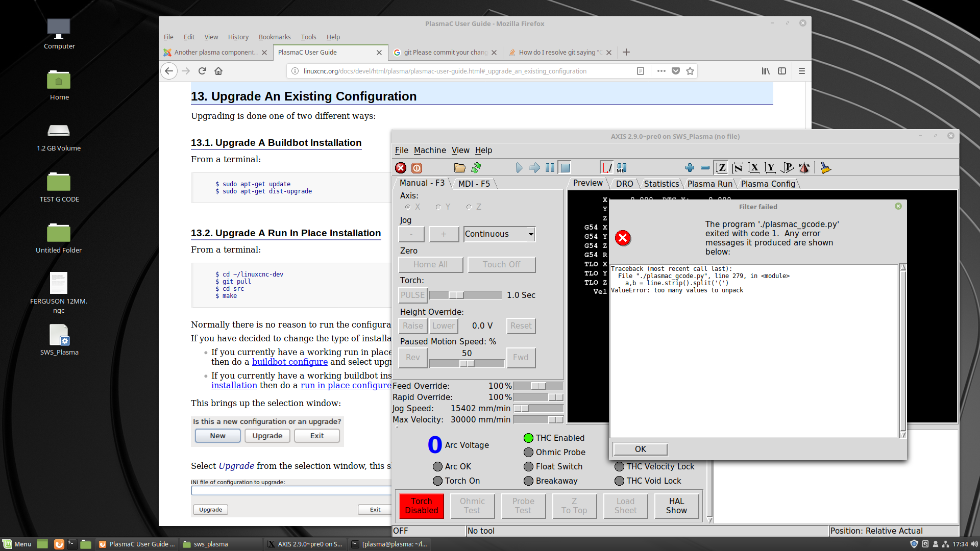

06 Aug 2019 07:36 #141483 by thefabricator03
Replied by thefabricator03 on topic Another plasma component...
Phill,
Just did a Git Pull and I get the following error message when I try to open a gcode file,
Attachment not found
  • phillc54
  • phillc54's Avatar Topic Author
  • Offline
  • Platinum Member
  • Platinum Member
06 Aug 2019 07:44 #141484 by phillc54
Yes, I found that today but haven't pushed the fix yet.
If you use the code I posted for you to try here it will fix it as well.
If you just want a quick fix change line 279 of plasmac_gcode.py
from:
            a,b = line.strip().split('(')
to:
            a,b = line.strip().split('(', 1)
