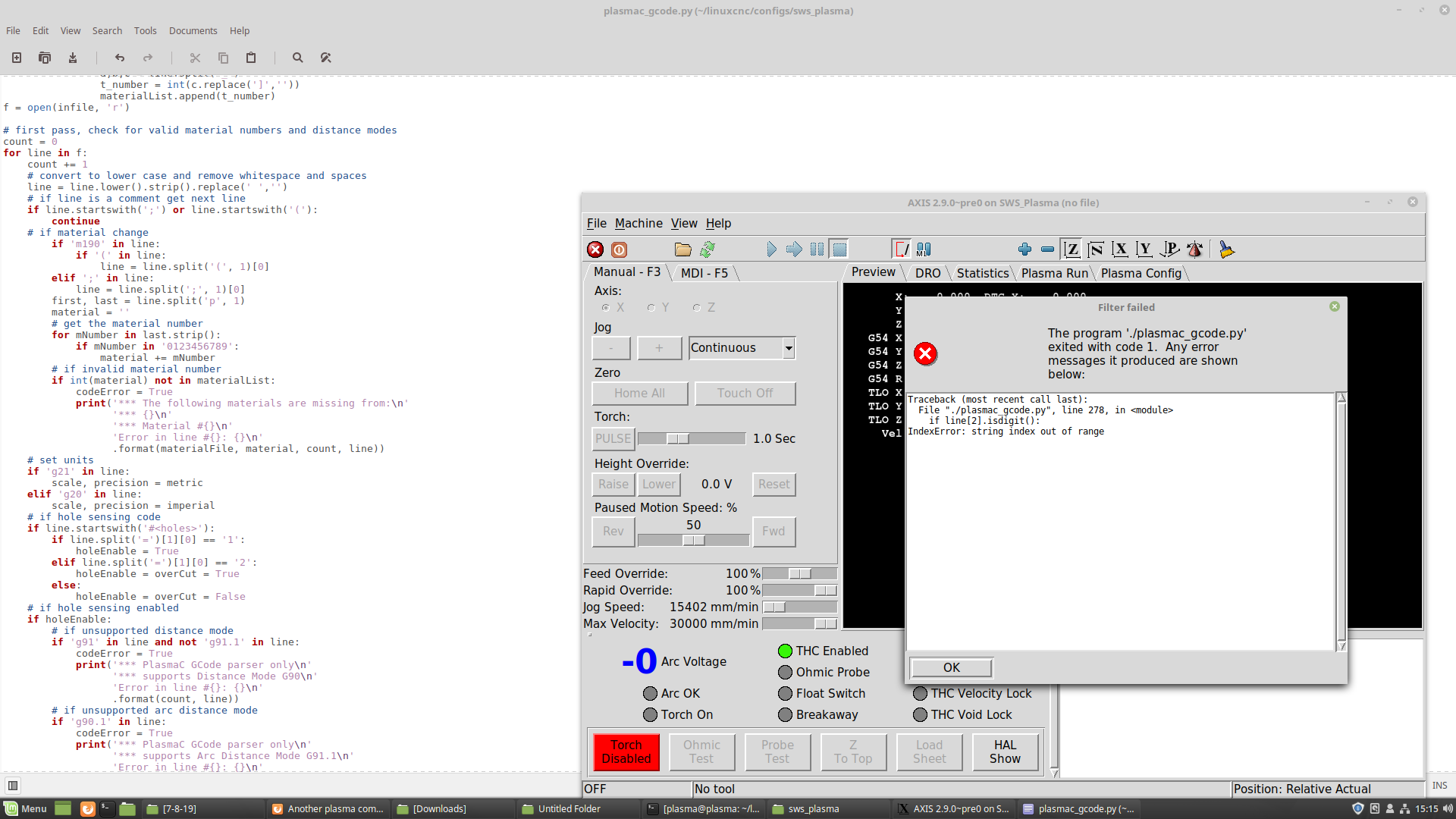

Lol new problem,
Edited the G-code and get this error,
Dont worry we will get there eventually

Try this:
Edit plasmac_gcode.py so it looks like:
200 if 'm190' in line:
201 if '(' in line:
202 line = line.split('(', 1)[0]
203 elif ';' in line:
204 line = line.split(';', 1)[0]
204 first, last = line.split('p', 1)Please Log in or Create an account to join the conversation.

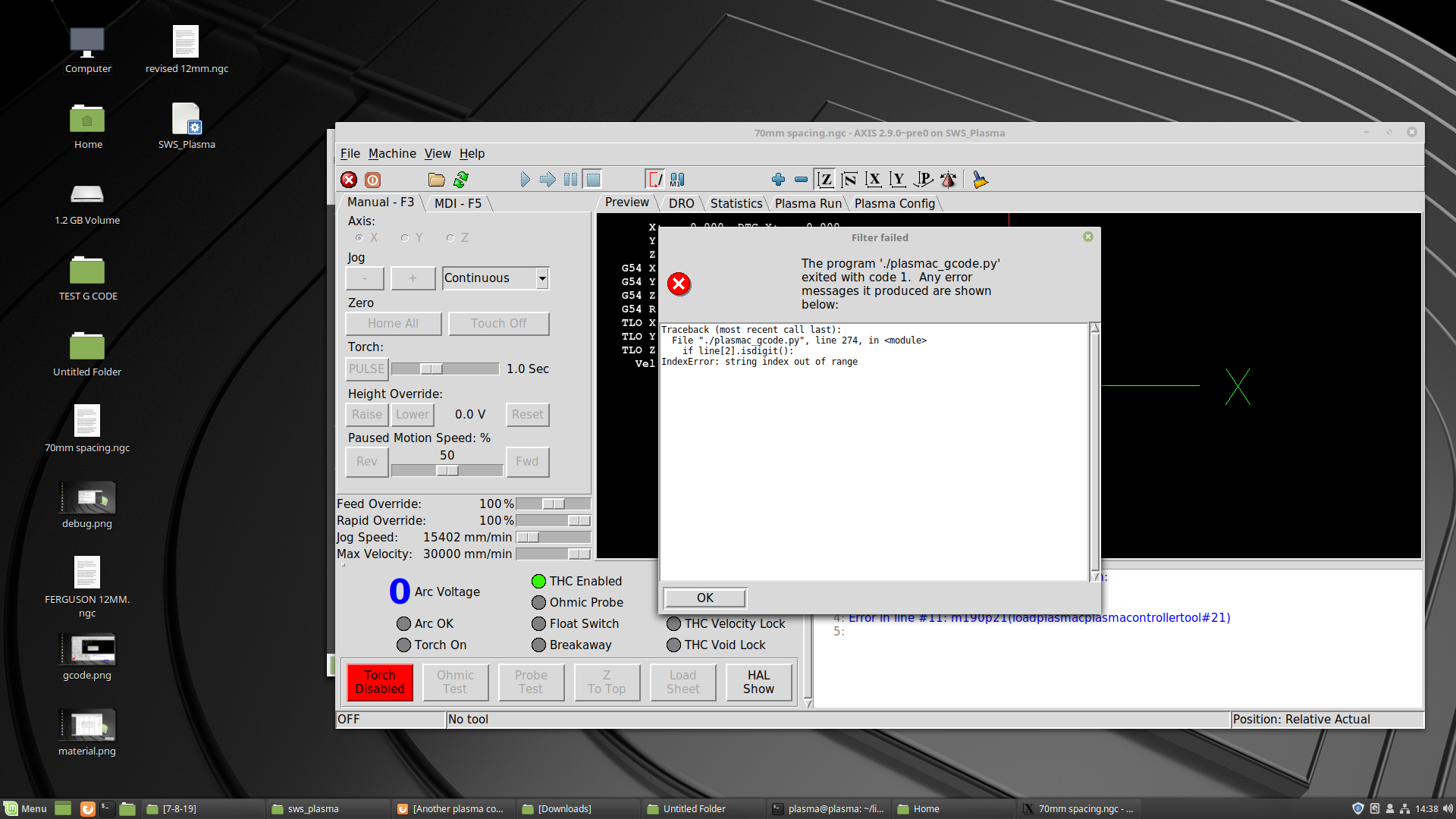

Ok did that now this one,

can you post the ngc file

Have you got a Pnn after all the M190 codes?
You should be able to restore your ngc file to its original...
Forget that...
Forget that...

This is the unedited file.
Replied by thefabricator03 on topic Another plasma component...
- phillc54
- Posts: 5711
- Thank you received: 2100
07 Aug 2019 05:40 #141581
by phillc54
It doesn't like the lonely G0 in line 11
