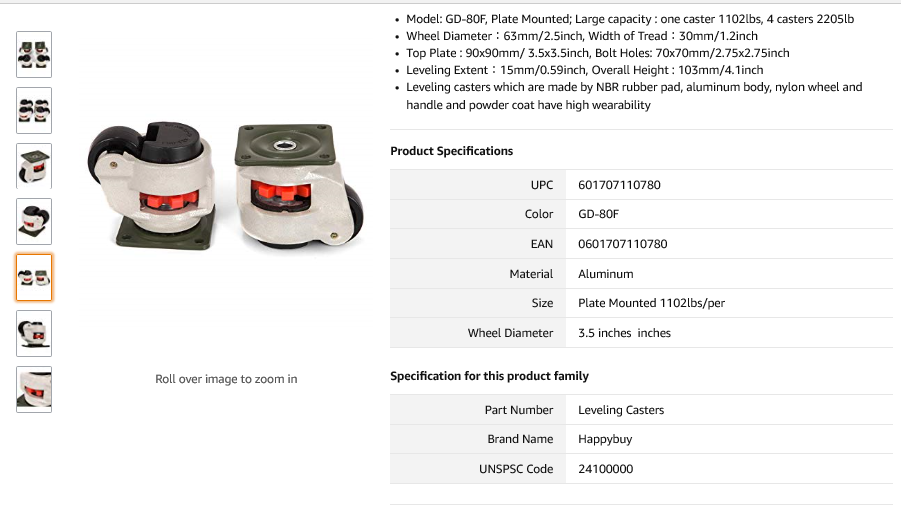

was thinking about leveling casters for the table and came across these on amazon. does anybody use this type of caster and if so how do they work out? i think the specs are off on four of them since the ones rated for 550 lbs are listed for 2200 lbs as a set of four.

Replied by thefabricator03 on topic just another plasma build
Never seen that type before. If you buy them make sure to let us know how they go.

i would think i would need at least 6 of them as something in the middle is probably going to be helpful. i'm not sure how many gallons of water a trey will hold for a 4' x 8 table? i can see some serious weight adding up there at 8 lbs per gallon
they come in 4 packs not much of a price difference between the those and the ones rated at half the weight either.

My table weights in at around 2300kg, And my tank hold about 1900 liters. When full the total weight it closer to 4200kg without including the weight of the steel its cutting.
But it is a big machine, 4000x2500 cutting area.
How deep is your water tray? Its easy enough to calculate the volume it holds. Are you going to have a tank? It really helps when you need to drain the pan to clean out the mess inside.
Just make sure your tank is over the volume specs for the pan. I made that mistake my on my first tanks assuming I could get 100% of the water out and into the pan.

just found a calculator and a 4 ft x 8 ft tray 3" deep is 80 gallons so about 640 lbs of water. That's lighter than i was thinking.

yeah i have a cheap option as i can pick up a used 200 gallon plastic tank for 50 or 75 dollars. i see them all the time in the classified adds. figured i would just get a utility pump to control water height and let gravity do it's thing to drain it out. simple but good enough for now.

Letting gravity empty the pan is what I do and it works well, I use all 2inch piping but I can empty my pan in about 10 minutes.
I have a diverter valve that I use when draining the pan to stop steel particles going through the pump, and its much faster to drain as well.

+1 on this. I use a 100gal stock tank under my table for water storage. The water table is filled using a cheap HF sump pump. Gravity drain. Simple and quick.

Not a single tank or pump, ever !
Fill it with tap water, evaporate during cut, fill some more, repeat till time to clean up, lift one side up, let it drain.
Not a good solution by any means, it is just what my clients do. EPA does not exist here.
