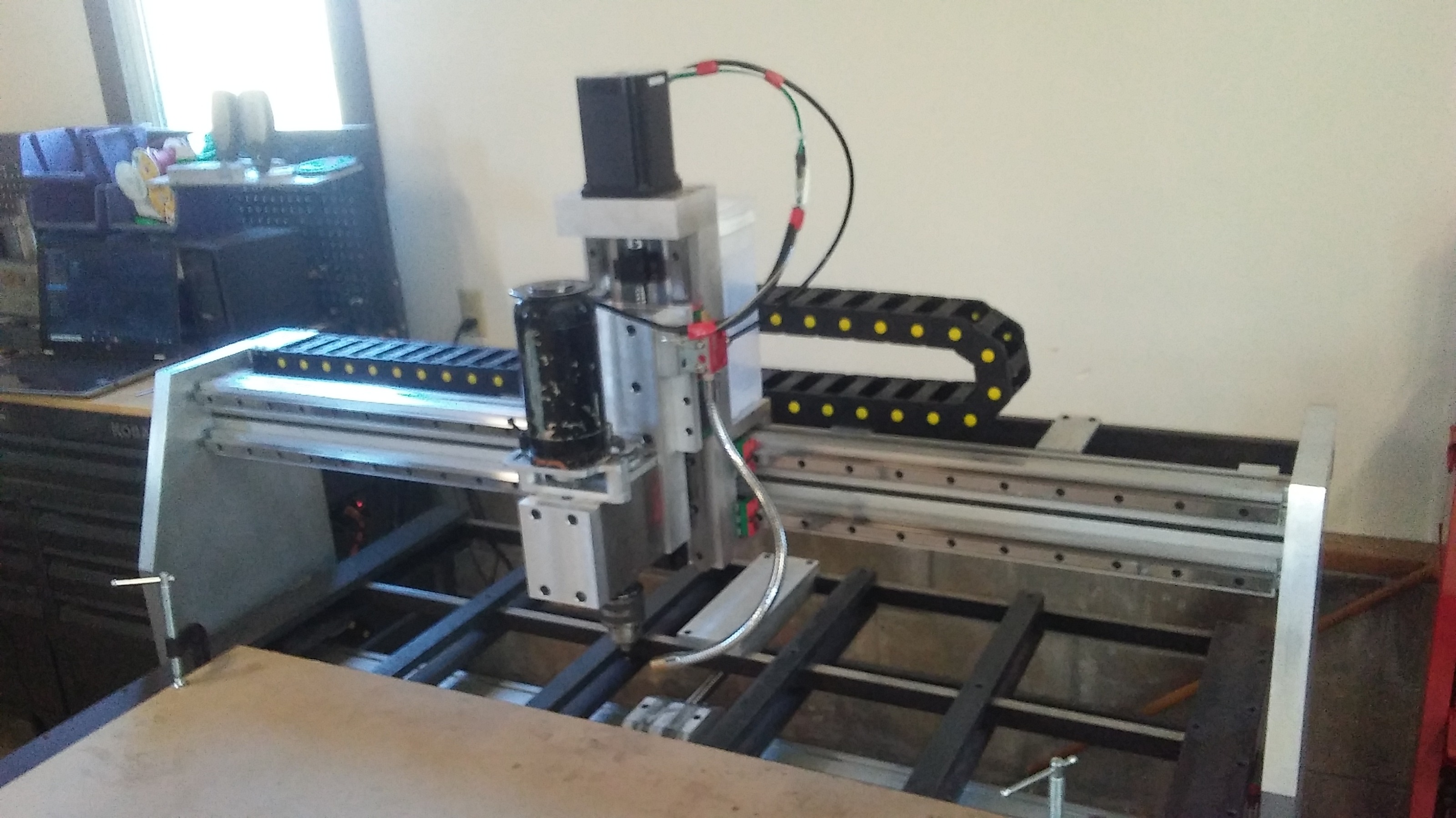

i think long hours is an under statement
labor of love it seems. i think the sense of accomplishment is what we get out of it.
that axis could go faster but until i do something on the ball screw for whip that's the happy spot for the screw the way it sits now. acceleration is good here. it will do .3 G but it will shake things accelerating that quick. .1 to .15 G seem good on the frame work. traverse is probably slightly over 300 IMP for now.

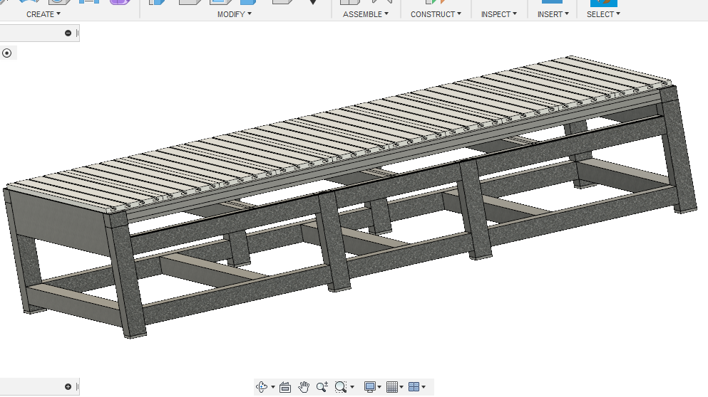

depends on what i plan on cutting, this is why i was working on drag chain. i could see cables getting pinched and getting messed up. i know PVC plastic sheet is going to be first. and then aluminium for a T slot table top. my frame is just a skeleton at this point. the whole thing will look something like this screen grab i modeled up so i can sort out my mold for E.G.

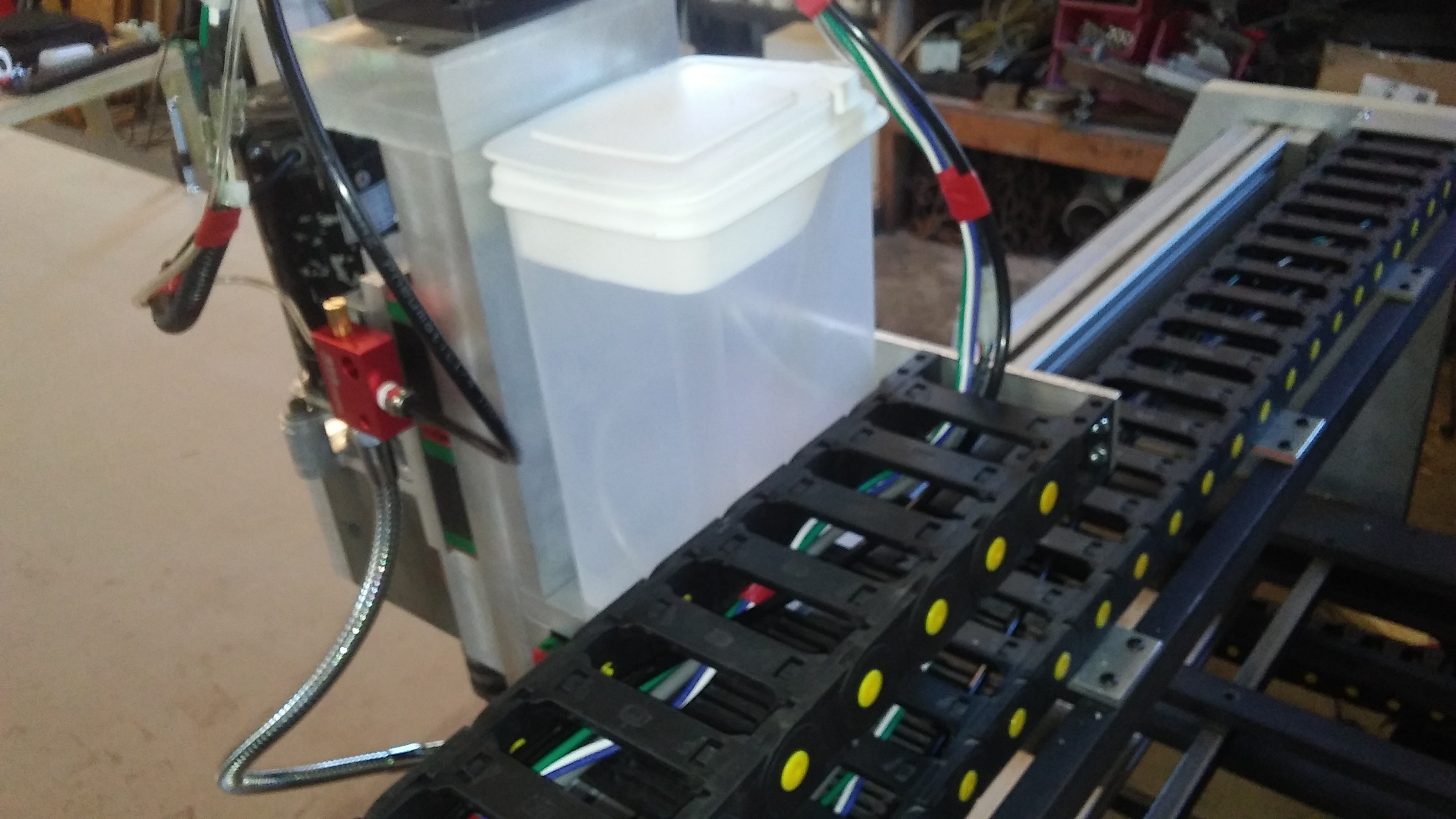

i did manage to get the drag chain mounted along the side and got power to the spindle and rigged up something temporary for now. i have to mess with the pulley on the spindle to get the belt alignment right. i just tossed it together quickly for fitting and mounting before. i think by the weekend i should be at least cutting some plastic. i will probably mount the mist coolant up before that though just to get it out of the way.

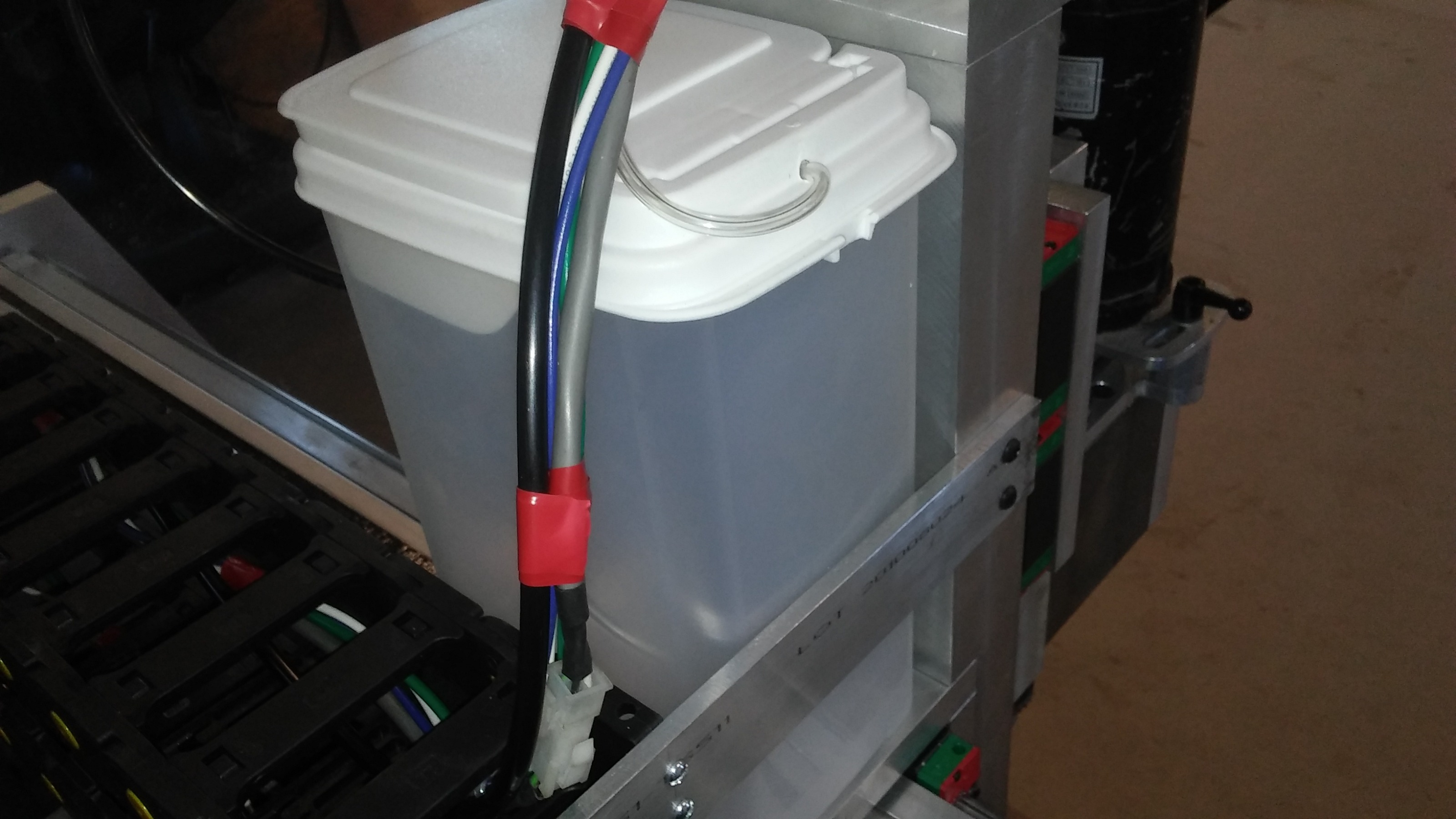

got the spindle pulley lined up with the belt and got my mister mounted but still have to come up with a way to hold the coolant tank in place. but the ledge on the back of the Z axis looked like a good spot for the tank to find it's home and hitch a ride
i have an air line routed through the drag chain and plan on making a manifold to transition from the plastic air line to a ball valve so i can turn the air on and off nothing fancy just manual controls
it's pretty sad when the highlight of your trip to the dollar store results in you finding a storage container with a lid that is just the right size for your CNC builds

my new timing pulley's came as well and the manual air control works nice. the machine cuts MDF and plastic but i need some more calibration it seems. sizes are off a little. i thought it might have been lost steps but i think it's in the calibration. square and parallel seem good with repeatability being good. so that's where my luck ran out
