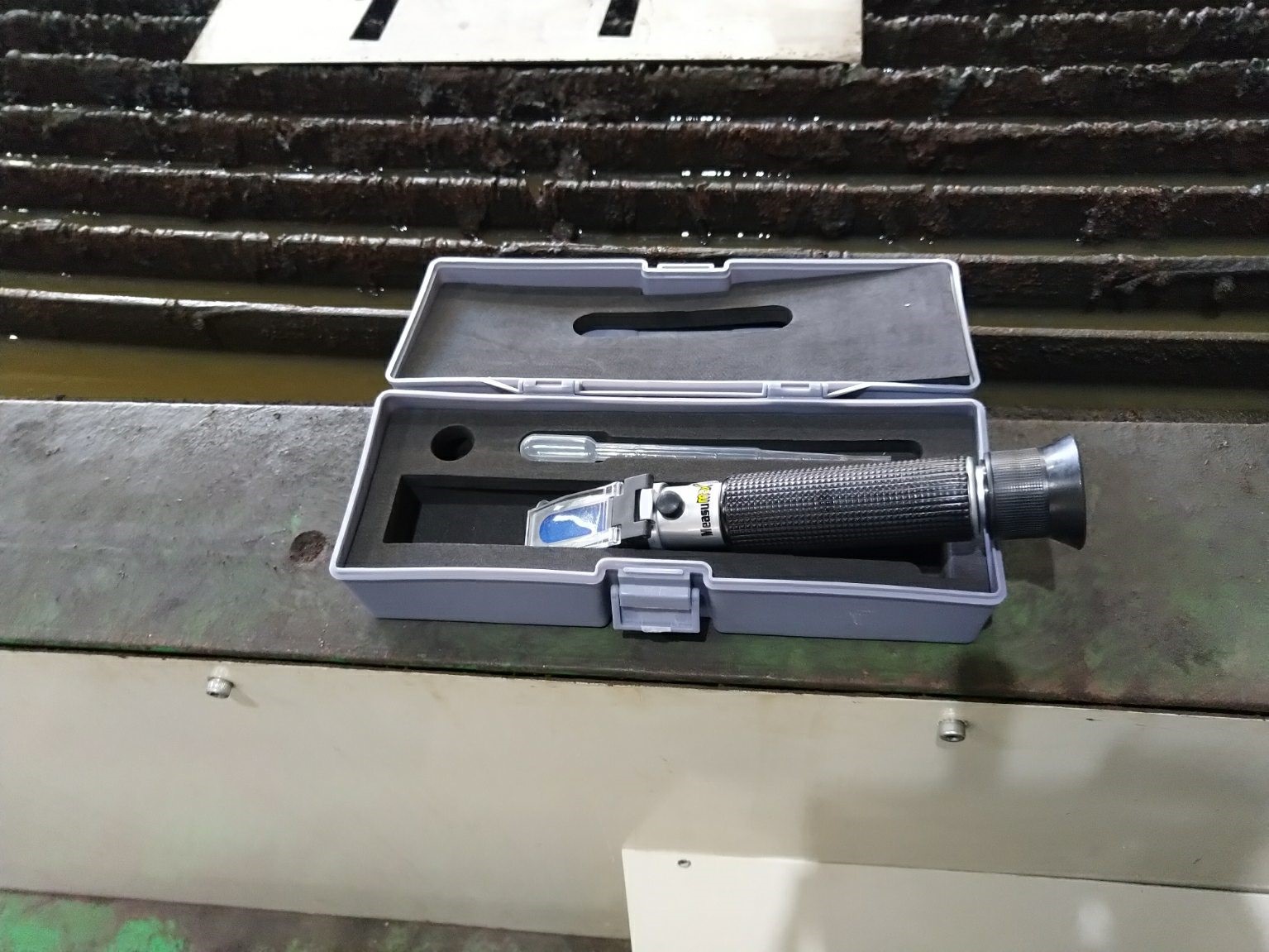

The machining is looking good,
I ordered one of these,
www.machineryhouse.com.au/Q670
They are only a cheapie but I will see how it goes.

would be good to know for sure how they work on a water table application.

So I tested out the refractometer,
It defiantly work for the solution I am using, showing a reading of just under 2 for my table fluid.
