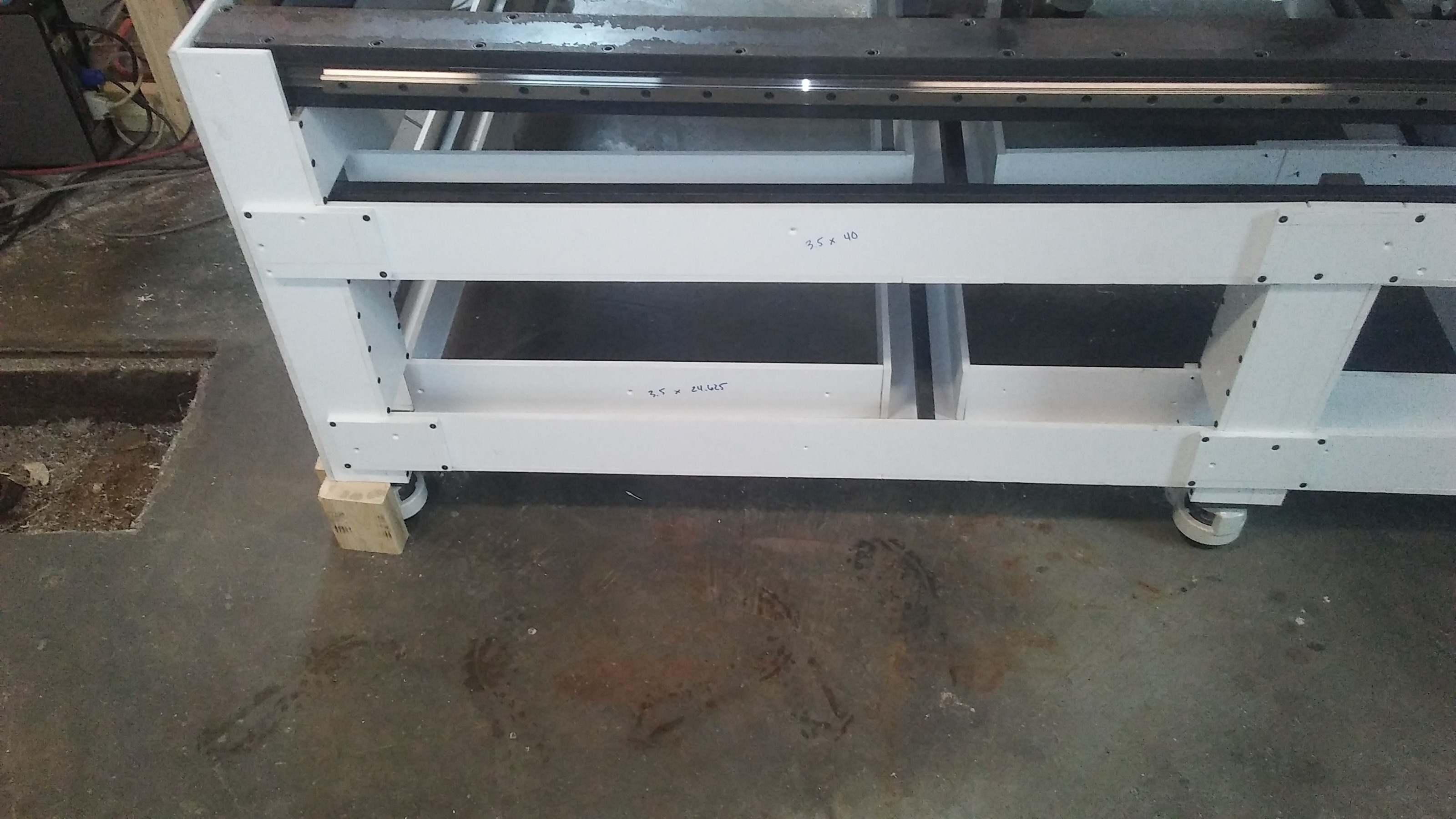

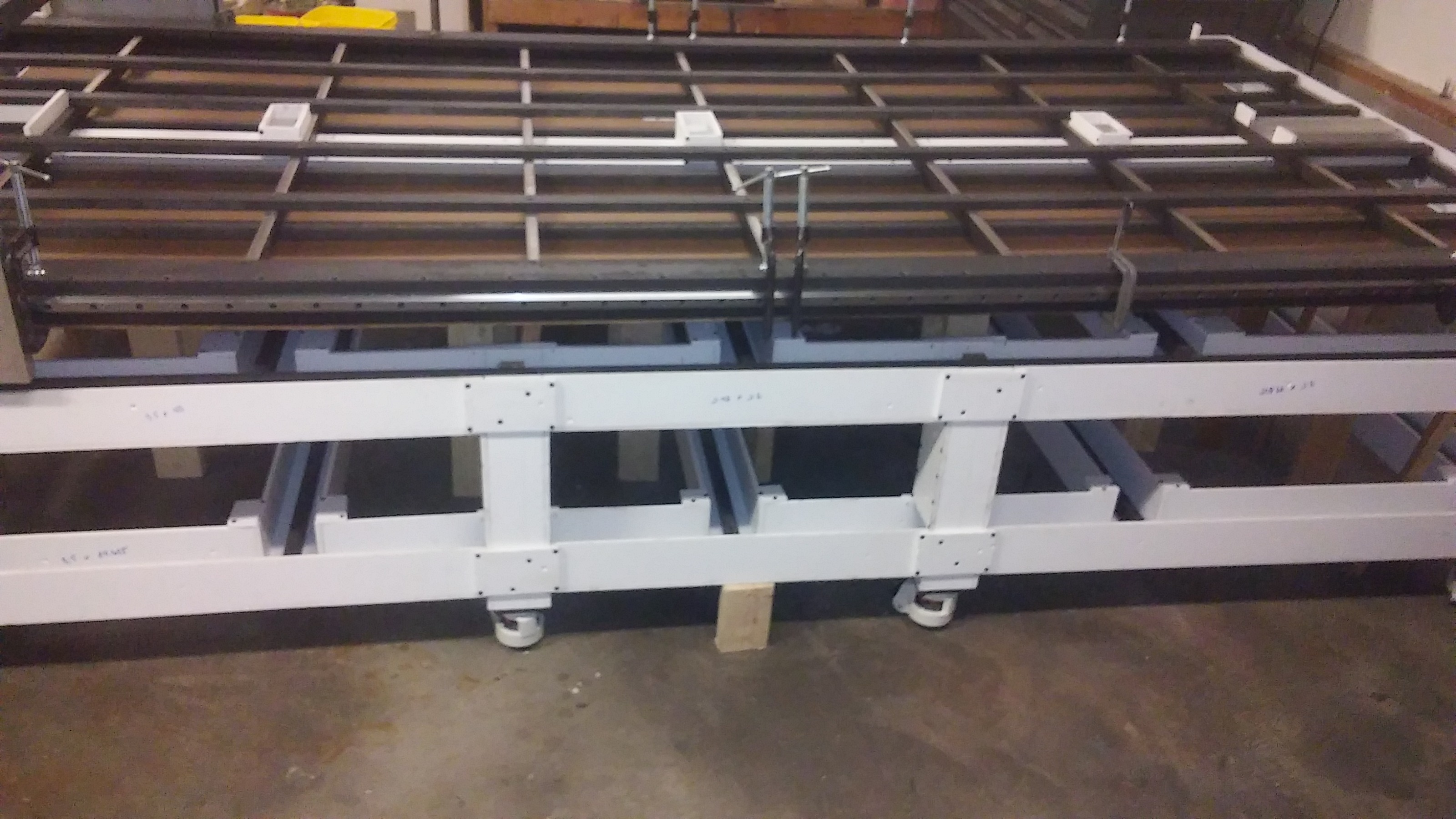

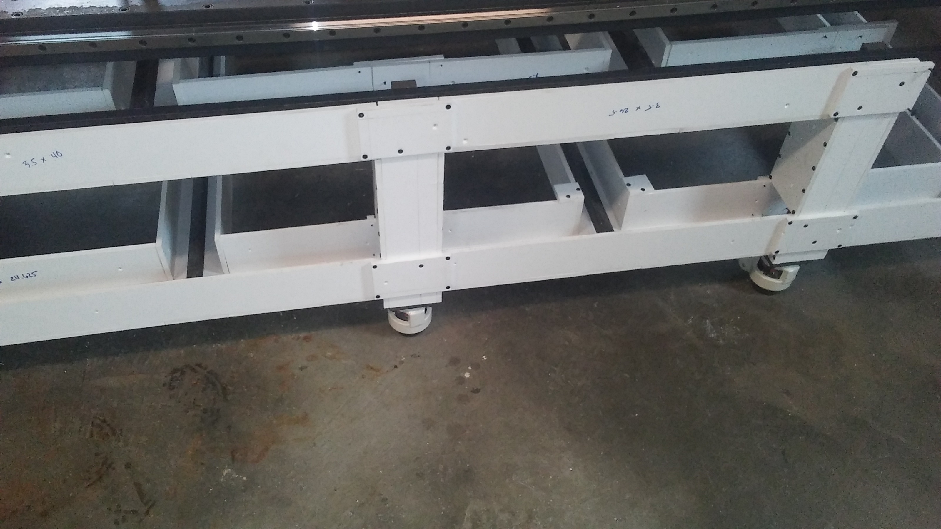

this molding of the frame in E.G. has been a lot of work. i thought i had just about everything cut out but when i started putting things together i quickly found out i was missing some pieces
way to many pieces to keep track of
and it went together in CAD a lot easier than in reality. if i had some extra hand around to help it would have been a lot easier
hopefully i can pick away here and there this week coming and get things ready to cast over next weekend?

should make for a nice machine base and sub table. in the beginning i thought i could tear the table down if i had to move the machine but that plan went out the window i while ago
once i seen the frame work on the top i was like E.G. would work so well there the way things turned out because of how it's a bunch of interlocking cells. then as some time went by i figured if i could figure out a way to tie the table top to the frame that would be even better so this is where i landed
hopefully it's not flat on my face

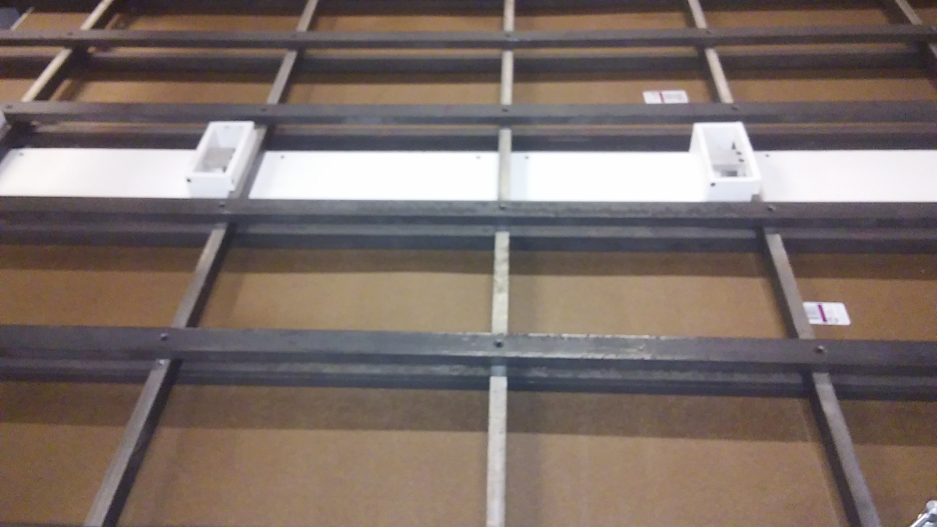

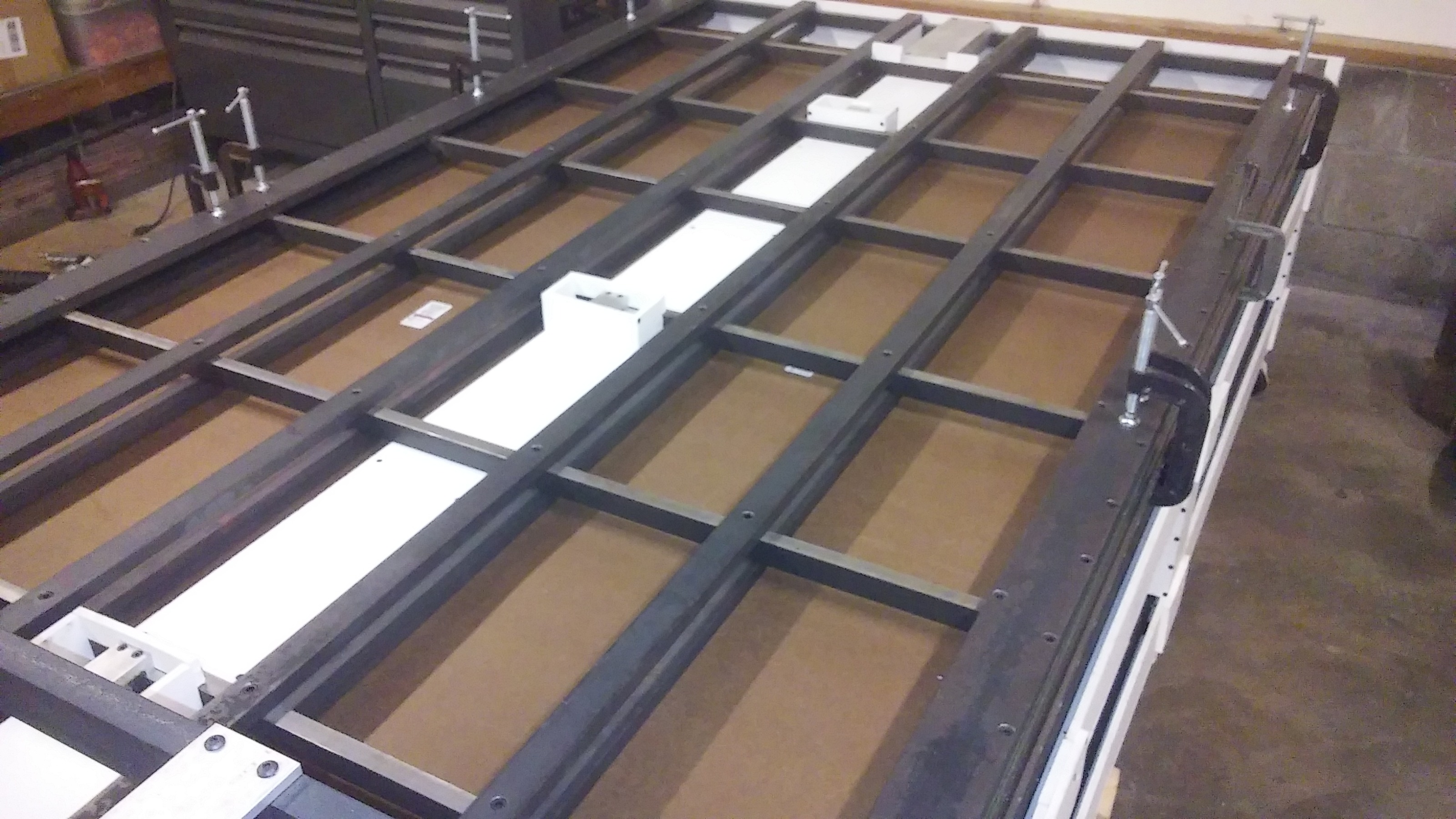

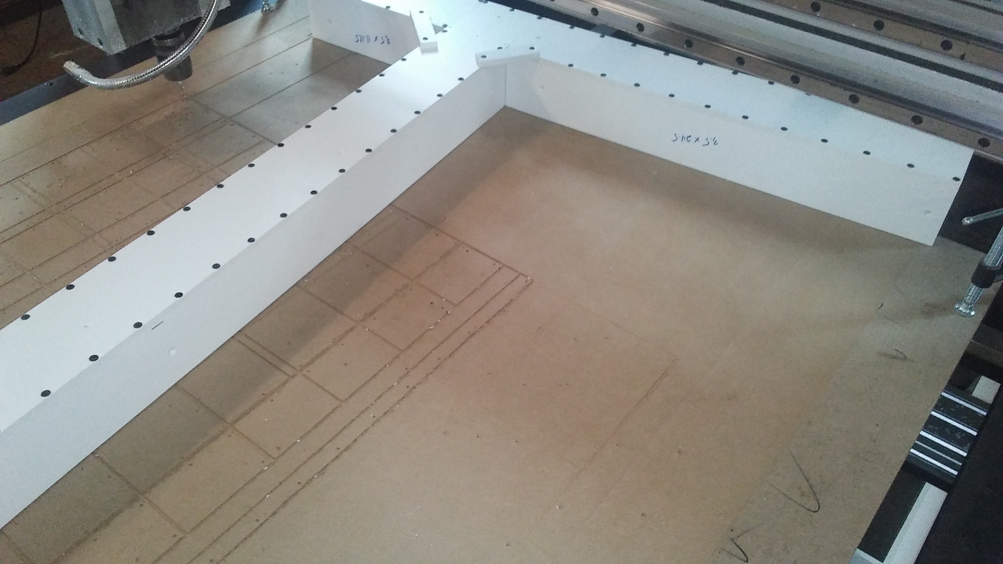

03 May 2020 02:07 #166457
by machinedude
Replied by machinedude on topic just another plasma build and then some :)
I think i have A.D.D.
i was thinking i would be casting by now but just finished the mold and it's to late to get into anything now. T.he Table top ended up getting more involved then i expected and took me all day to get sorted out. i was working til 2:00 am last night but did not get anywhere because i was to busy going over everything 2 and 3 times.
now that it's in front of me this thing is going to take a while to cast. the amount of mixing and working into the mold i am not looking forward too
working the air out of the mix is probably not going to be much better
for the most part i kept things open around the ball screw just so it would not be a nightmare to work on down the road if something should happen. had to create some clearance down the center 3/4 deep for mechanical stuff to clear. i used a hard board for most of the table trying to save some money the plastic is about $80 a sheet compared to $9 a sheet for the hard board. the hard board will need some mold release to be safe but the plastic probably won't the the extra help for releasing from the from the frame.
