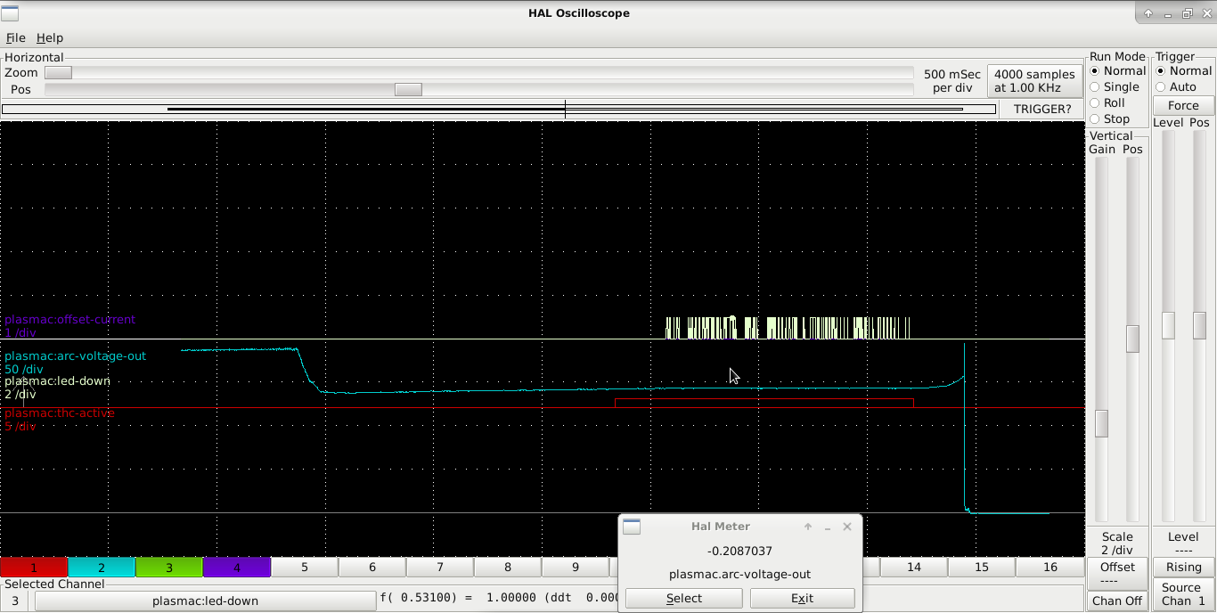

And PM1000 J15 goes to THCAD +IN, PM1000 J16 goes to THCAD -IN?
THCAD is jumpered UNIPOLAR and F/32?

Replied by phillc54 on topic My Newb Plasma Table Attempted Build
Try changing Arc Voltage Scale to 0.008356

Yes on the J15/J16 correct wiring. Just physically checked that from the input side of the THCAD-10 to the aviation connector to the plasma, it's correct.
And yes it's UNIPOLAR and F/32.

It's now at +,008356. I presume we're doing another cut(s)?

Yeah, just try a cut/s and see what happens

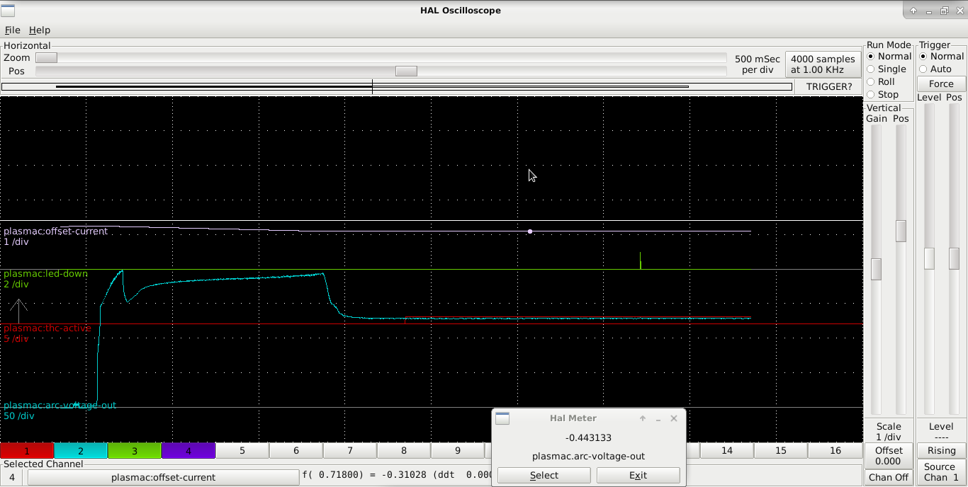

21 May 2020 02:04 #168452
by dvn4life1972
I was having a lot of tech issues with those finecut consumables, hence the delay. Long story short, I'm back with the 60A consumables running at 60A. This cut was on 10ga (again), at hypertherm's recommended settings (211ipm, .062 torch height). Maybe I need a longer one? Gonna run some more.
Replied by dvn4life1972 on topic My Newb Plasma Table Attempted Build
- dvn4life1972
- Posts: 401
- Thank you received: 173

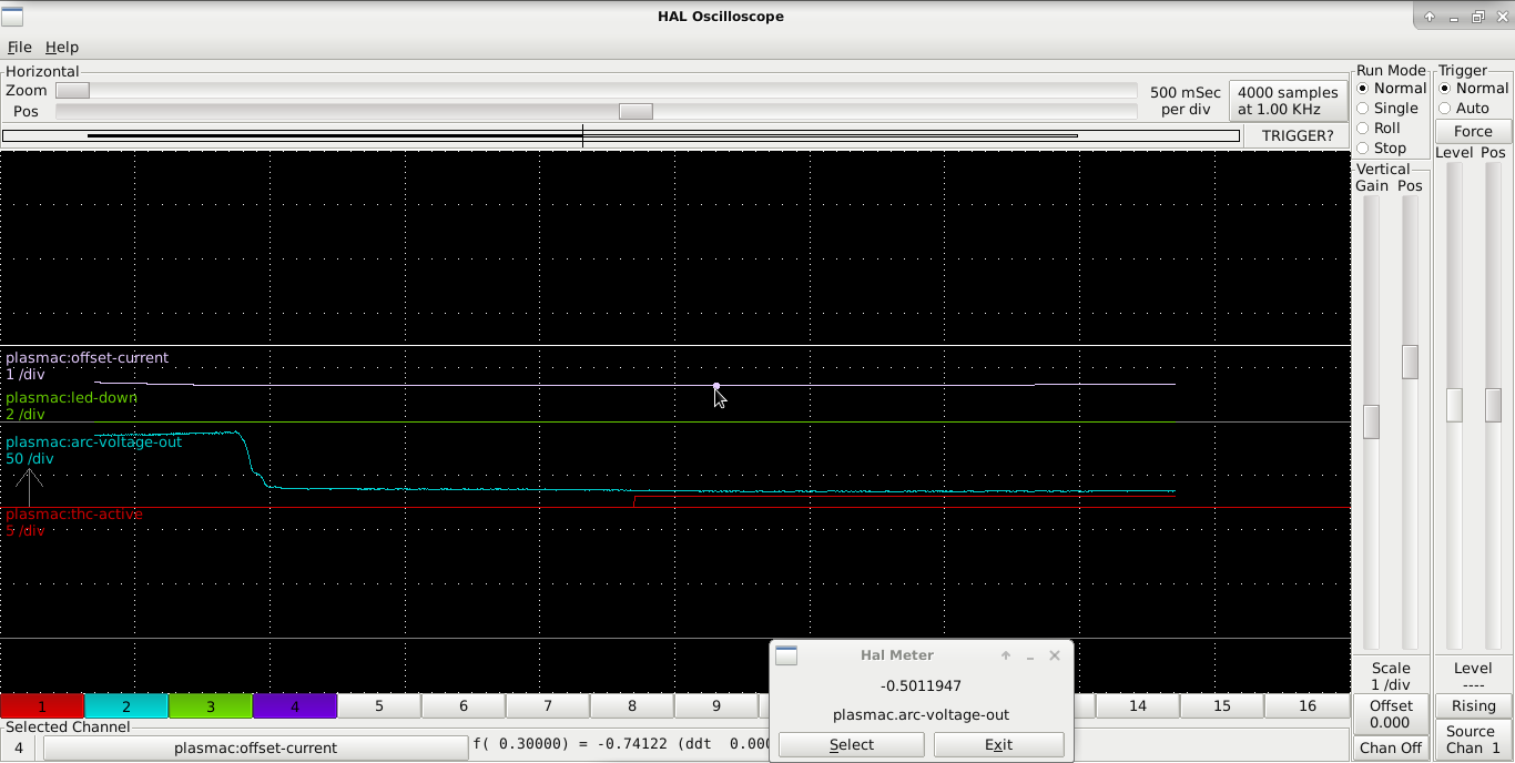

21 May 2020 02:08 #168453
by dvn4life1972
This one I increased the distance to 15in. I saw the Z move just a bit, like it was making very small precise adjustments (as expected). Gonna try the mountain range part of the material next.
- dvn4life1972
- Posts: 401
21 May 2020 02:12 #168454
by dvn4life1972
- phillc54
- Posts: 5711
- Thank you received: 2100
21 May 2020 02:16 #168455
by phillc54
What you could do is swap out the plasmac.offset-current for plasmac.arc-ok-out in halscope then you could see what delay you could get away with.
