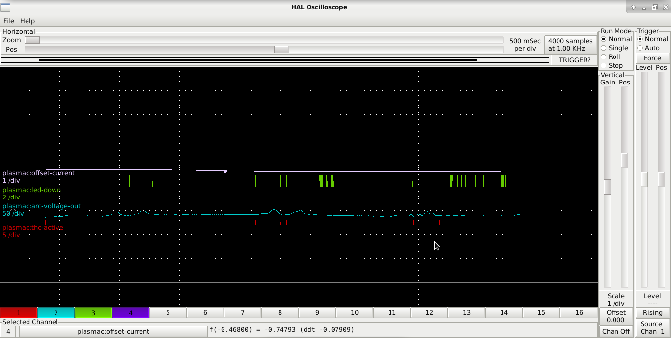

I'll have to do that tomorrow. My wife just came out here (it's late here) and she was pissed because we haven't eaten yet. Anyway, I just ran a part that has given me trouble every time with the THC and it ran perfectly. On the warped portions of the plate at that. I watched it move in small increments and it did nothing crazy. I think that (-) on the scaling was it...that was placed there back when I was diagnosing the THCAD issue with PCW, and I never remembered to remove it after the issue was fixed. I'm at least guessing that's what it was. I'm going to cut some thinner material tomorrow and put it through it's paces and see.
Thanks for sticking with me, everyone.
Here's the scope for that part btw.

I am embarrassed that I didn't see that earlier. I looked at your configs a gazillion times and there is even a pic of it on an earlier post.
Hopefully you will be sorted with a bit of tuning. The bright side is that you learned how to use halscope.

Yes that is a good thing, and you still noticed the neg scaling. I can guarantee you I would've never ever caught that!

Actually if I had half a brain I would calculate arc voltage as an absolute value then this issue shouldn't arise plus it would stop the flickering between 0v and -0v that is annoying.
