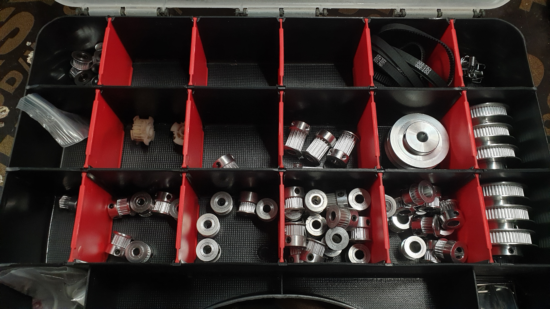

30 May 2020 01:54 #169377
by dvn4life1972
These arrived yesterday. Drilling them out the extra .35mm didn't work so well, as the are two-piece. I had ordered properly sized pulleys but they were moving a lot slower in the supply chain so I thought why not try this for $10. Oh well, now I know.
Replied by dvn4life1972 on topic My Newb Plasma Table Attempted Build
I ordered a pack of 10 16-tooth GT2 pulleys today. They're 6mm bore, and I have 1/4" shafts so I'm planning to open the bore up that extra little bit. 10 for $9.99, why not?
- Posts: 12156
- Thank you received: 4149
30 May 2020 03:49 #169383
Join the club of spare pulley owners! I have one too for the same reason
Replied by rodw on topic My Newb Plasma Table Attempted Build
The following user(s) said Thank You: dvn4life1972
- dvn4life1972
- Posts: 401
- Thank you received: 173
30 May 2020 03:58 #169384
by dvn4life1972
It was a 10-pack. Was yours a 10-pack? Eh?
- Posts: 12156
30 May 2020 04:07 #169385
You win! my poor pulley is outnumbered 10:1
- Posts: 21959
- Thank you received: 7478
30 May 2020 09:48 #169401
I have drilled some of them, only 2 were usable, but far from OK.
Now i keep a full box of them that is getting empty, again !
Replied by tommylight on topic My Newb Plasma Table Attempted Build
+1
