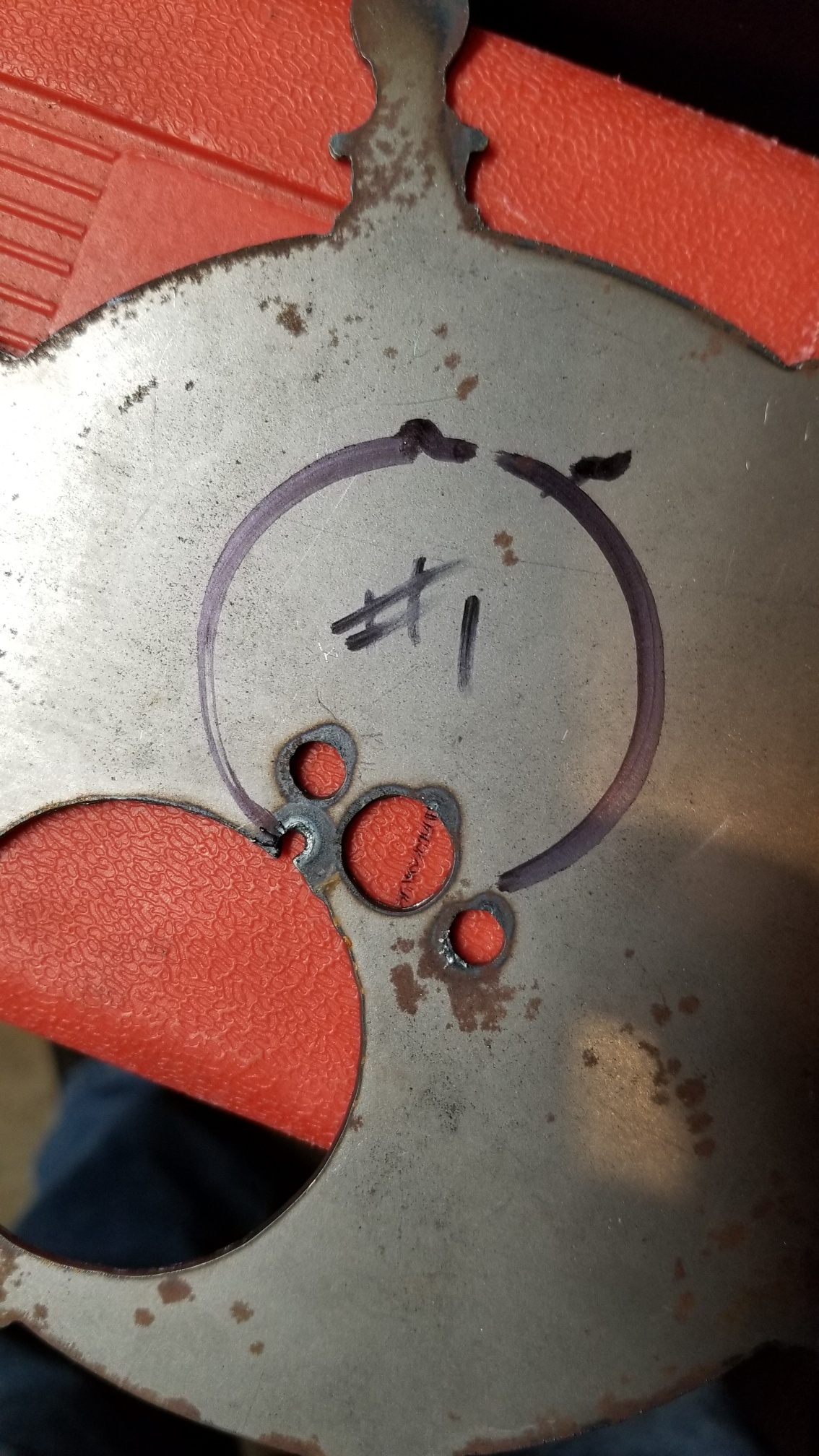

The circle from Toms code you posted
here
doesn't look circular to me. It is shown with the start point at the top when it is actually at the right side and it then seems that it is a bit short in the Y axis. Can you measure it to see.

It's just the cell phone camera. The edge was a little beveled and that's making it look that way.

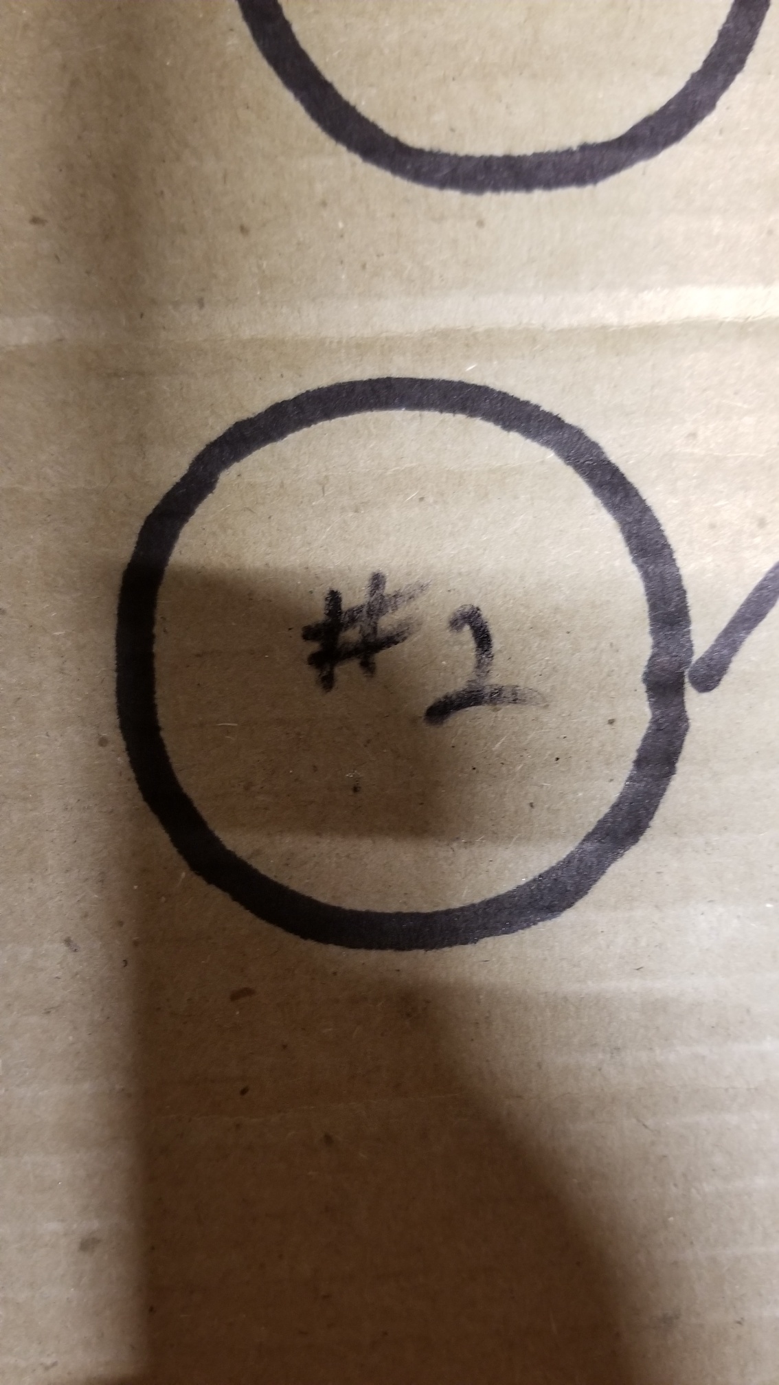

Try these two circles, both 2" dia. You may need to change the feed rate as they are 10ipm, the same as Toms.
You can probably use you marker pen if you don't want to cut as it seems to show the same issues.

Ran them both. They appear to be ok...forgive the stray marker outside of the main path, I kind of have to apply a little pressure to the marker after probing to get it to write.
