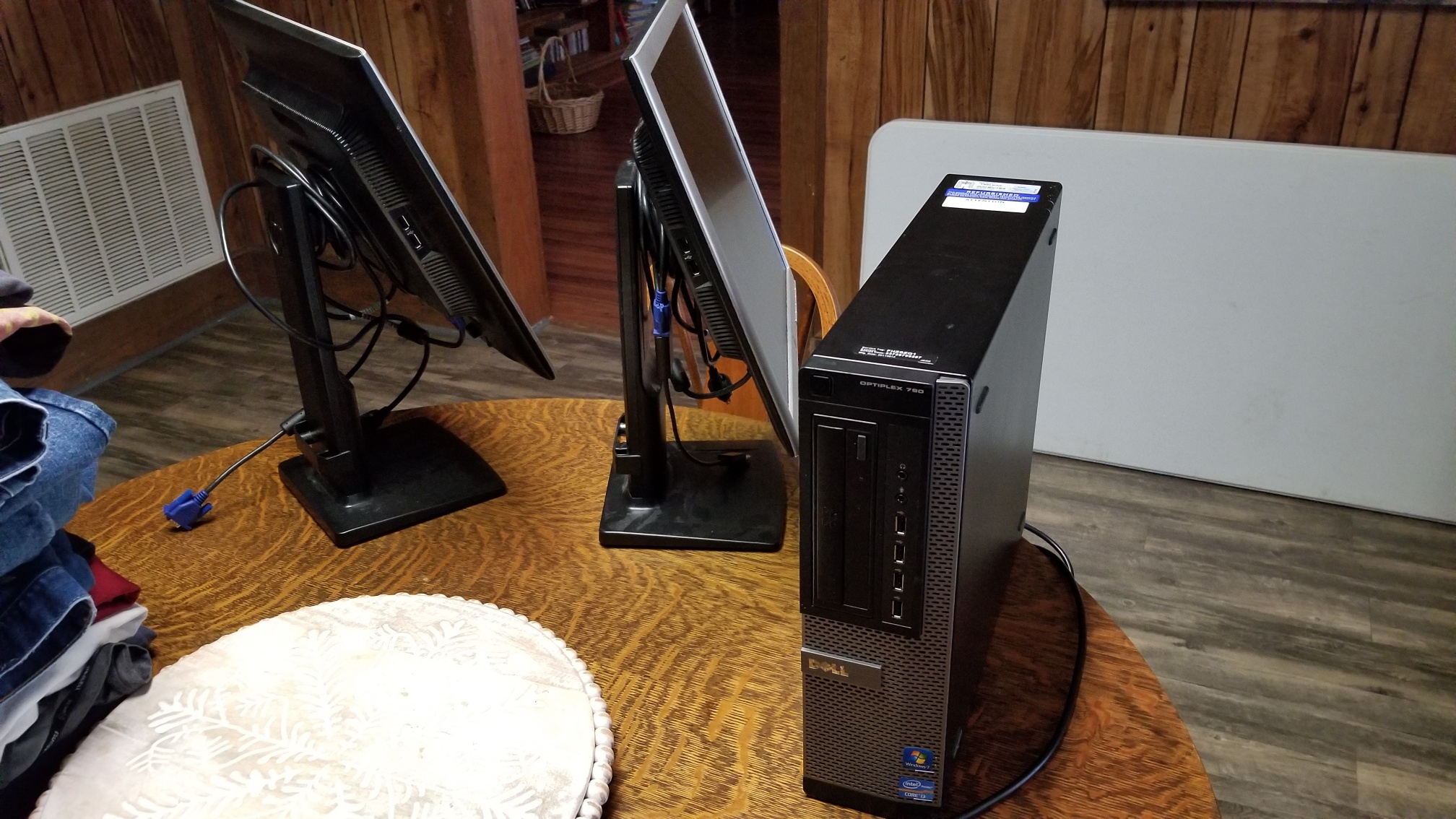

06 Jun 2020 22:13 #170416
by dvn4life1972
Slowing down feed is a good idea. I'll try that.
I did finally get the PC and a couple of monitors for $75. I don't need 2 monitors, but it was an all-or-nothing deal and it doesn't hurt to have a backup.
Going to get the software installed and all that fun stuff and try something tomorrow. It's over 100F right now so I don't feel like roasting in the shop.
