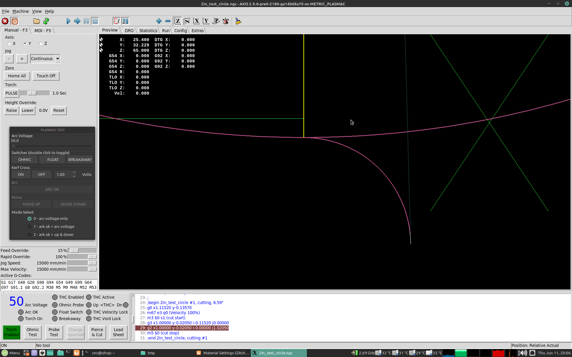

Post the gcode for that circle, lets have a look at what is there that can cause that.

Sheetcam 2" circle file attached. BTW, I did cut another square using the wizard without the lead-in/out and that made no difference...same issue.

Sorry to long time:
What kind of motors? Anything "intelligent" with a deadband?
Any kind of backslash compensation?
This locks like there is somehow added a small offset to the first move. By either lcnc or by a contoller that had stopped with a deadband before.
Strange
Strange

I'm absolutely new to all of this, so I'm not completely understanding what you mean by deadband. I agree that there is something programmed in the software that is not quite right and being triggered by one of the preamble M codes (like an offset of some kind). That's just my beginner's observation.

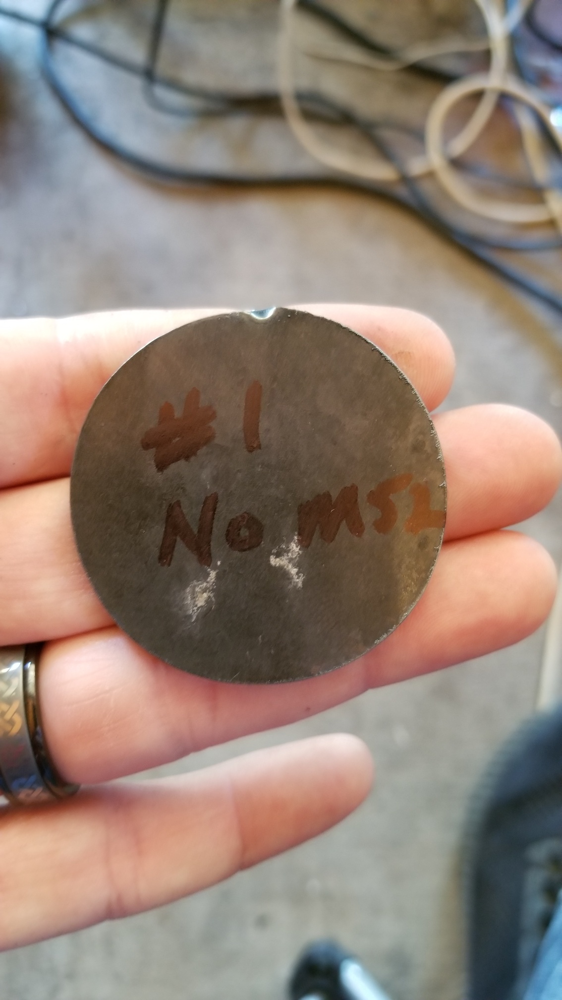

Tried #1 in pic with M52 P1 removed. Then removed lead-in and had the same result.
Replied by dvn4life1972 on topic My Newb Plasma Table Attempted Build
Your gcode, no issues.
You can remove the
M52 P1
line and test again, and remove the lead in and test without it.
One of those will do the trick, hopefully.

I'm not plasma. When i loock on your "punch" into the metal i had a silly idea.
If i understand correct you start by switching on air. In my eyes this must give some force on z axis witch will bend and move the torch. Probably 90 degrees away from the beam.
Maybe you can test something like that by just switching air on.
Mike

11 Jun 2020 19:23 - 11 Jun 2020 19:23 #171169
Replied by rodw on topic My Newb Plasma Table Attempted Build
Its not really surprising that using adaptive feed and slowing down travel on holes (or circles) results in different dimensions., By slowing the feedrate down, the kerf will become wider (as there is more time to burn material away)
Also even without M52, on short segments, the planned velocity is likely constrained so your commanded feedrate is never achieved so you end up with a triangular acceleration profile.
What is the feedrate and what is your max acceleration setting?
So what you should do from here is to use halscope and plot motion.current.vel and compare the commanded velocity against the actual feedrate.
Please remember that plasma is a blunt axe, not a precision machining instrument.

The torch holder is very solidly attached to the Z axis. There is no play, I can actually lift up on the torch while it's attached and shift the table. It had some slop in it before which I took care of.
