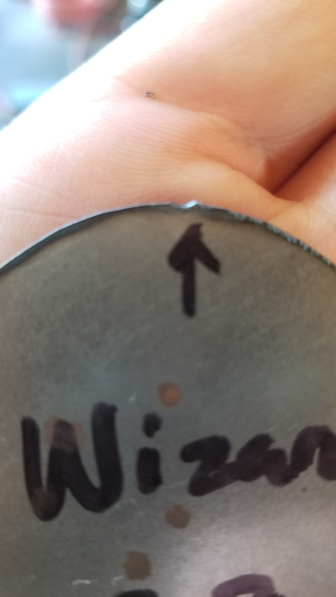

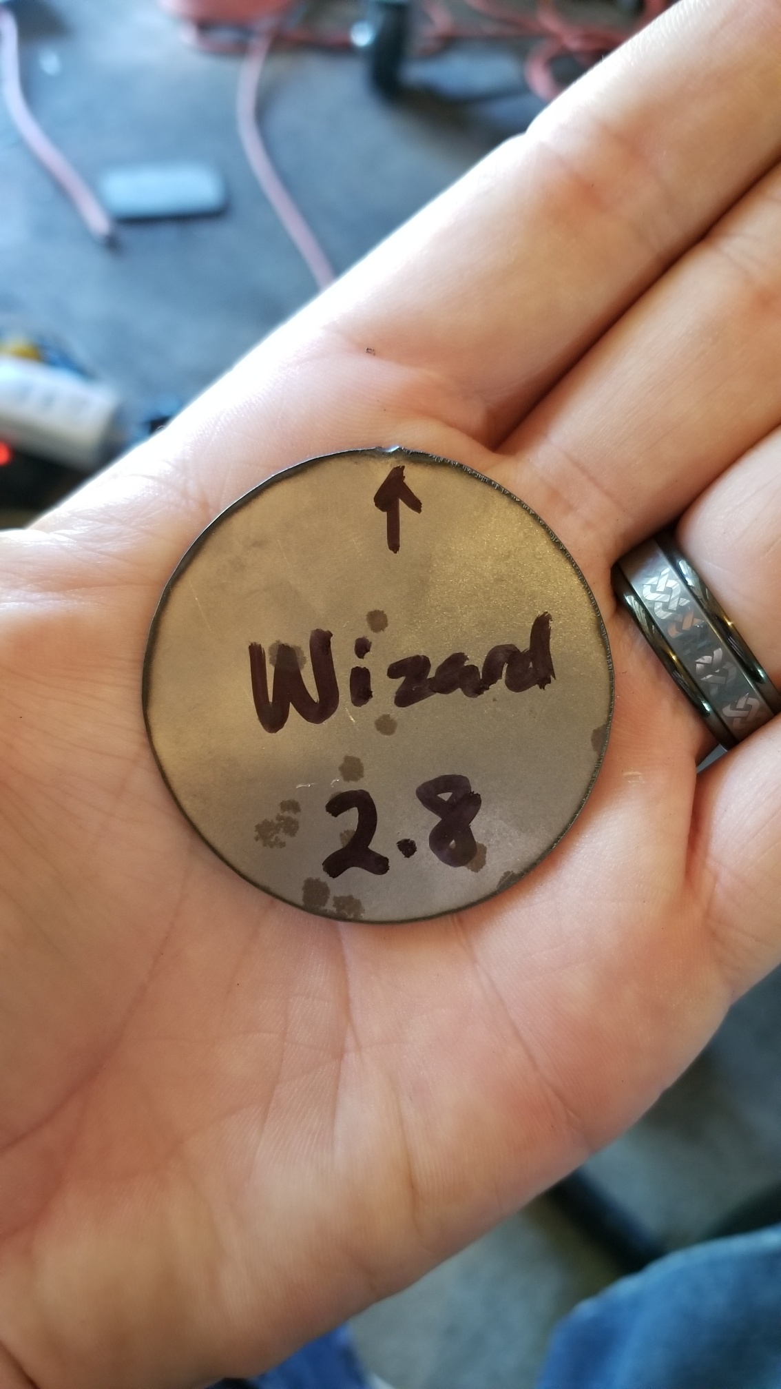

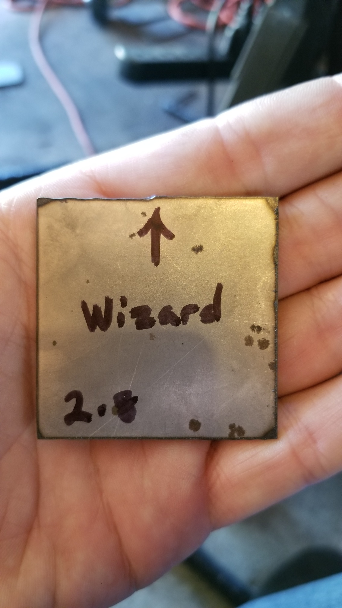

11 Jun 2020 21:08 #171183
by dvn4life1972
I've changed it to 2.8, that actually was not bad at all. The spider gave me a damn minor heart attack. Anyway, peculiar results...
I made the swap that PCW requested, then tested and found no changes (with a square).
After I reverted that, I used the wizard to make a 2" circle and cut it out (under 2.8) and it seems to be just fine. I again used the wizard, to make a square this time, and the error appeared.
Replied by dvn4life1972 on topic My Newb Plasma Table Attempted Build
OK, master branch included changes to the trajectory planner to include state tags. I think you should roll back to V2.8 in case something was broken by the changes to master branch. It should not affect your config in any way.
If that resolves the issue, then we need to file a bug report.
