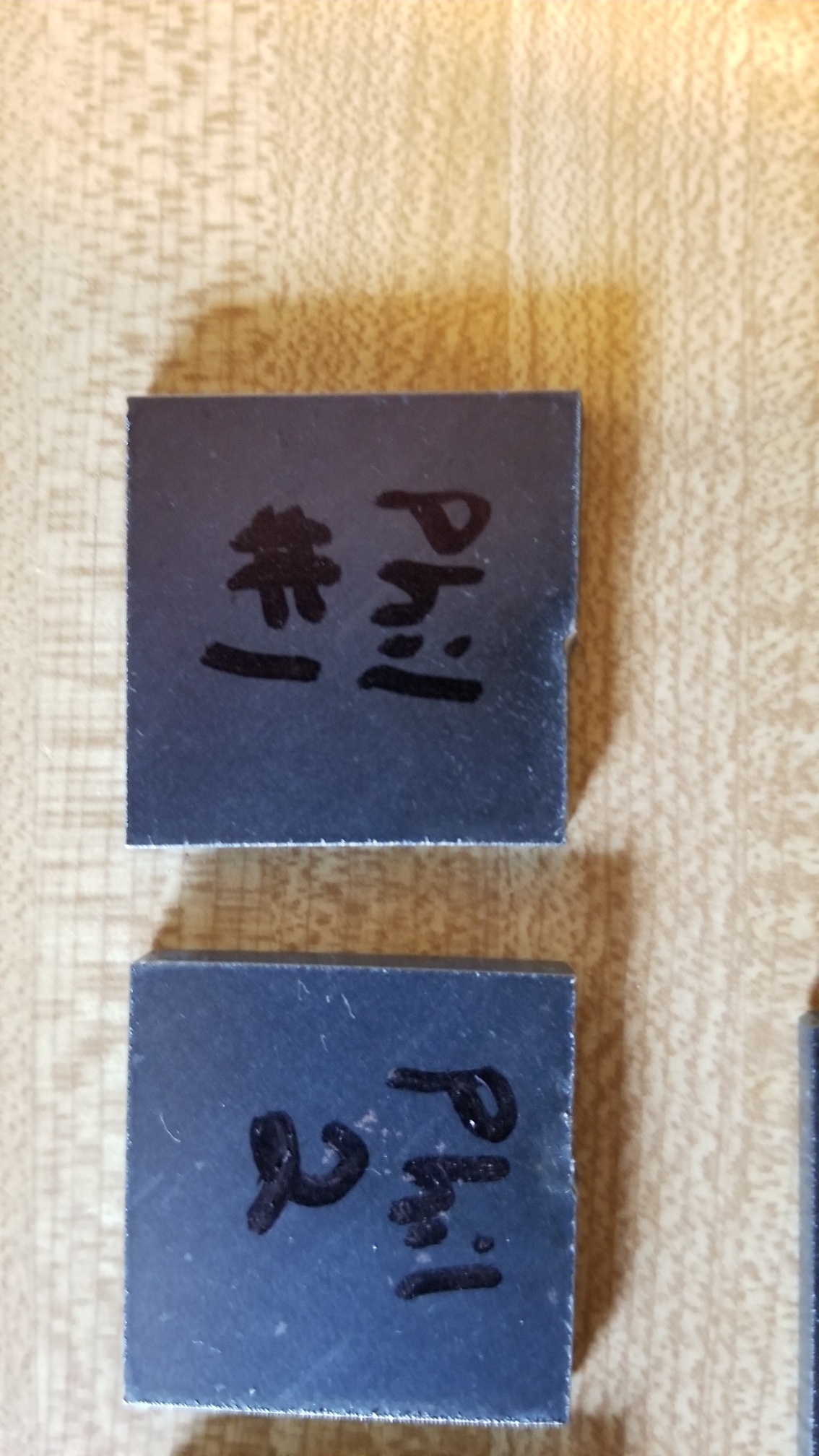

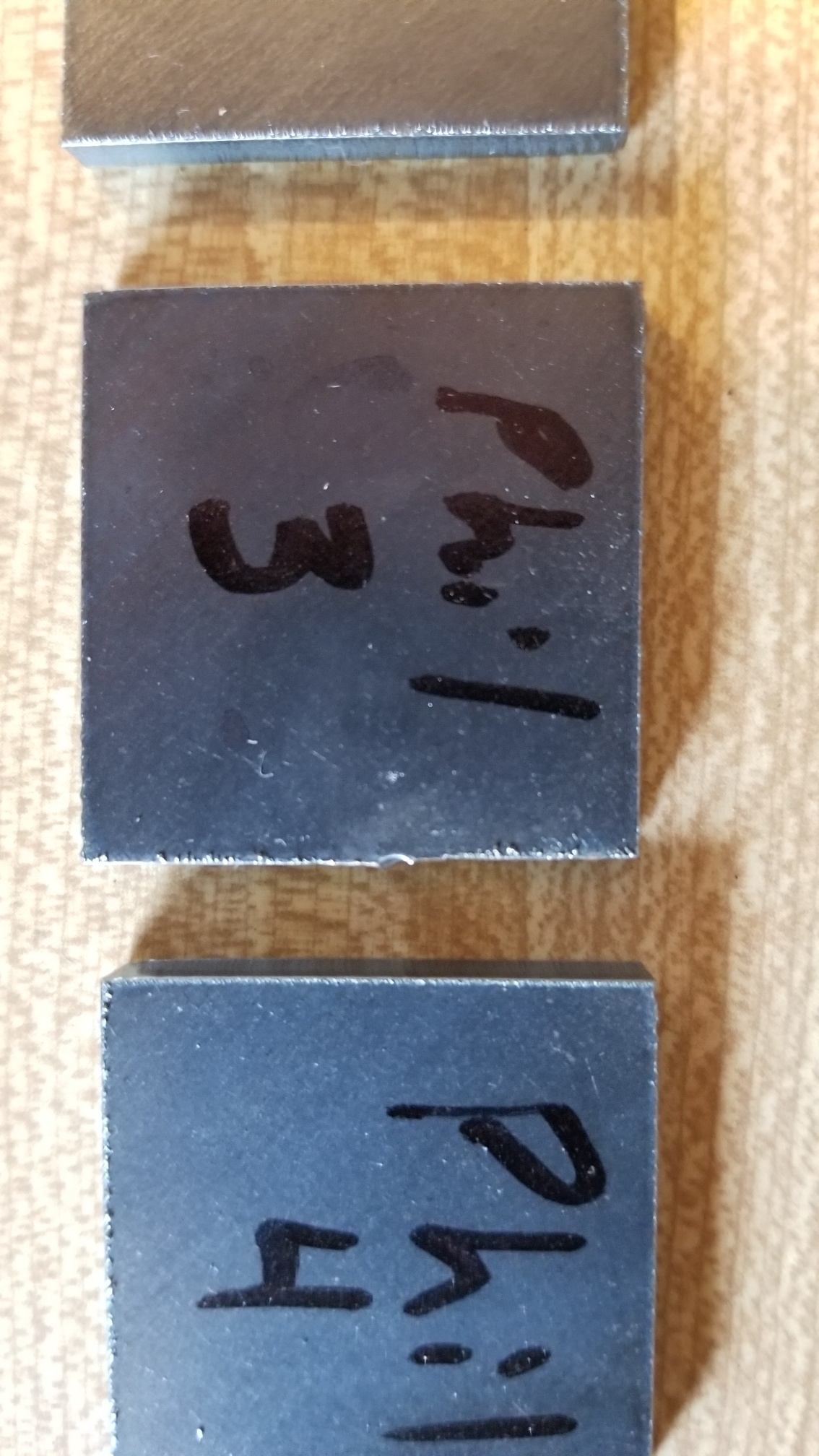

Here is a couple of 1.5" squares, the difference being cut direction. It would be interesting to see if they performed differently on a cut.
EDIT: I added a couple more that are rotated -90 degrees

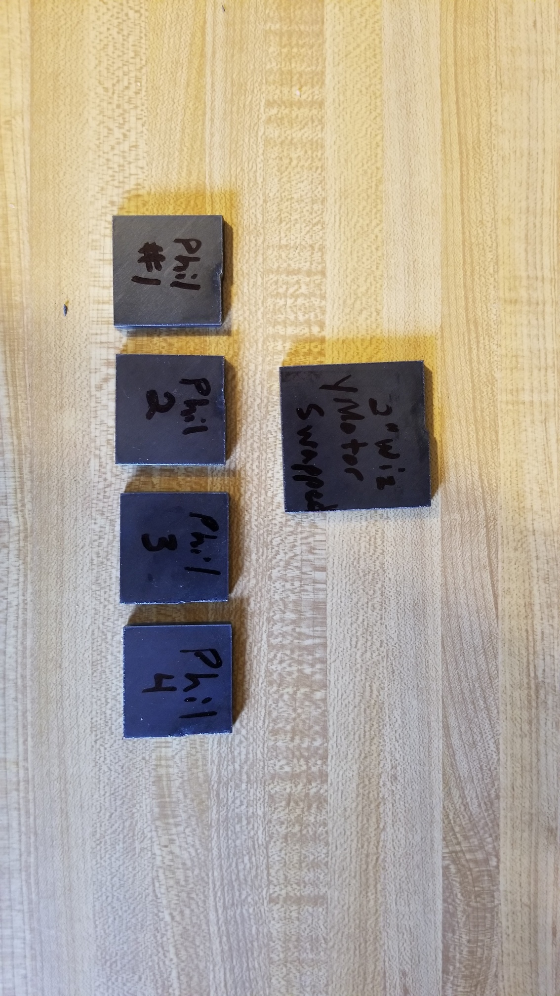

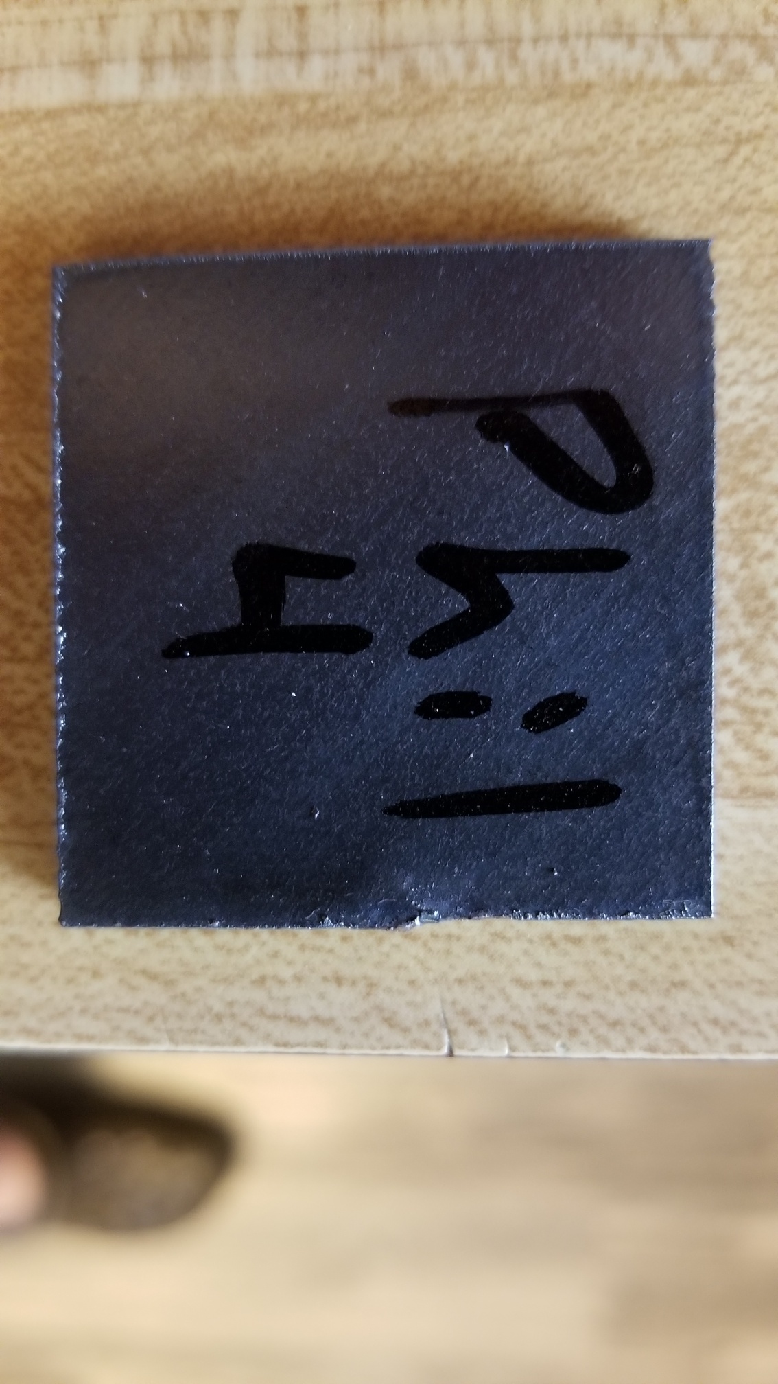

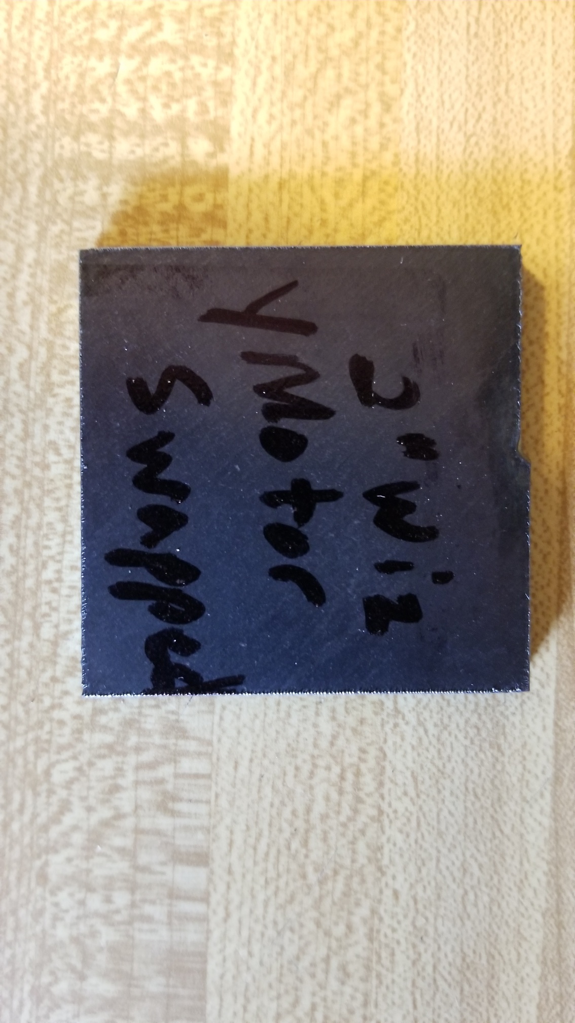

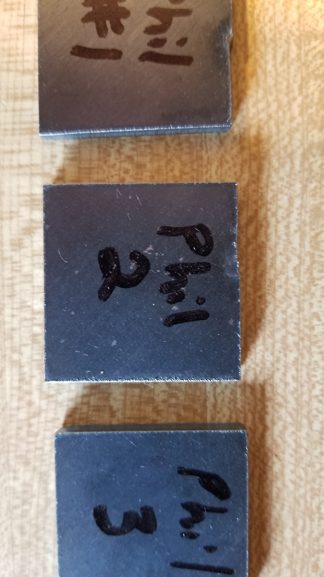

15 Jun 2020 17:06 - 15 Jun 2020 17:15 #171753
by dvn4life1972
Fixed the following error issue.
All of these are with the Y motors moved to their opposite sides. Ran a 2" square using the wizard, then all 4 of the files you asked me to. You may have to zoom a good bit, but it appears the error is on all of them.
Edit: looking at them very closely and measuring, the error is always on the last leg of the cut...and is reduced by half with a lead-in and no lead-out like the files you posted.
Replied by dvn4life1972 on topic My Newb Plasma Table Attempted Build
