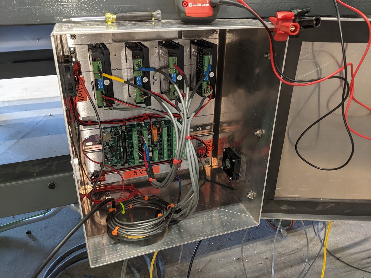

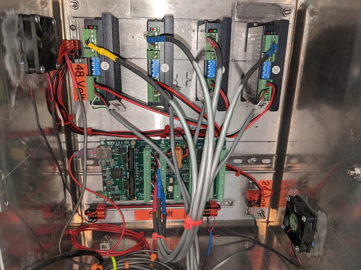

You dimensioned well the cabinet just the board and drivers, need to see if youll crowd with wires
The Aciera advice is one of the points to pay attention when design.
2. Avoid stacking heat producing components one above the other, and allow an unrestricted flow of air behind components whenever possible
Avoid this will help in your wire route too
7. Wiring can also affect enclosure temperature. Properly cabling wires and routing bundles along enclosure corners keeps wires from resting on components and helps minimize airflow restriction.
You have small drivers 80W and at idle 50W, DM542?
I dont think you even need the fans, the big hole for wire i think take off the fan purpose, fan tend to fail and if the design need it to run its something to consider, its okay to run with open door until fix the fan?
If you paint your box will help a lot to reduce heat too.

Many drives mention in their manuals that they must be de-rated if not mounted in their optimum orientation. (The addition of forced air cooling can also make a difference in ratings.)

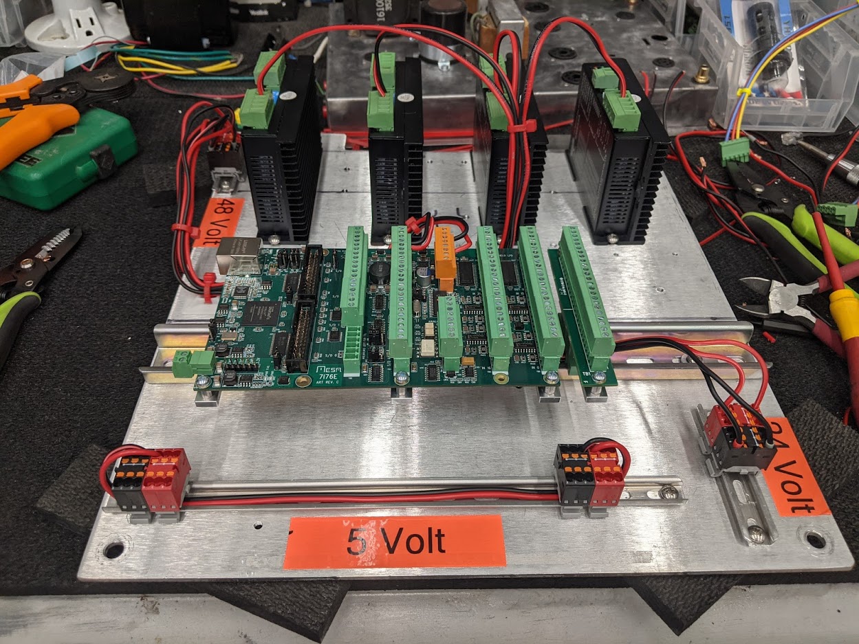

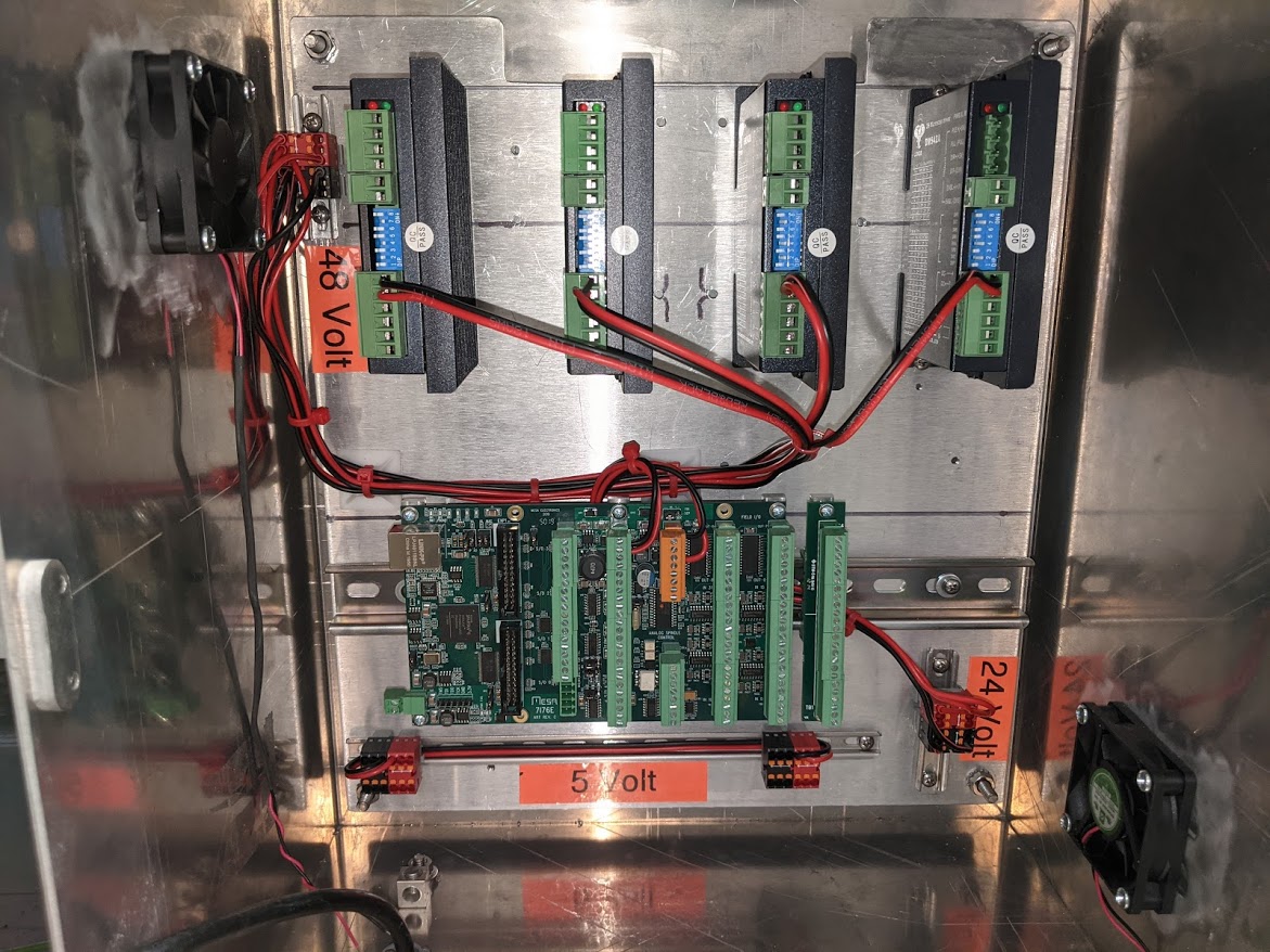

I decided to rearrange the driver boards now.

Thanks! I just got the motors moving! I need to land the home switches and do some calibration... then I will have to 'hit the books' on Plasmac.
I will clean up the wiring a bit more after I get everything working.

Motor wires seem very thin, that will limit the torque and speed by quite a margin.
4X0.75 is the absolute minimum for small Nema17 motors that i use, for anything bigger i use 4x2.5mm2.
