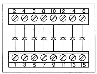

23 Dec 2020 01:28 #192908
by txtrone
On this type of series diode module, how would you connect the negative wire from the bus and the output from the Mesa card? Or does the output from the Mesa card attach to one side of the diode and continue thru to the solenoid? For instance, would the output from the Mesa card for solenoid #1 connect to terminal #1 on the diode block, then 'continue' out through terminal #2.... while the negative wire from the 2x bus connects direct to the solenoid?
Replied by txtrone on topic Downdraft design questions
The band on the diode points towards the mesa output. Pretty much any diode will do IN4004/IN4007

23 Dec 2020 14:38 - 23 Dec 2020 14:42 #192962
by txtrone
Last edit: 23 Dec 2020 14:42 by txtrone. Reason: I uploaded the wrong diagram the first time

23 Dec 2020 15:36 #192973
Replied by tommylight on topic Downdraft design questions
That should be it for the non D versions of Mesa.
Preferably wait for PCW to confirm that.

23 Dec 2020 16:15 - 23 Dec 2020 16:16 #192982
by txtrone
Will do. I am just trying to round up material before the holidays... so I can work on it all next week.
I still can't wrap my head around where the diode needs to go.
ETA: I see you explanation in another thread. Let me make a quick schematic and post it up for verification.
Last edit: 23 Dec 2020 16:16 by txtrone.

23 Dec 2020 16:18 #192983
I wanted to quote and say i did reply to that, by the time i got my eyes on the screen i see the edit there!

23 Dec 2020 16:26 - 23 Dec 2020 16:29 #192985
Replied by Aciera on topic Downdraft design questions
The diode needs to go from the positive side of your solenoid inductor to the negative of your solenoid conductor with the "ring" pointing to the positive side.
The reason for this is that the moment you switch your solenoid off the magnetic field that was opening your pneumatic valve collapses and that changing magnetic field will induce a fairly large voltage in the solenoid inductor that can damage the drivers on the board. This induced voltage is inverted in polarity compared to the voltage you supply the inductor with so it will find a short circuit through the diode while your supply voltage will find the diode not conductive.
en.wikipedia.org/wiki/Flyback_diode
