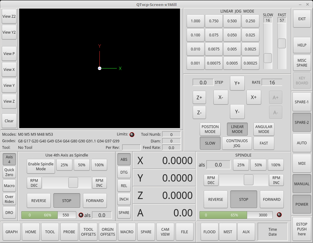

What does position,angular and linear modes change?
They really do not change anything but instead provide a way to access arrays of buttons that can be set up to handle common movement tasks and each having its own jog rate speed controls. To allow for these three small panels were designed into the 1xMill gui to handle these features.
The three panels are the upper sub panels of the main jogging panel and called up by the Position, Linear and Angular buttons:
Position:
Buttons and slow/fast rate control for common multi axis positioning. Provides a way to move to 8 common positions which a user will be able to define. More can be added at the expense of requiring a reduction in button size and thus a reduction in its available label space.
Linear:
Buttons for linear axis jog step size selection and associated jog rate controls. Currently 16 step sizes can be set up.
Angular:
Buttons - Similar to the position selector buttons but meant to be used for movements that in degrees like for a rotary axis.
The usefulness of these features depends on how a user operates a milling machine but the features are there and I suspect that they will come in handy based on my own experience. Since they are in close proximity to the main jogging buttons hand and arm movement is minimized to use them.

Position mode - now I understand!

Did I mention I really like your screen - you have packed a lot in there!

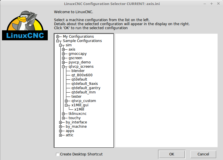

I have success in posting the 1xMill gui on get hub, perhaps not in its final place but it is there for everyone to have a look at and can be cloned and complied as usual and run as a rip configuration.
The present development location is:
$ git clone github.com/auto-mation-assist/x1Mill_branch.git
During cloning After cloning it a folder named It will make a folder in your home directory called: x1Mill_branch
All the commands below are started in sequence from the folders root directory after the clone process has completed.
The x1Mill gui will run as a simulation. It is still in the process of being developed.
$ cd src
$ ./autogen.sh
$ ./configure --with-realtime=uspace --enable-non-distributable=yes
$ make
$ sudo make setuid
$ cd ..
$ . ./scripts/rip-environment
$ linuxcnc
The below is a picture of the simulation tree to show were it can be selected and run from, along with a picture of what you should see. Anyone who wishes to aid in getting the gui fully functional is welcome to join the development group.
