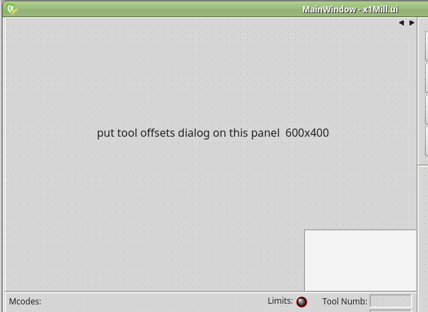

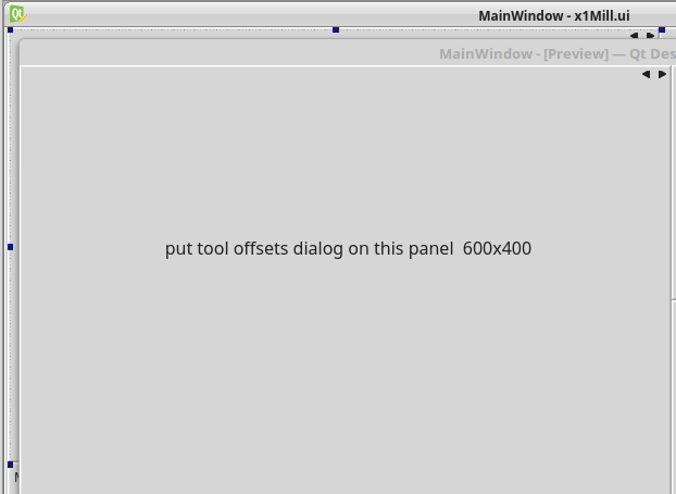

06 Nov 2018 02:01 #120081
by auto-mation-assist
Replied by auto-mation-assist on topic qtvcp issues
Chris,
In ref to the 1xMill gui,
I have been looking for a reason why the dialogs are not showing up today. I was looking and some of the code in tool_offsetview.py and think I may have found the problem. I was thinking that these are being hidden and I can see this happening even with the qt designer when using its run feature.
I think that these dialogs are designed coded to float on top of a gui and be hidden under user controlled conditions and also perhaps under not homed and estop conditions. If this is correct then that presents a problem with gui's that have the dialogs layered in like the 1xMill gui with no need for the to be to be hidden at all. I’m not able to generate homing signals yet for testing.
Also while I was looking at the dialog_widget.py I have never seen it enter the: def geometry_parsing(widget, prefname): near the bottom of that file.
Here are some pictures from qt designer showing the tool_offset dialog partially showing in the lower rignt and when run mode is entered it is hidden. Perhasps that is the reason they are not looking at "onwindow".

- Posts: 7368
- Thank you received: 2181
06 Nov 2018 02:34 #120083
