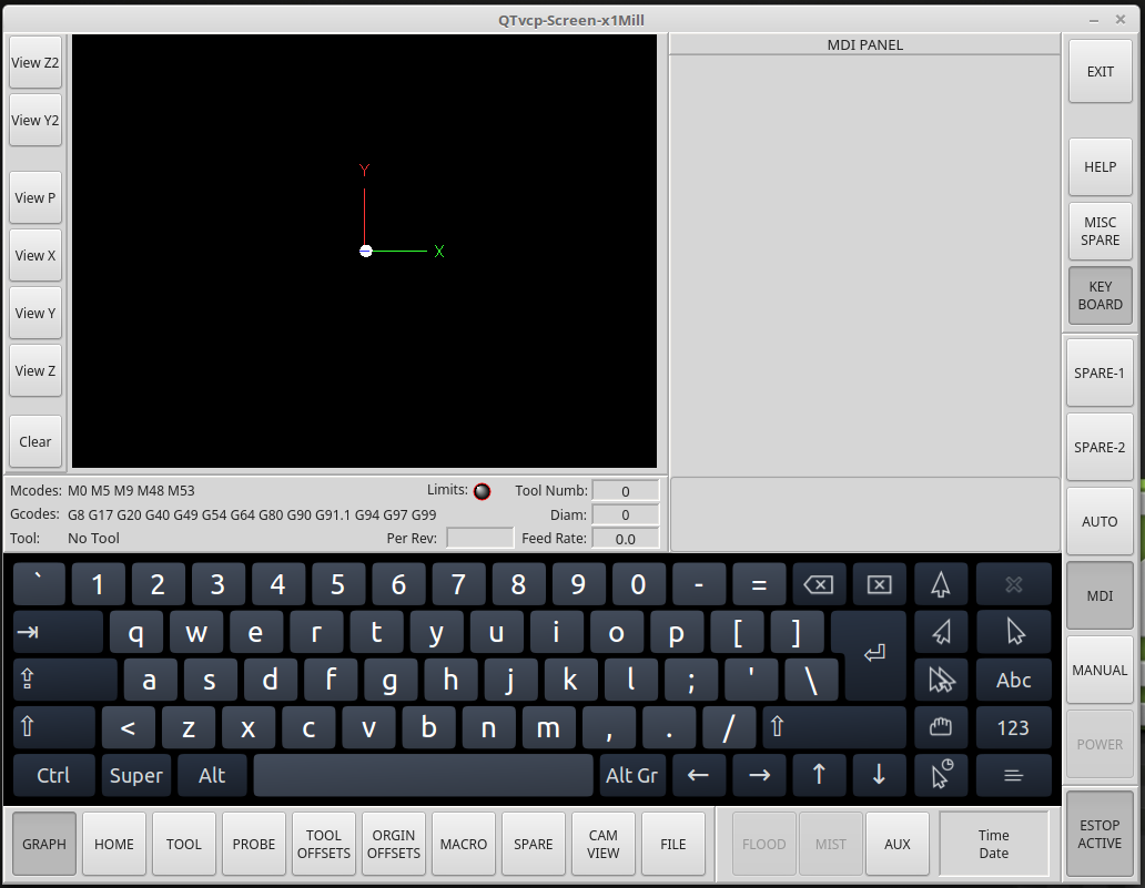

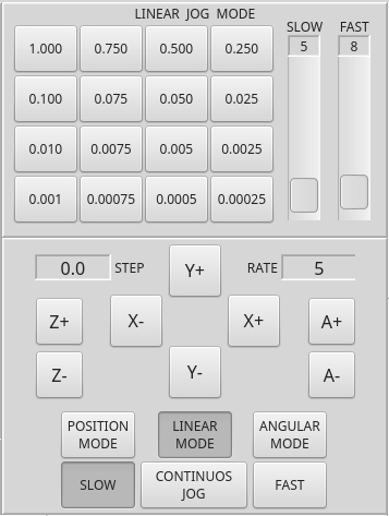

I’m still working on my jogging functions to get these to link into linuxcnc.
Step size with global: "self.jog_step"
Jog rate with global: "self.jog_rate_selected_out"
Continuous or step mode selection with: "def pbtn_jog_method_toggled(self,pressed):"
I have the keyboard embedded and real happy with with he way it fits in.
The upper area of the mdi panel is reserved for midi history and the lower is for the mdi input line. The mdi input line is not showing because its position has not been correctly set yet and is hidden.
There are some pictures of the manual mode linear jogging buttons and the keyboard.

That looks great!
Looks like the button labels are changing properly now.
Jogging I would suggest using action buttons for jogging buttons.
jo_joint_pos_action and jog_joint_neg_action are for positive and negative direction (use momentary buttons) setting the joint_number to the appropriate axis number.
For jogging increment buttons:
jog_incr_action sets a global variable for current jog increment.
By setting the properties incr_imperial_number and incr_mm_number it also takes care of switching units in G20/G21 modes.
In this way the GUI is aware of your jog increments so things like status_label can be used to display the current jog increments.
You can certainly roll your own if you have some good reason to, but I would still suggest letting qtvcp know about it by using the ACTION / STATUS library.
eg.
ACTION.SET_JOG_INCR(.010)
rate = STATUS.get_jog_increment()
Noting these expect the rate to be in machine units no matter what G20/G21 mode you are in.
Chris M

Note on custom jog rate selection buttons in x1Mill gui.
In the 1xMill gui jog rate is determined by the states of the following buttons; position jog mode, linear jog mode, angular jog mode, and slow and fast jogging buttons. For actual rate values it uses the values produced by six slider type widgets. It also includes logic required to output the correct jog rate value for any combination of buttons and value changes made by the slider type widgets.
The eleven items of this group produce two signals, a jog rate value for each possible combination of buttons and a fast/slow selection signal that will interface with linuxcnc. This group of eleven items can be considered as being a custom action widget.
The use of separate slow and fast jogging buttons help reduce human errors during fast slow selection process.
Last edit: 03 Nov 2018 17:26 by auto-mation-assist.
- Posts: 7368
- Thank you received: 2181
03 Nov 2018 18:21 #119893
Replied by cmorley on topic qtvcp issues
What does position,angular and linear modes change?
Qtdefault has similar capabilities though in a different idiom.
Though it doesn't do angular jogging as the screen doesn't support more then 3 axis.
It also has only 3 jog increments.
i think your jogging screen would make a great widget for qtvcp
Chris M
Chris M
