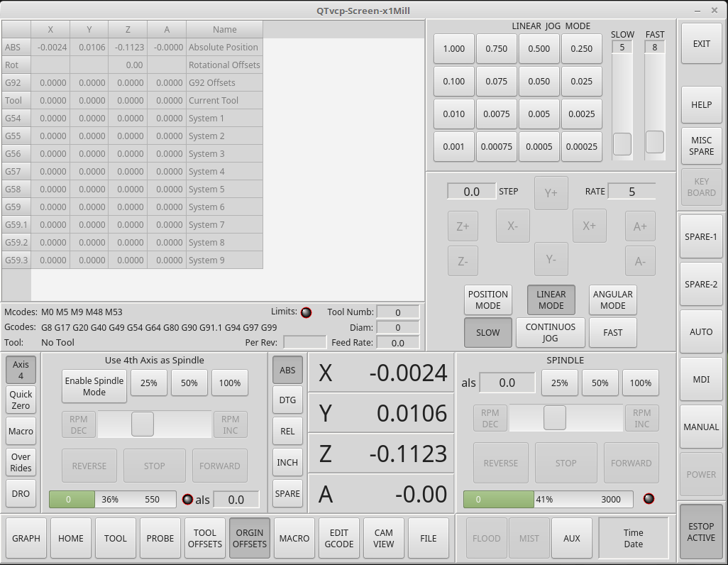

In ref to the tool table:
I have always liked the interactive pictures to enter tool parameters. I know there are some suppliers catalogs that have lots of pictures so they are likely available from sites like:
tracepartson line.net
partclould.net
or other sources like them that offer free 2D & 3D cad models. They may need conversion to .png or other formats but picture files may be available from these sources. You would need to search the categories.
If a table entry for these cannot be added to the tool file then there could be a prefix added to the description/comment to call up the correct interactive picture. Such a picture could be placed embedded in a stack or as a pop-up.

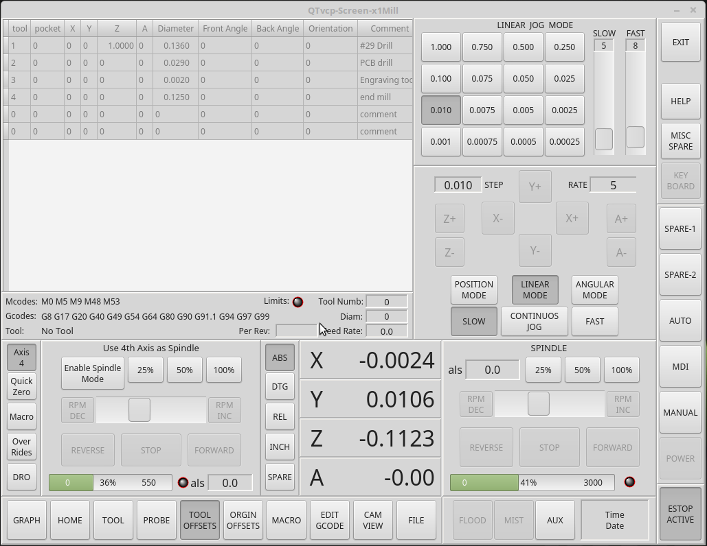

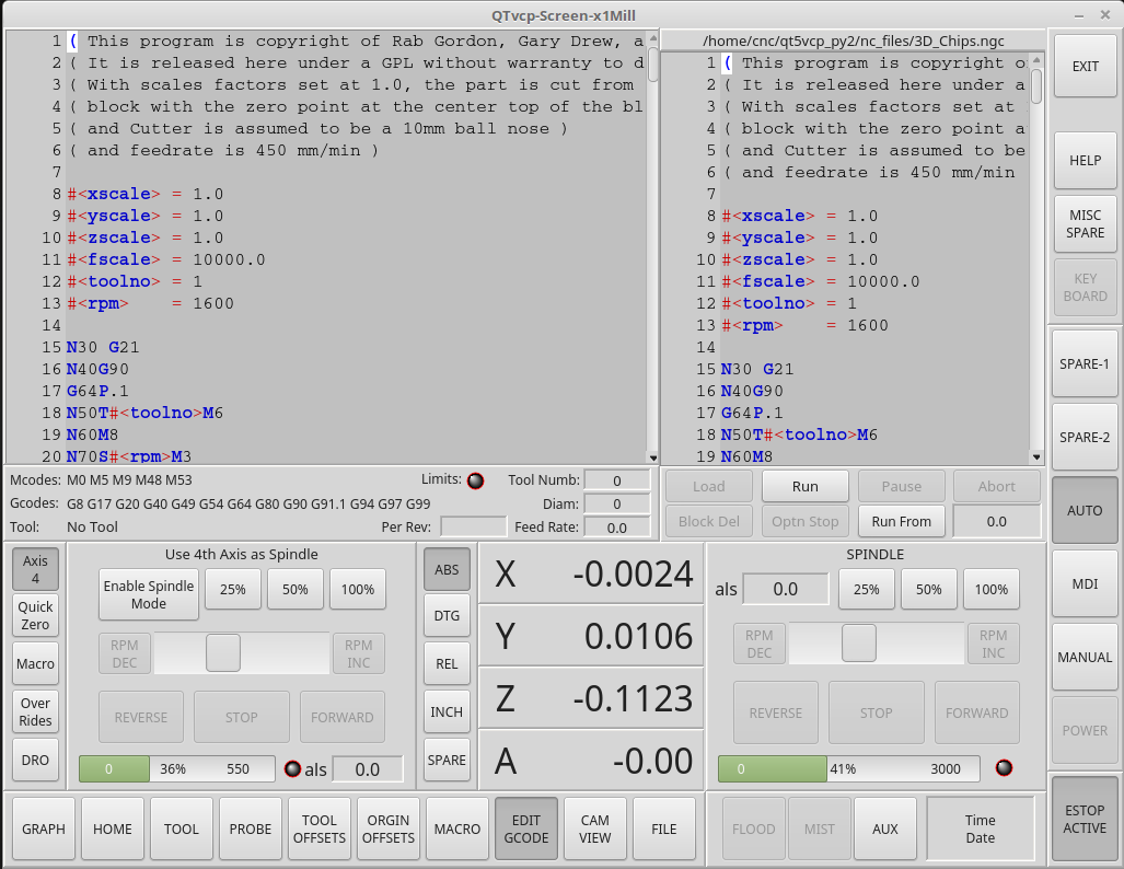

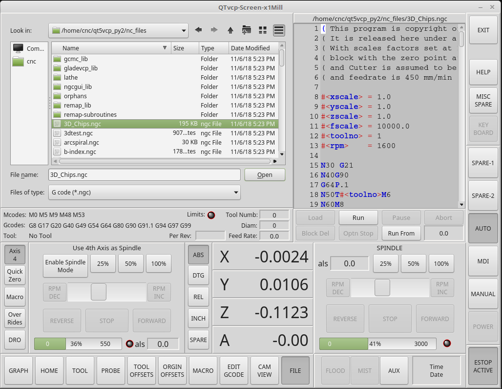

07 Nov 2018 13:25 - 07 Nov 2018 13:28 #120196
by auto-mation-assist
Replied by auto-mation-assist on topic qtvcp issues
Here are some pictures that show the embedded versions of what we discussed before. It looks like they are coming along well.
In the MacroTab one I noted some issues:
In qt designer it show the text "No Usable Macros Found In:" on top right of its panel:
When the gui is running this does not show up.
Also If I push the cancel button the panel goes blank and can not be made to return to normal. Only by termination and bringing the gui will bring it back up as not a blank panel.
Here are the pictures of the ones I have added when they are selected. I did load a file using the file panel and it changed to auto mode and displayed the file in the gcode display panel as show. All these panels were set to. 600x400 at 0, 0.
Last edit: 07 Nov 2018 13:28 by auto-mation-assist. Reason: added: All these panels were set to. 600x400 at 0, 0.

Pushed a fix for macrotabs.
Looks like you need a MDI-history-only widget?
