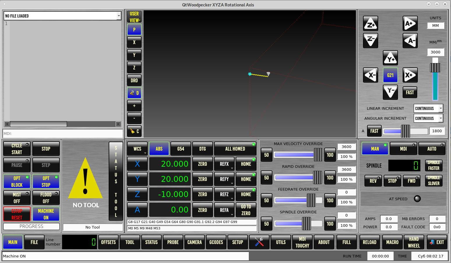

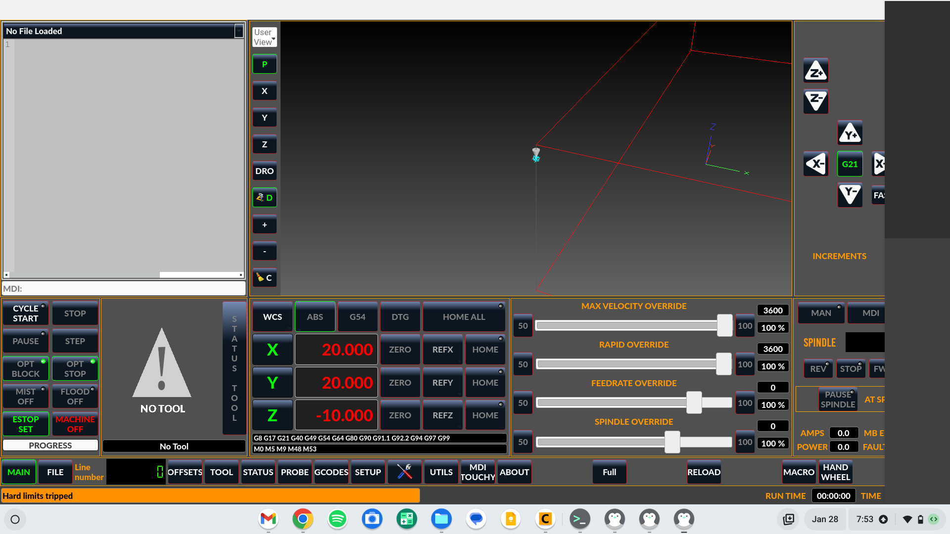

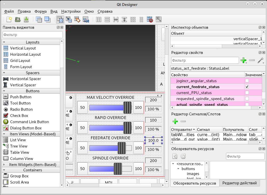

I did delete prefs file
This is a chromebook so might be a bit odd.
Replied by rodw on topic Sample Qtvcp Screens
Seems to not be resizing horizintally, The sreen @1536x834 kooked squashed, but on 1080p, the resizing stuff might need some workUnzip the archive to the linuxcnc/configs folder. Place style files and woodpecker.qrc with replacement at usr/share/qtvcp/screen/woodpecker, you will be able to switch styles from settings tab. The size changes to F10(min), F11(max). In the woodpecker_xyza.ini file, remove -f from the DISPLAY section.

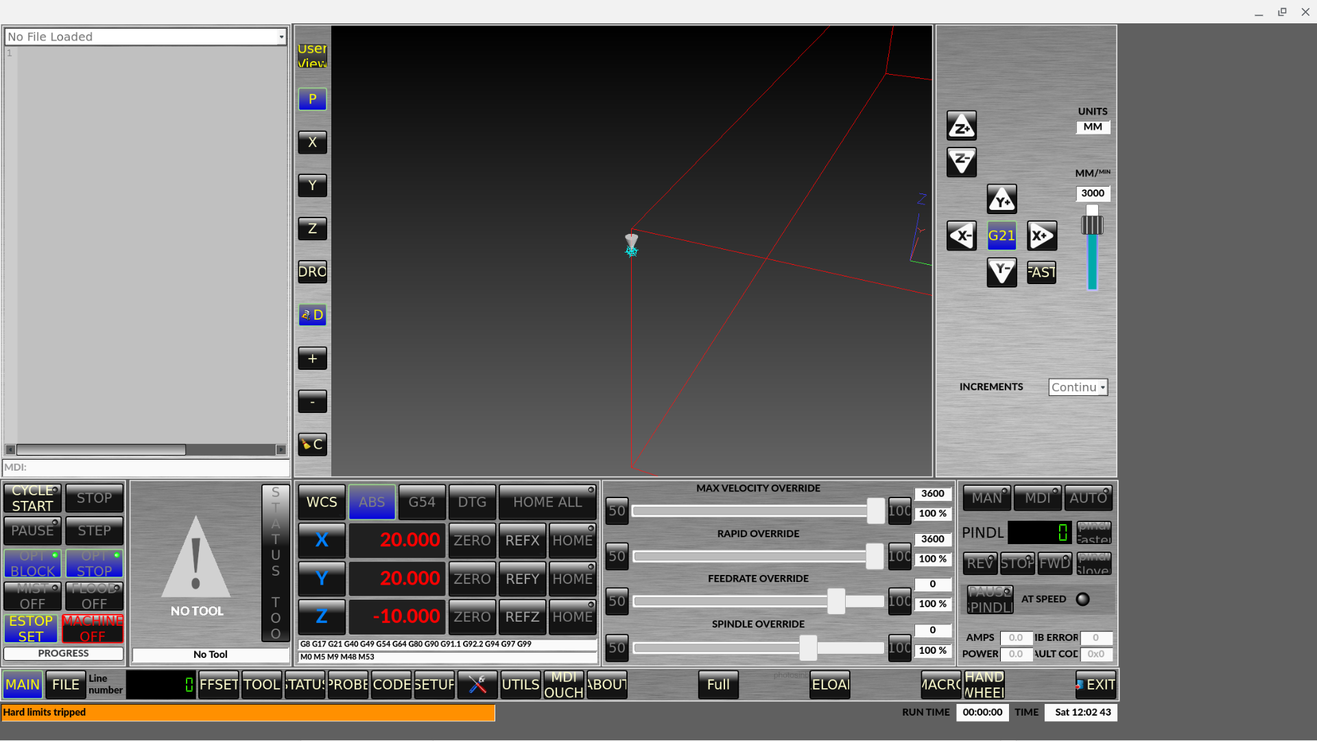

Replied by hottabich on topic Sample Qtvcp Screens
You can go to the designer and fix the size for your monitor. Or fix it. And you don't have to delete anything. Everything works. I am attaching the corrected version.

and tweaking the spindle up and down button text in QT DEsigner, I solved most of my problems but I have an issue with the jogging increments I don't know how to solve:
Further help appreciated
Well, after installing a couple of fontsYou can go to the designer and fix the size for your monitor. Or fix it. And you don't have to delete anything. Everything works. I am attaching the corrected version.
BebasKai.otf
BebasKai.ttf
Lato-Heavy.ttf

You can go to the designer and fix the size for your monitor. Or fix it. And you don't have to delete anything. Everything works. I am attaching the corrected version.Well, after installing a couple of fontsBebasKai.otf BebasKai.ttf Lato-Heavy.ttfand tweaking the spindle up and down button text in QT DEsigner, I solved most of my problems but I have an issue with the jogging increments I don't know how to solve:Further help appreciated
Thank you for your attention. I fixed the speed increment bug. There was no mark in the status_label. Problems with sizes still arise because there is no hiding of system panels. Judging by the screenshot, you are using Pop OS?

Looks like some ChromeBook versions of Linux.
Replied by tommylight on topic Sample Qtvcp Screens
Nope, not Pop OS, at least not the default appearance.Judging by the screenshot, you are using Pop OS?
Hmm, Thanks, that made no difference here. I dd go into designer and its the same as your screendump.
Yeh Tommy is right, I run sims on my Chromebook which lets you install Debian Bullseye on it.
I have been having troubles with it running wayland but finally have a workaround for that by putting this in muy .profile
export PYOPENGL_PLATFORM=x11
Bedtime here.
I may see if i can get this on a machine tomorrow.
Bedtime here.
