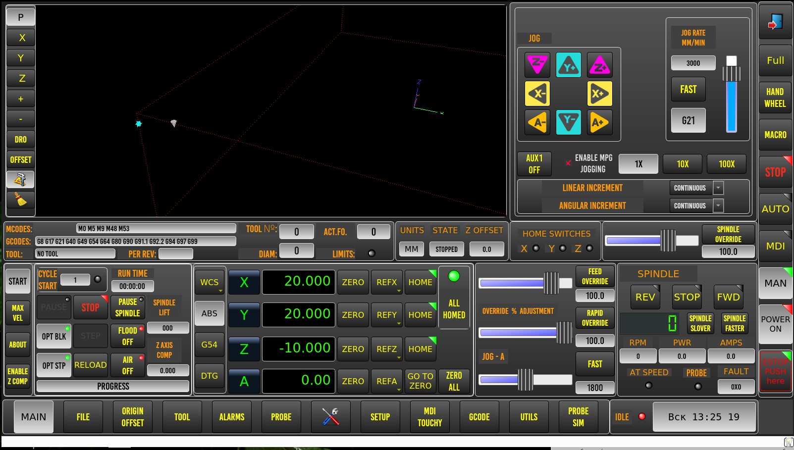

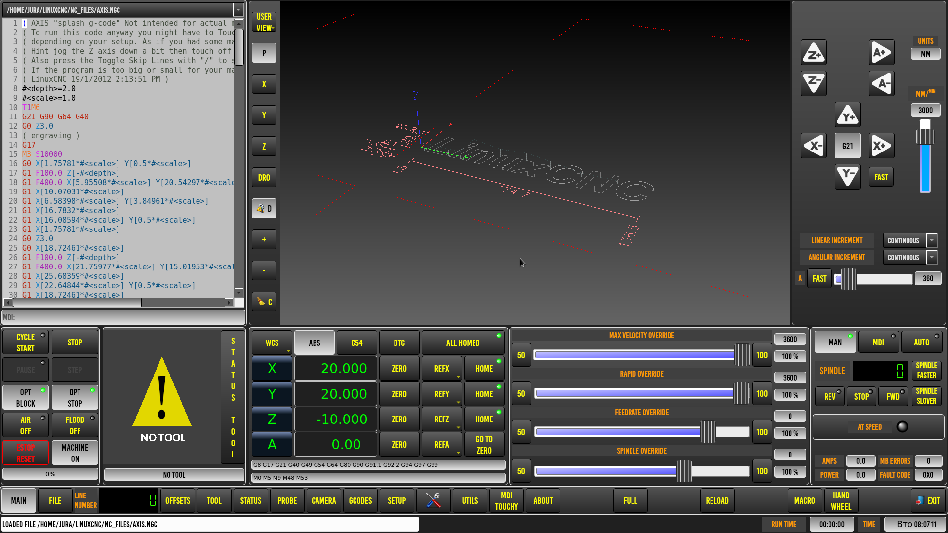

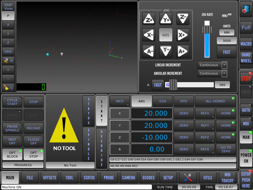

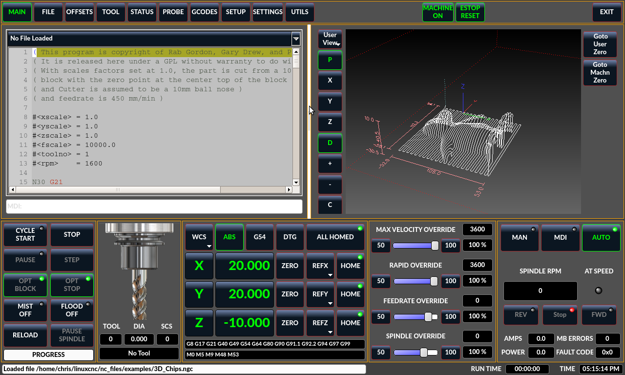

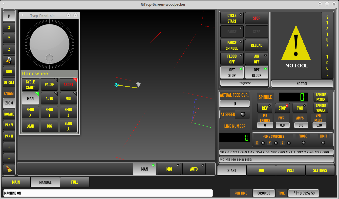

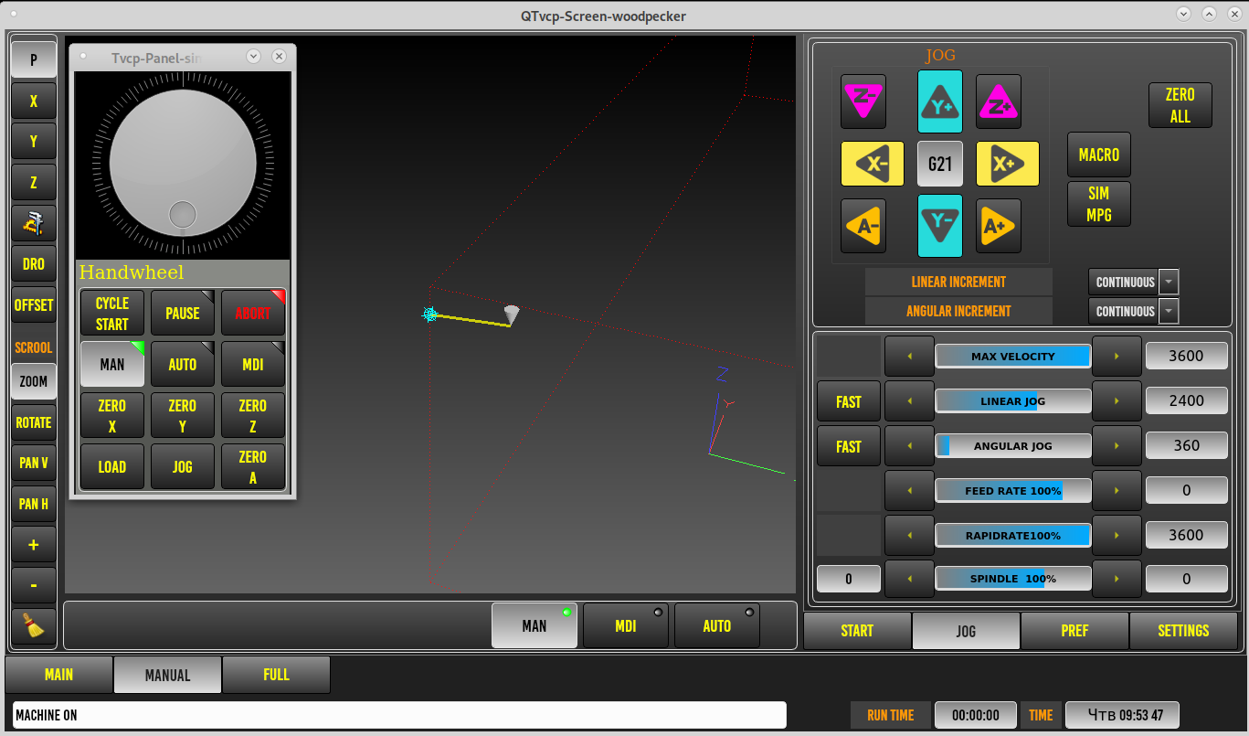

Woodpecker_(1280x1024_5axis).

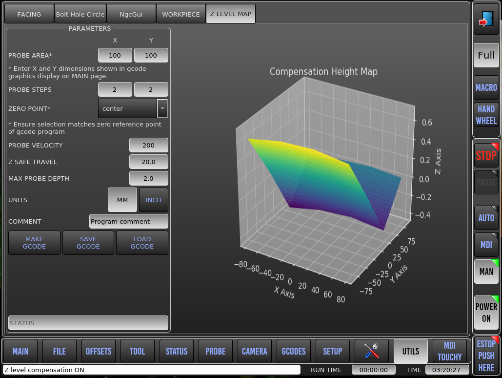

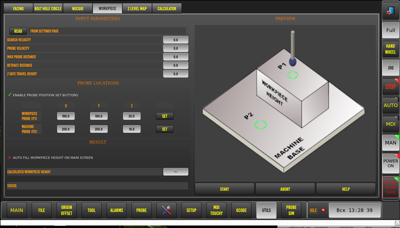

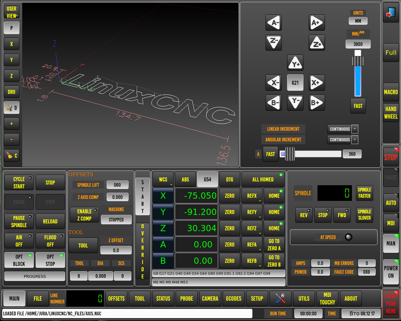

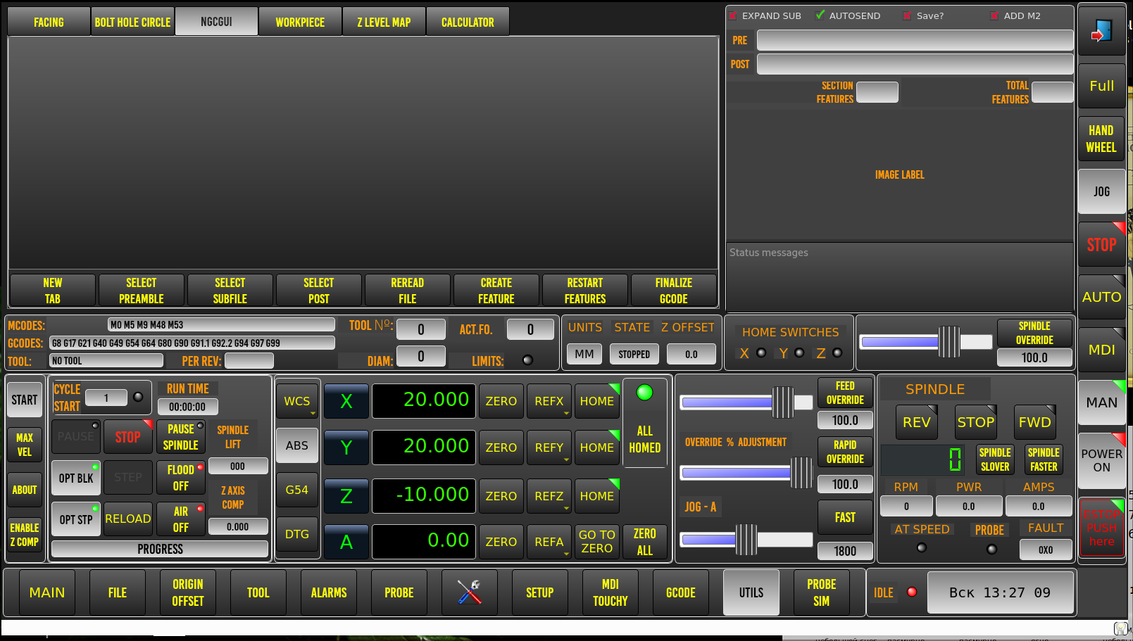

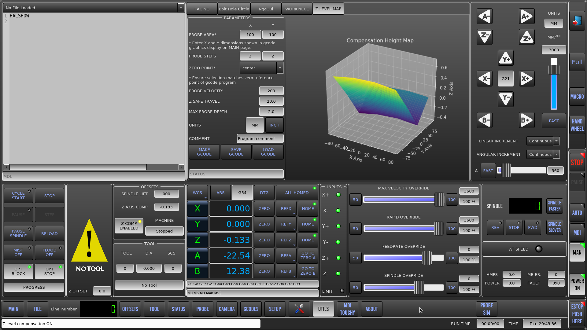

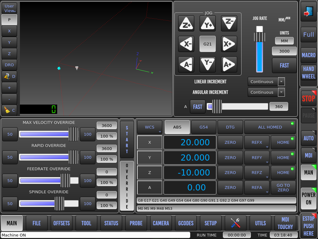

QtWoodpecker_hd-master-(5axis)

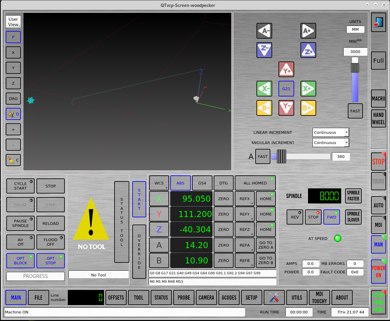

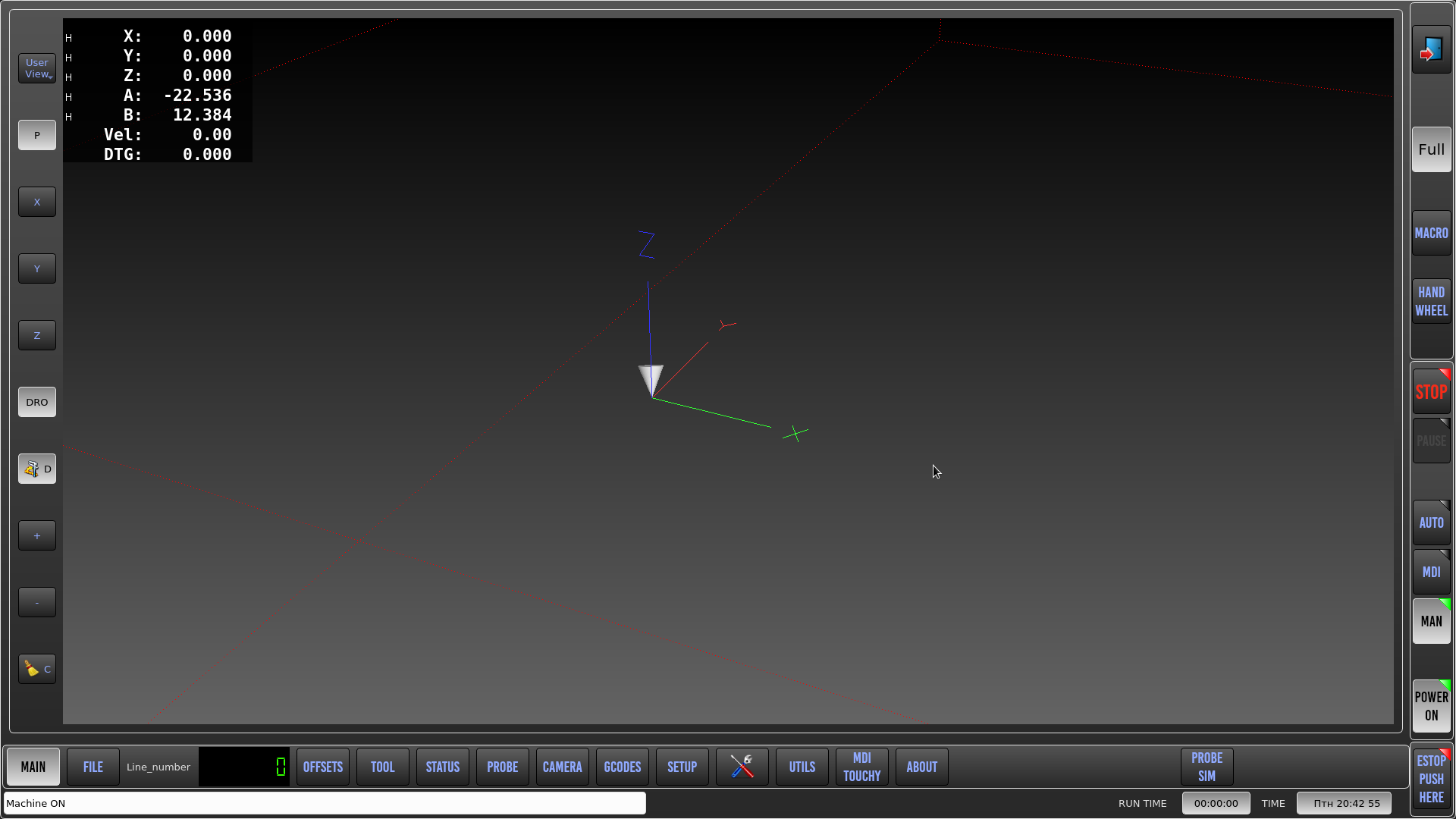

Trial file on github. Place the file at: linuxcnc/configs and test. There will be more. github.com/chottabich

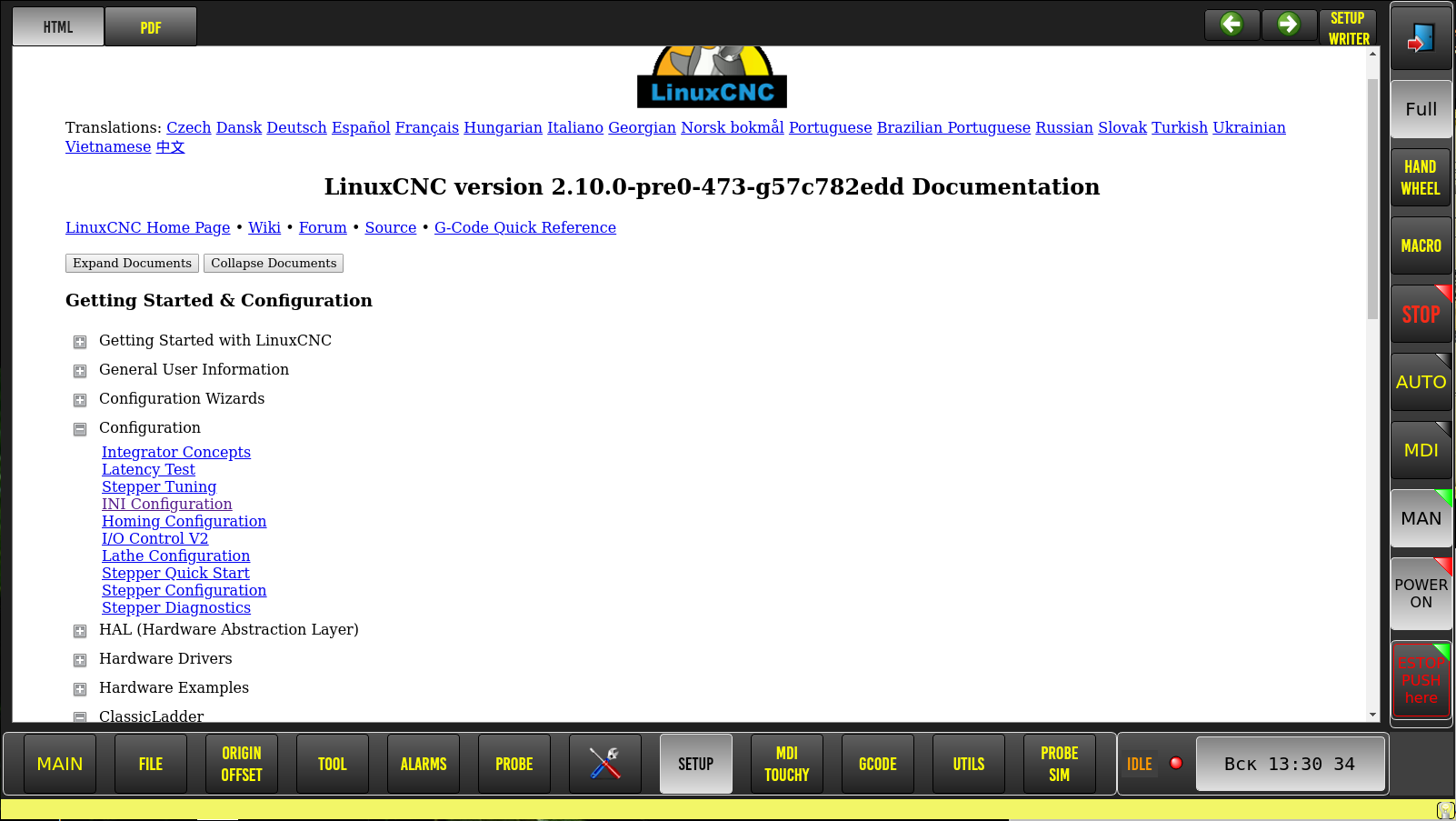

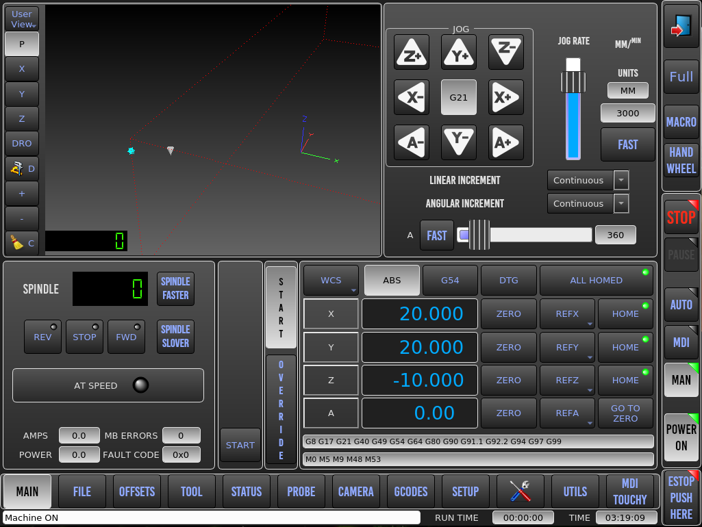

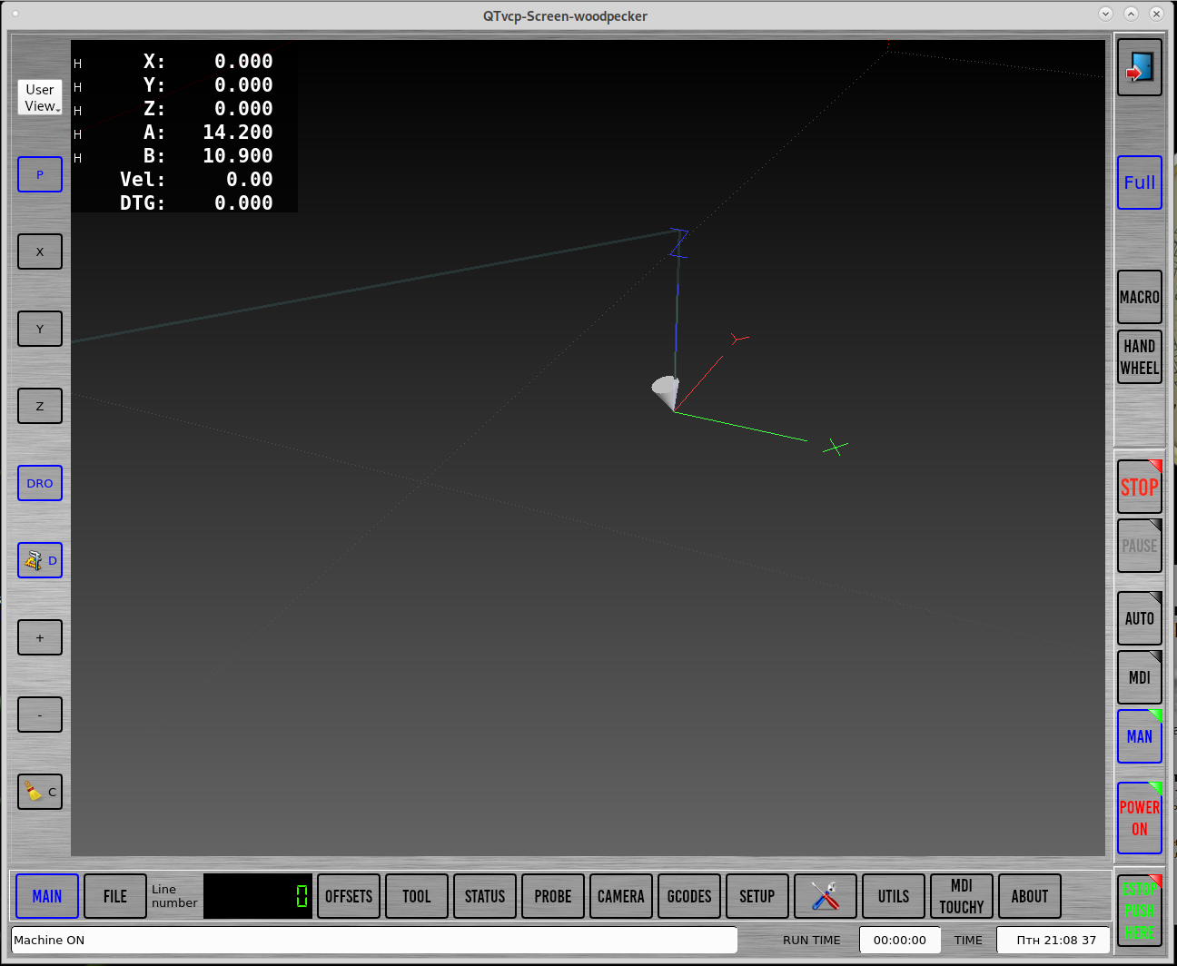

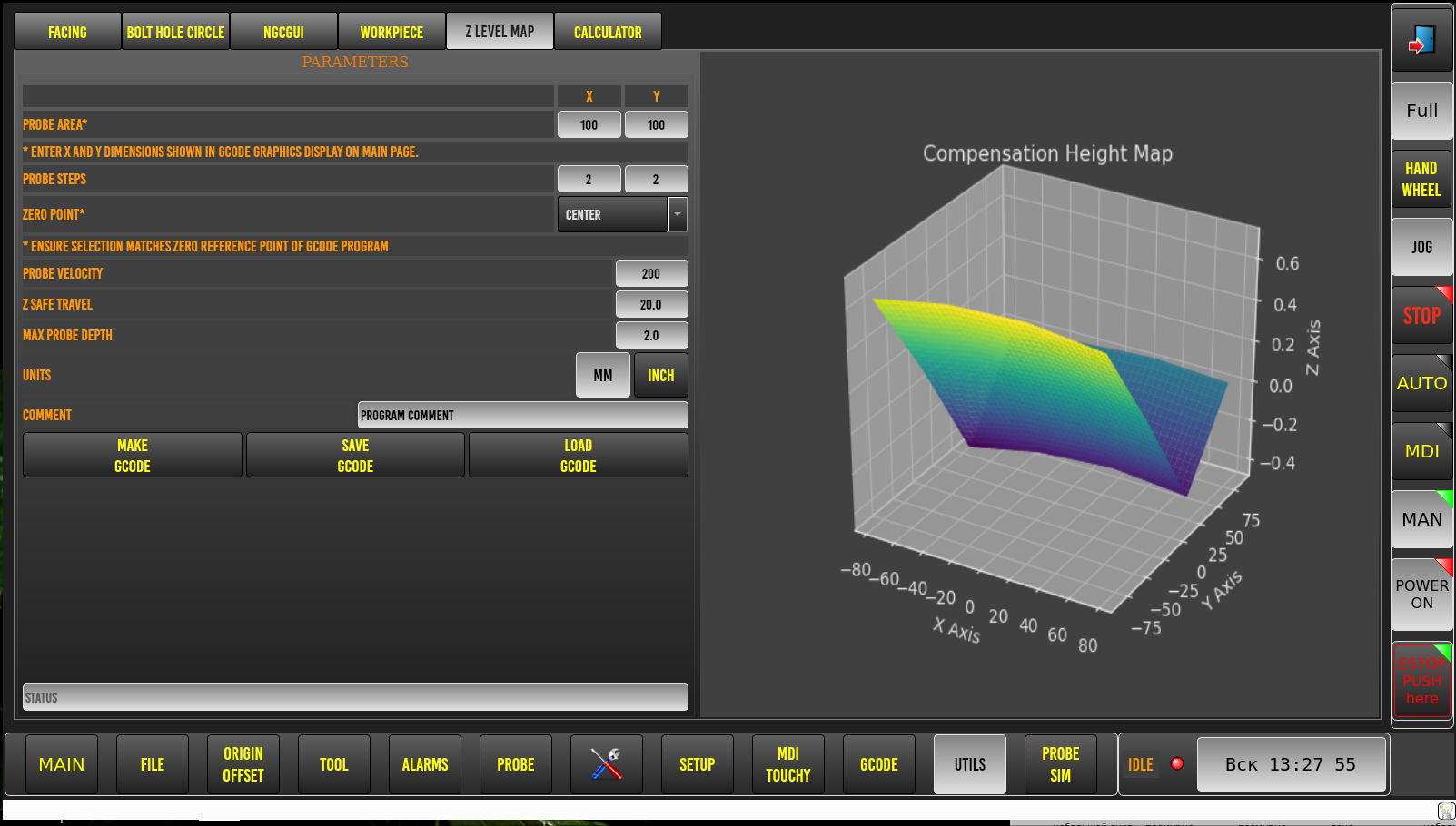

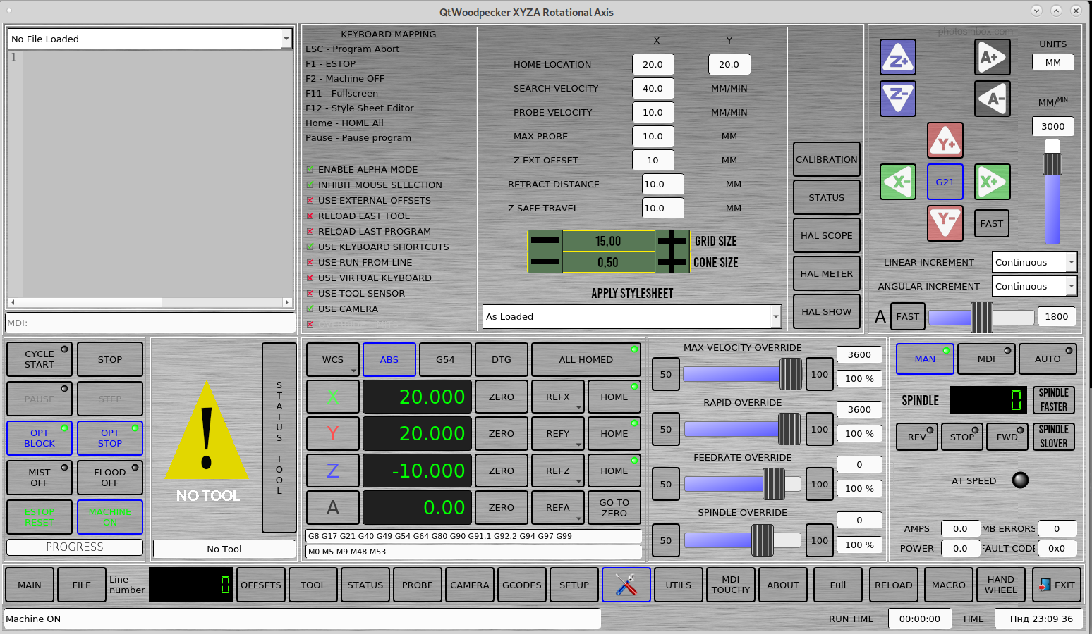

Meet QtWoodpecker_1024x768 and five more options. The files are available on Git Hub at the link in the previous post.

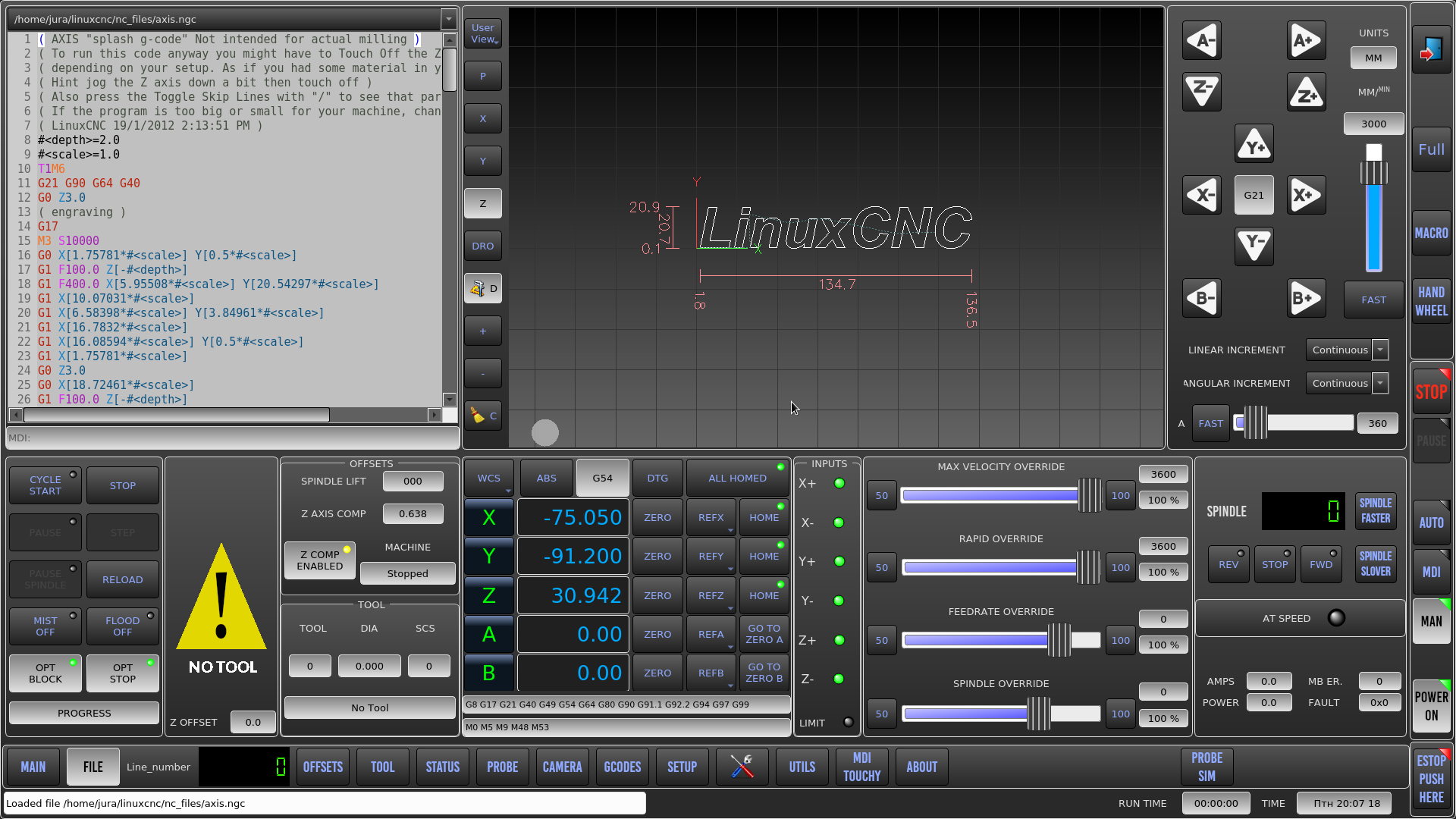

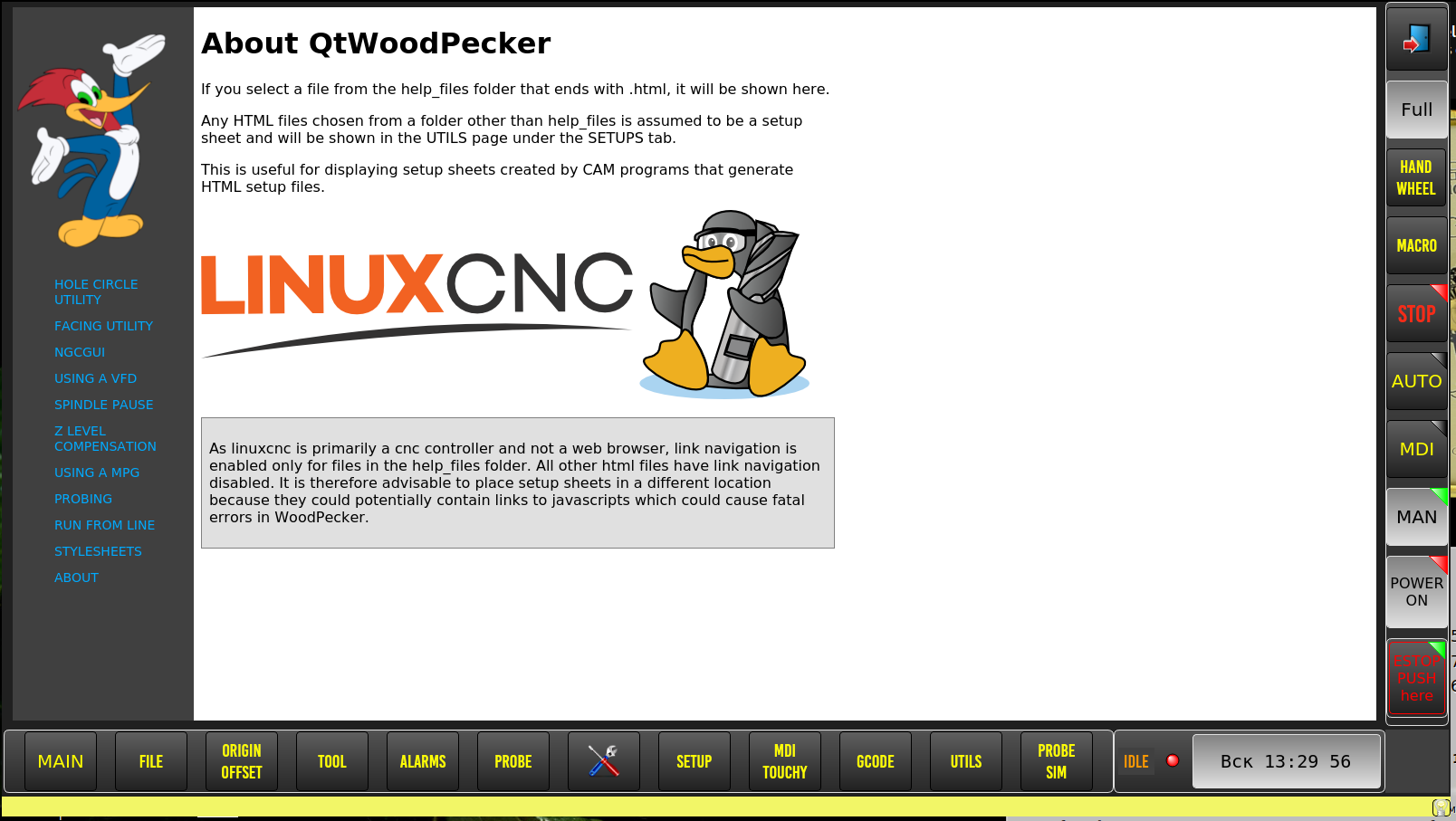

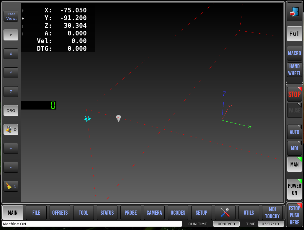

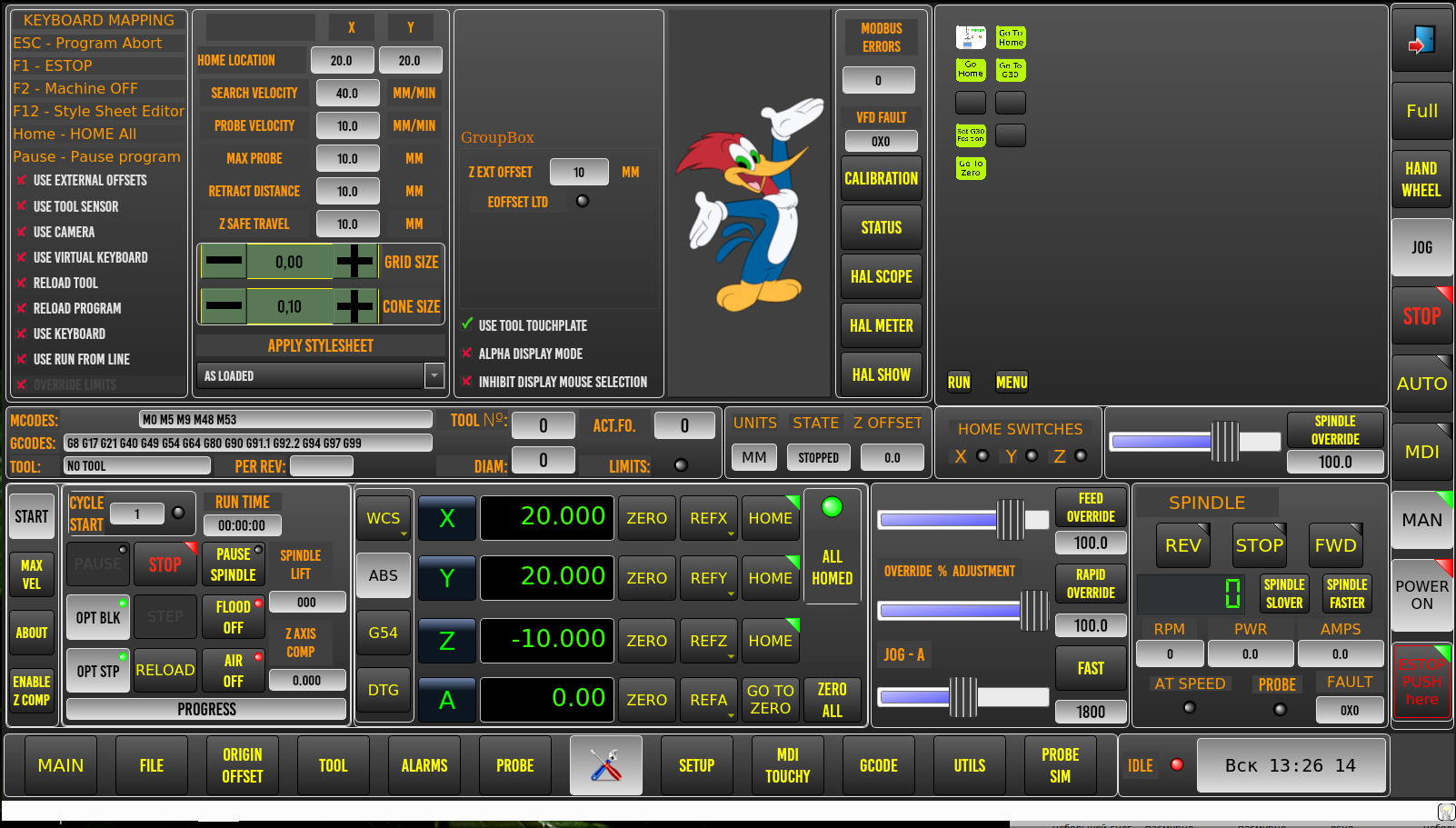

Woodpecker (1600x900...1200) is already available on GitHub. Link above post.

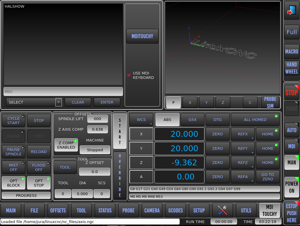

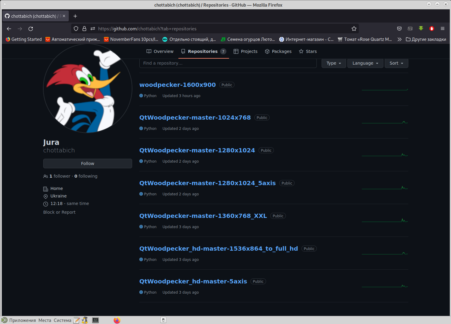

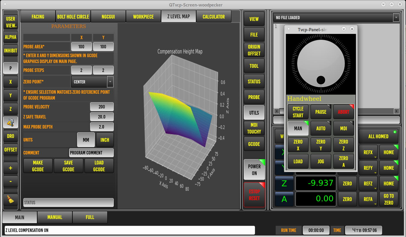

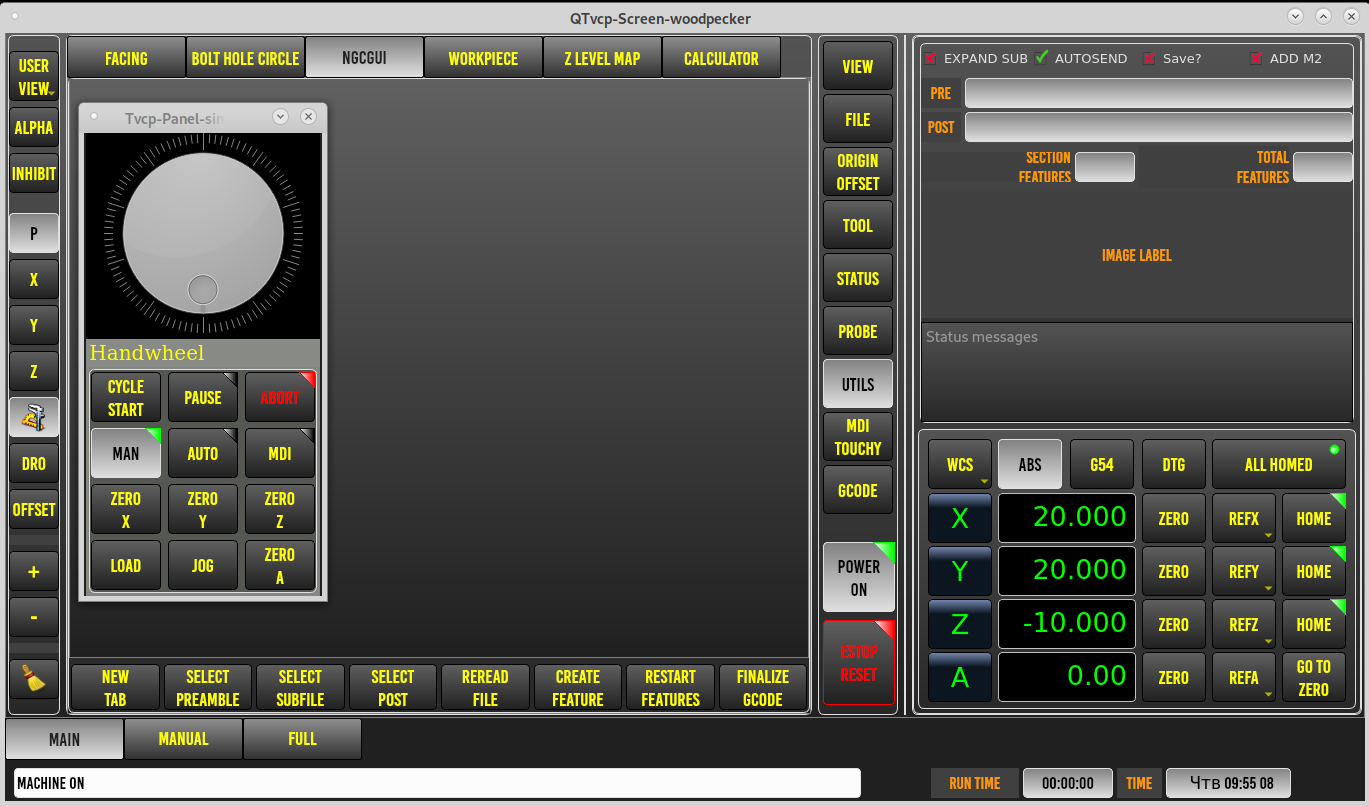

github.com/chottabich?tab=repositories
All repositories have been updated.

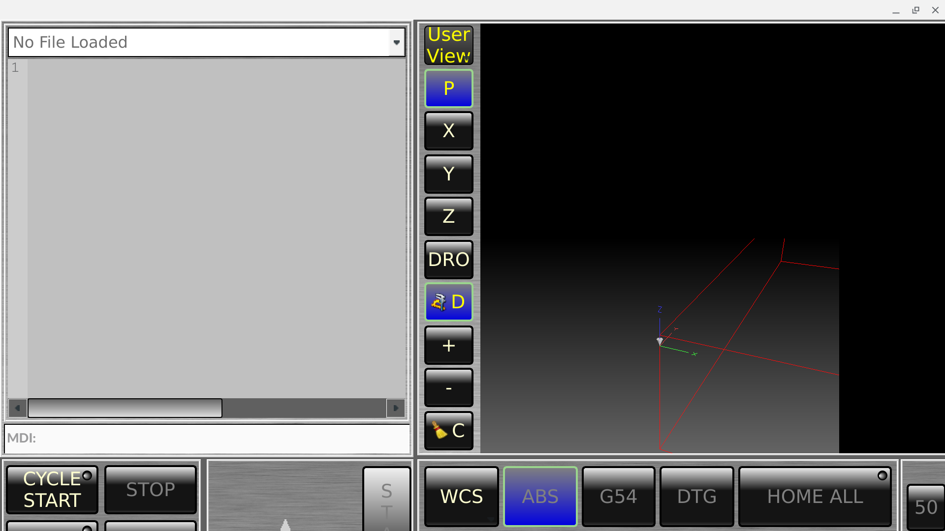

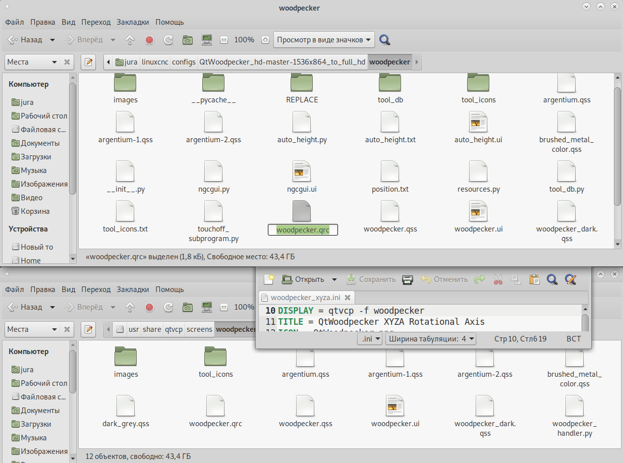

recloned from scratch and updated the prefs file to use my home folder. The styles are now OK but its still oversized...

Unzip the archive to the linuxcnc/configs folder. Place style files and woodpecker.qrc with replacement at usr/share/qtvcp/screen/woodpecker, you will be able to switch styles from settings tab. The size changes to F10(min), F11(max). In the woodpecker_xyza.ini file, remove -f from the DISPLAY section.
