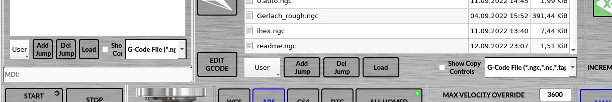

I have resized the buttons in file_manager. If you find it useful then replace the widget. Thank you!
- MarkoPolo
- Posts: 319
- Thank you received: 90
18 Sep 2022 09:38 #252249
by MarkoPolo
Replied by MarkoPolo on topic Сustomization QTvcp
In qt_dragon in the smaller window on the left, these buttons do not fit anyway. I guess you would have to make buttons with variable size
- MarkoPolo
- Posts: 319
18 Sep 2022 13:05 #252261
by MarkoPolo
This is the variable width version of the buttons.

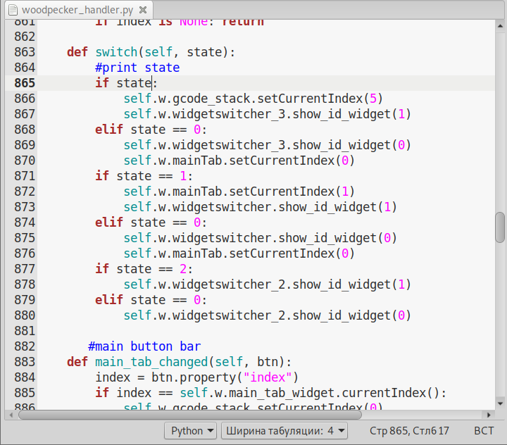

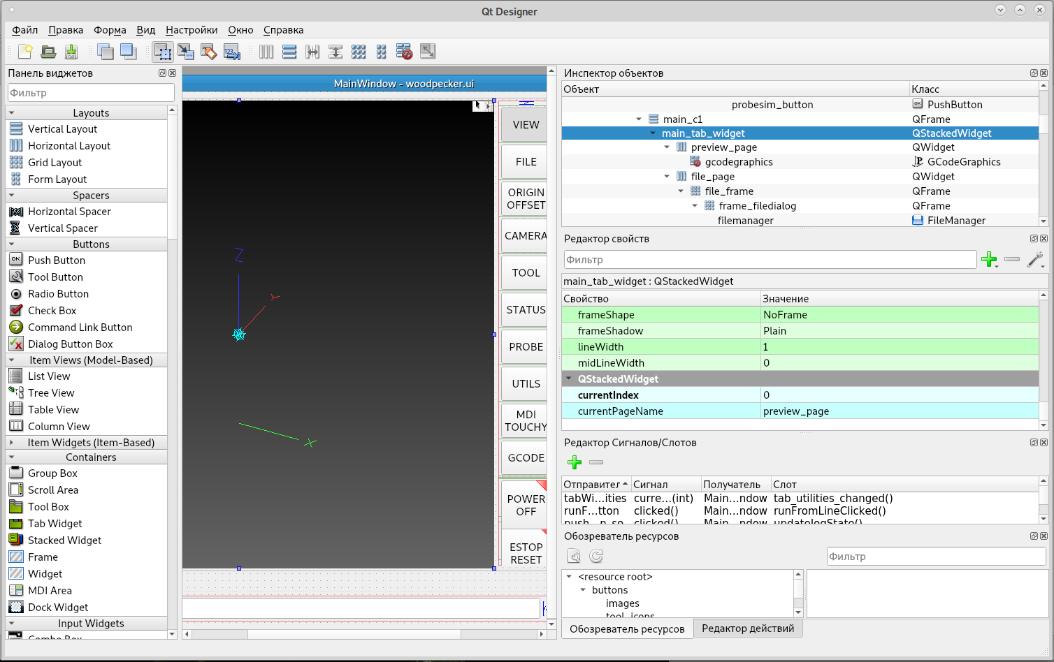

24 Nov 2022 11:03 - 24 Nov 2022 15:50 #257553
by hottabich
Replied by hottabich on topic Сustomization QTvcp

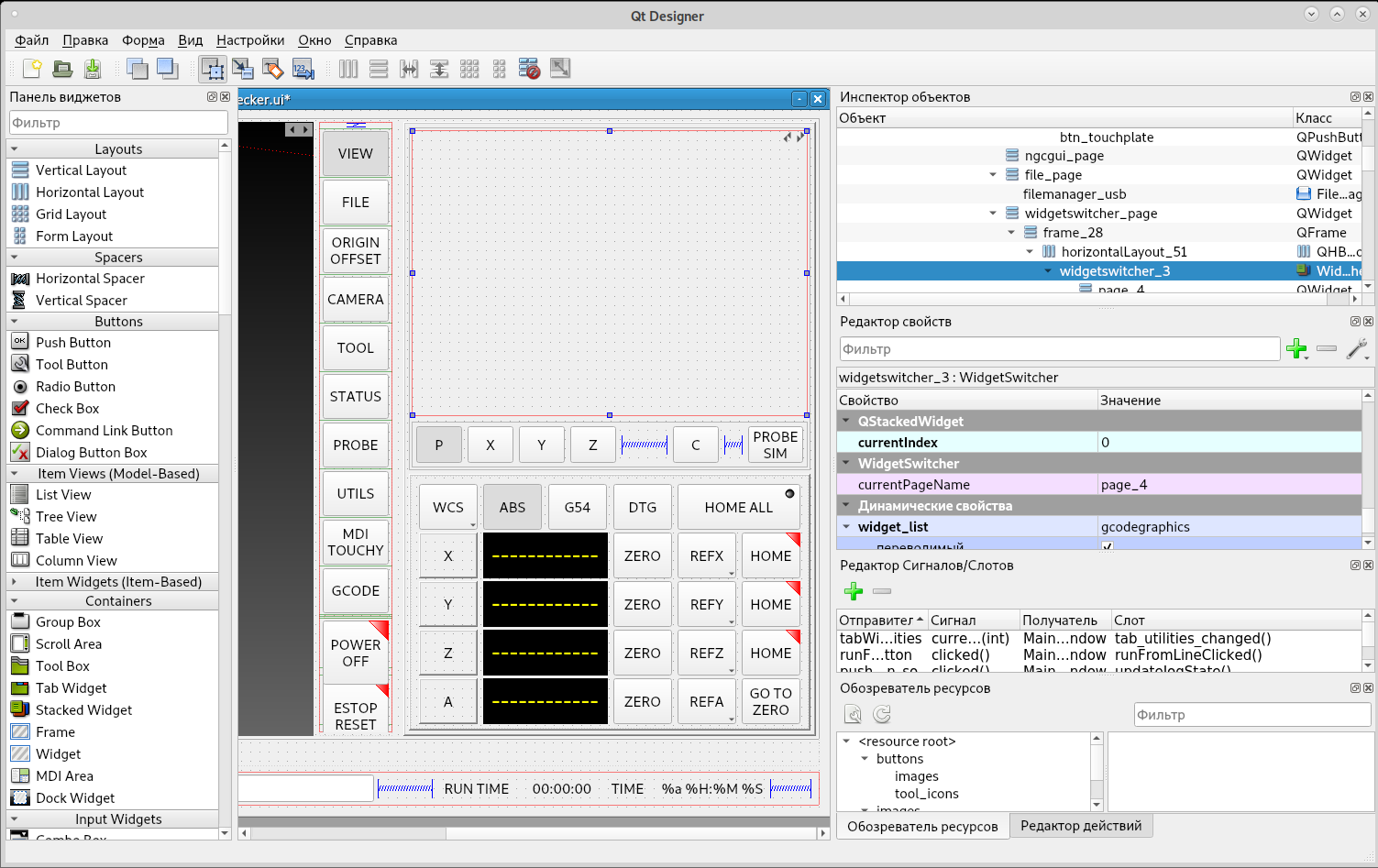

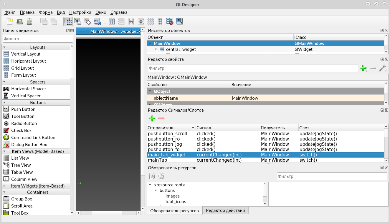

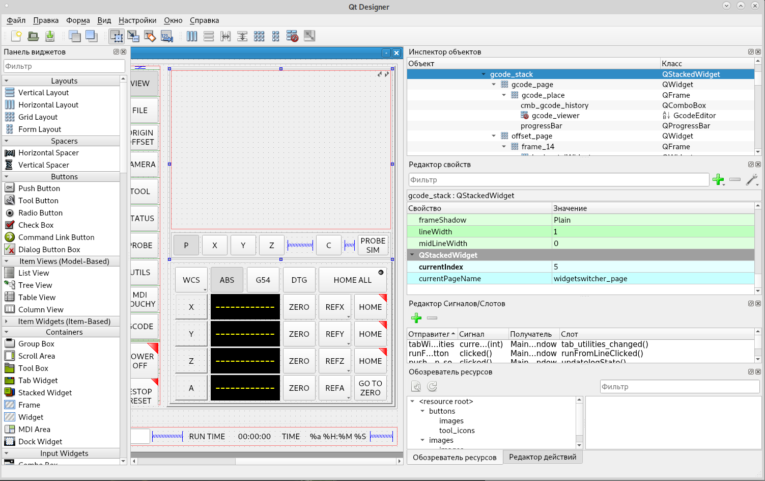

Hello! Please tell me what I'm doing wrong. Widgetswitcher doesn't work and doesn't throw an error. Thank you!
Last edit: 24 Nov 2022 15:50 by hottabich.
- hottabich
- Posts: 574
- Thank you received: 96
24 Nov 2022 16:36 #257563
by hottabich
The question is closed, you need to add a signal \ slot as in the screenshot and everything works! Thank you all for your attention.

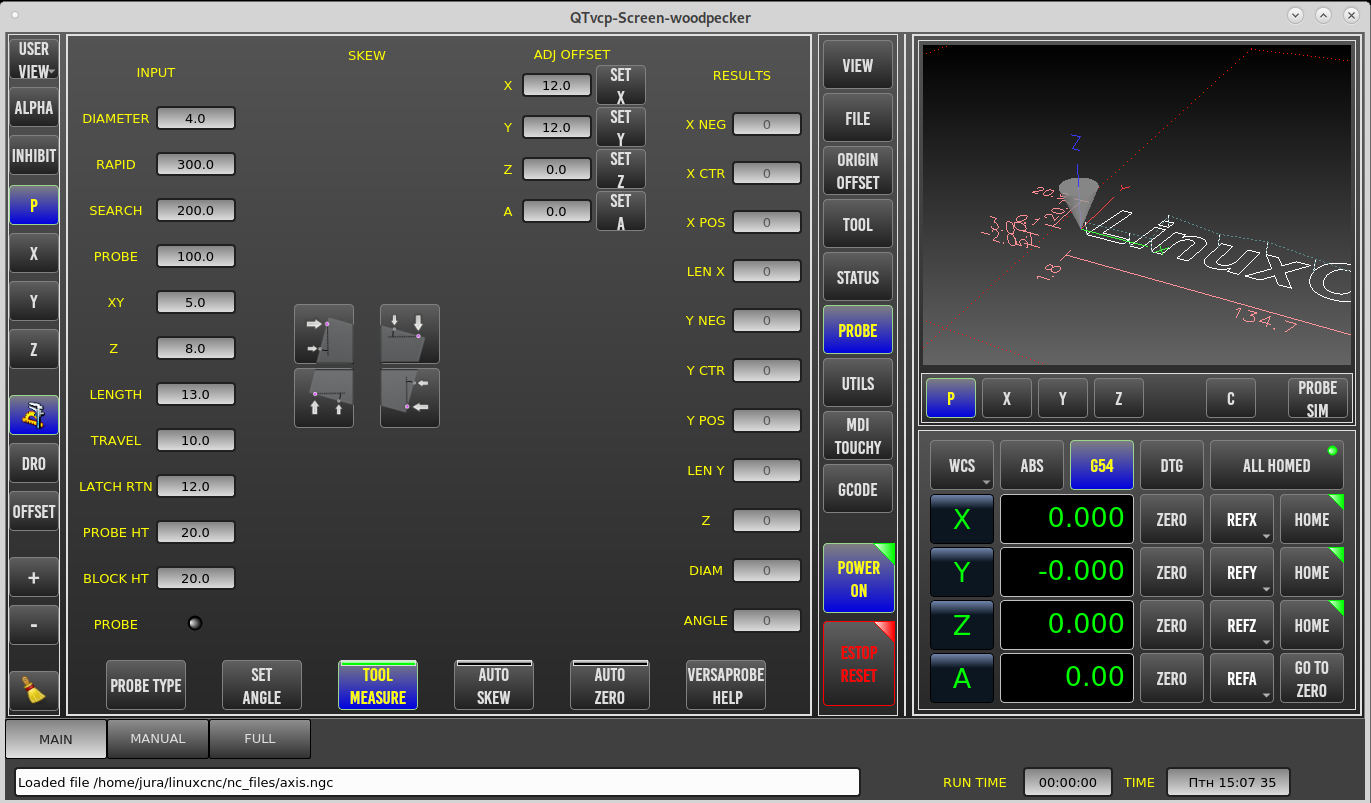

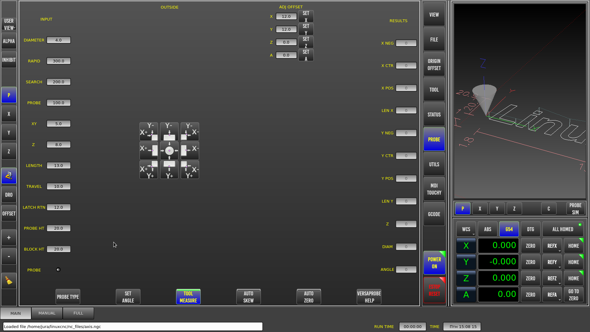

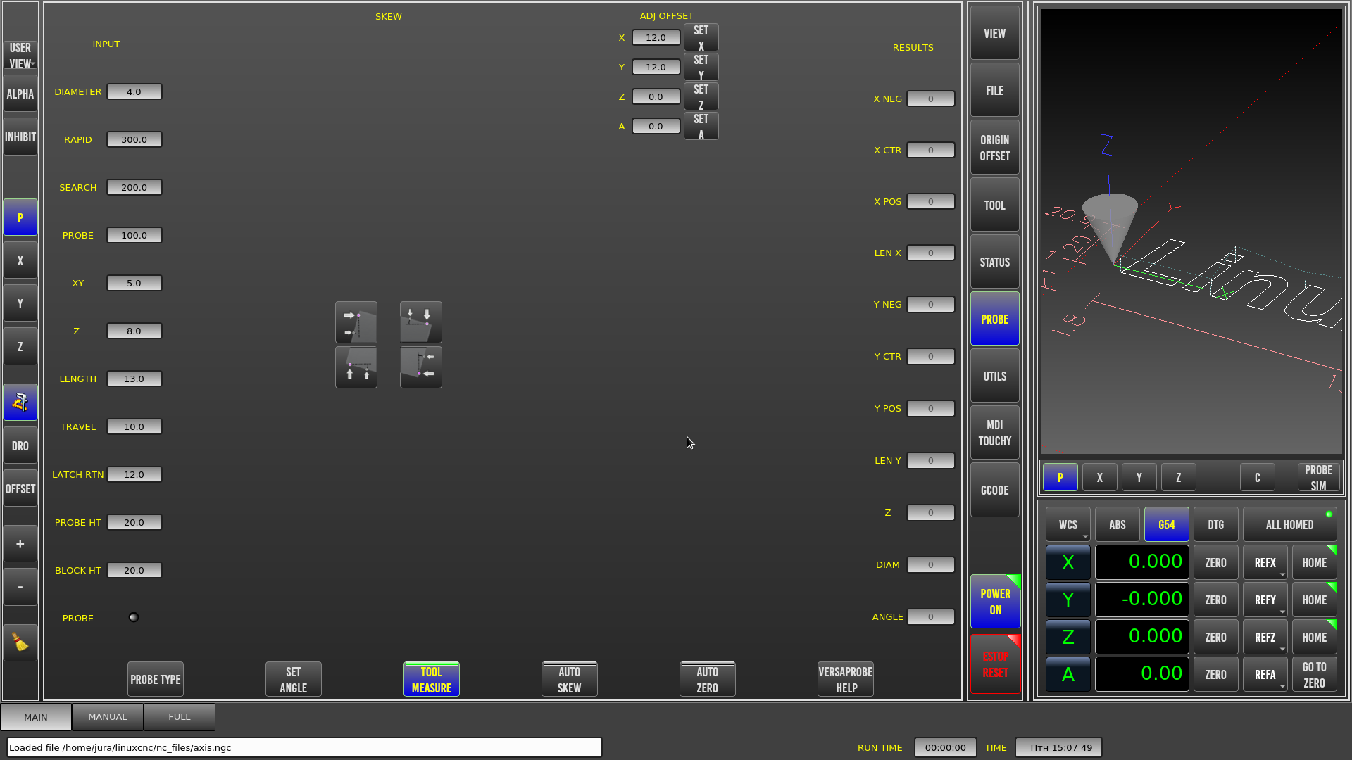

If you find it useful, please change the versa_probe.ui interface to the attached one.
- Posts: 7368
- Thank you received: 2181
25 Nov 2022 23:28 #257653
Replied by cmorley on topic Сustomization QTvcp
What is different?
- hottabich
- Posts: 574
26 Nov 2022 10:34 #257671
by hottabich
Added vertikalSpacer and tile placement is independent of UI window size.What is different?
- Posts: 7368
27 Nov 2022 03:42 #257719
Done. Thank you.

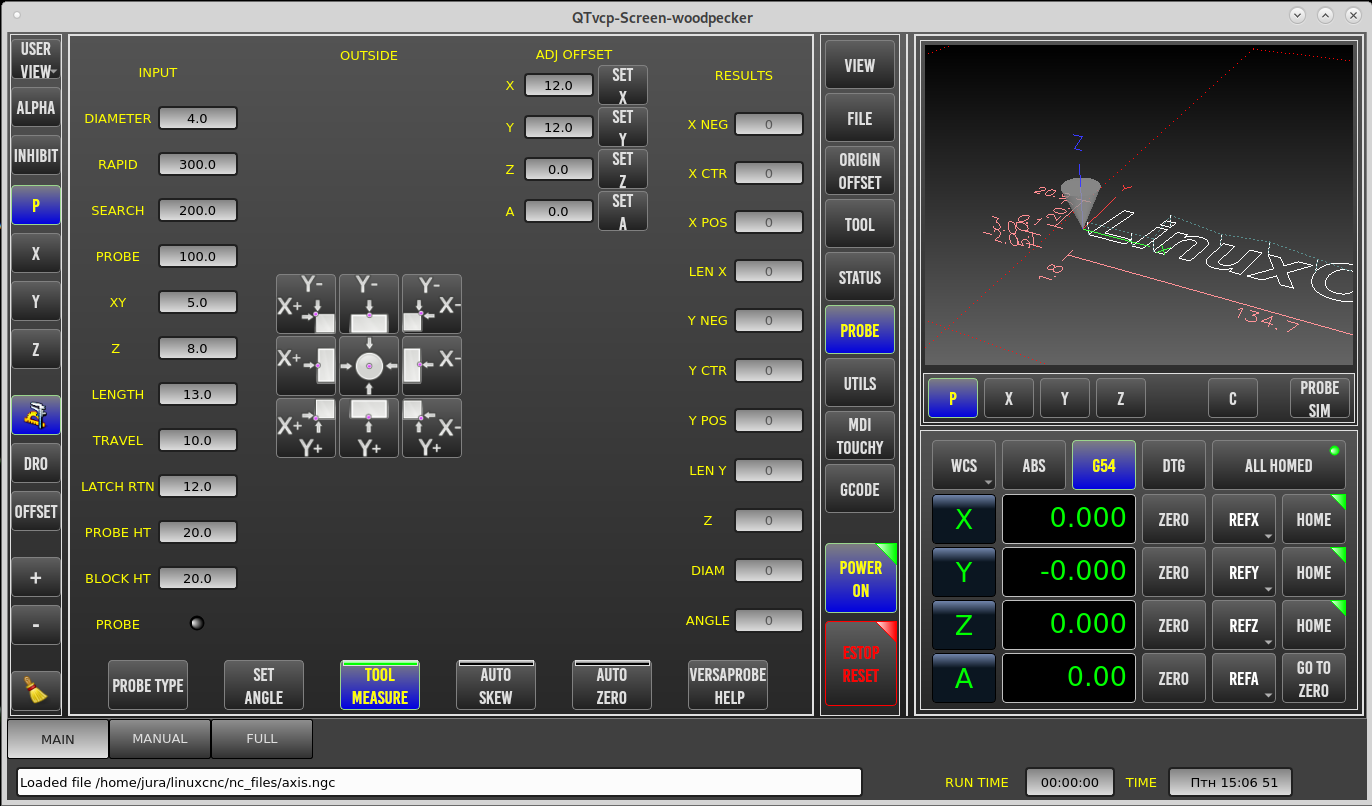

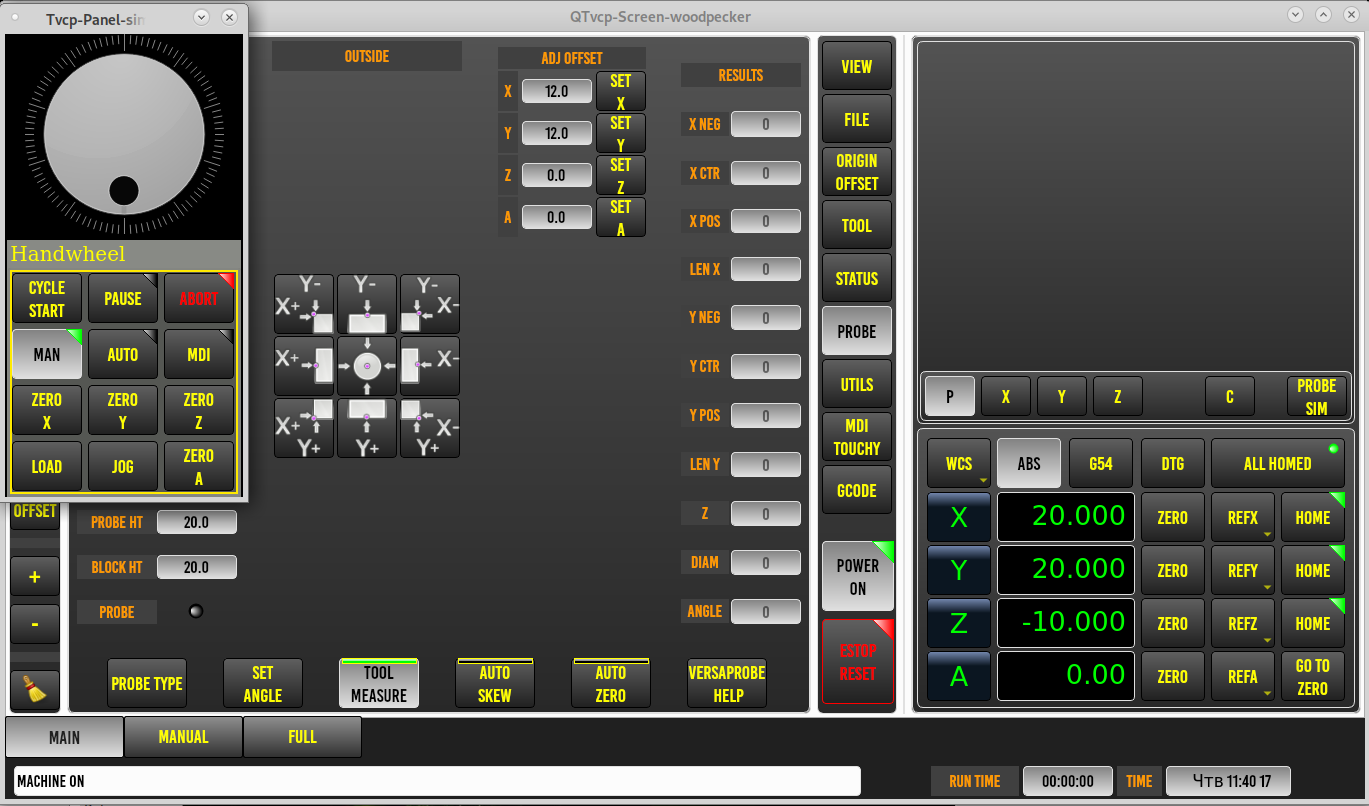

- hottabich
- Posts: 574

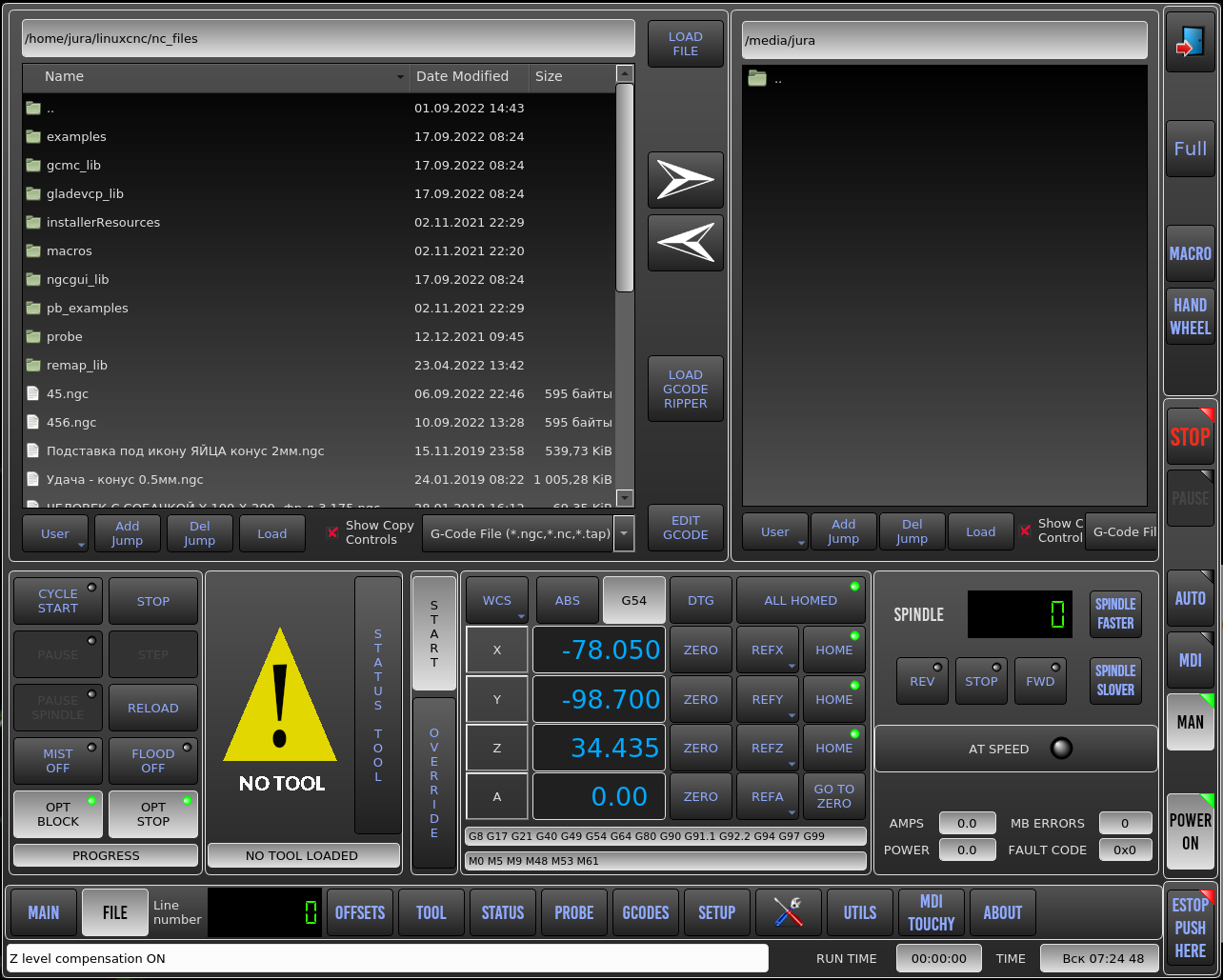

05 Jan 2023 22:06 #261041
by hottabich

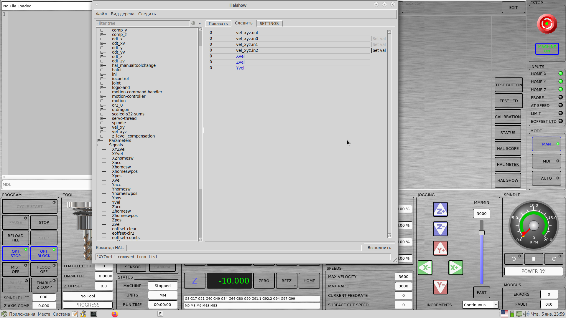

Hello! How can I add what is in the screenshot to another interface? Thank you!
