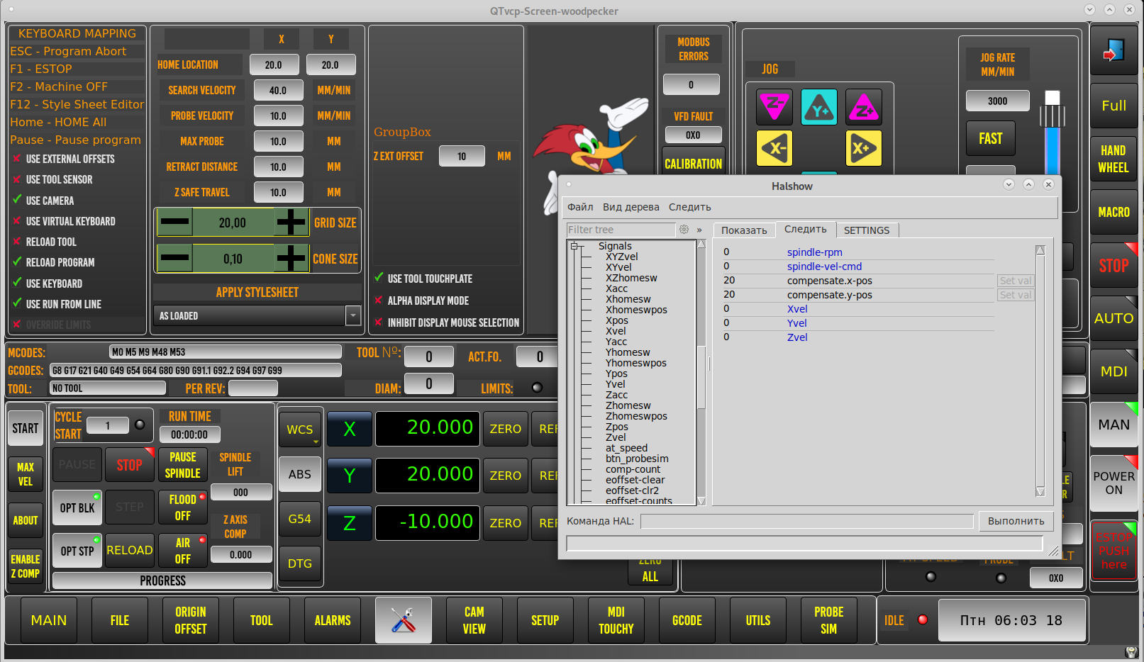

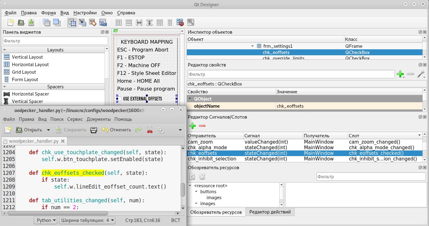

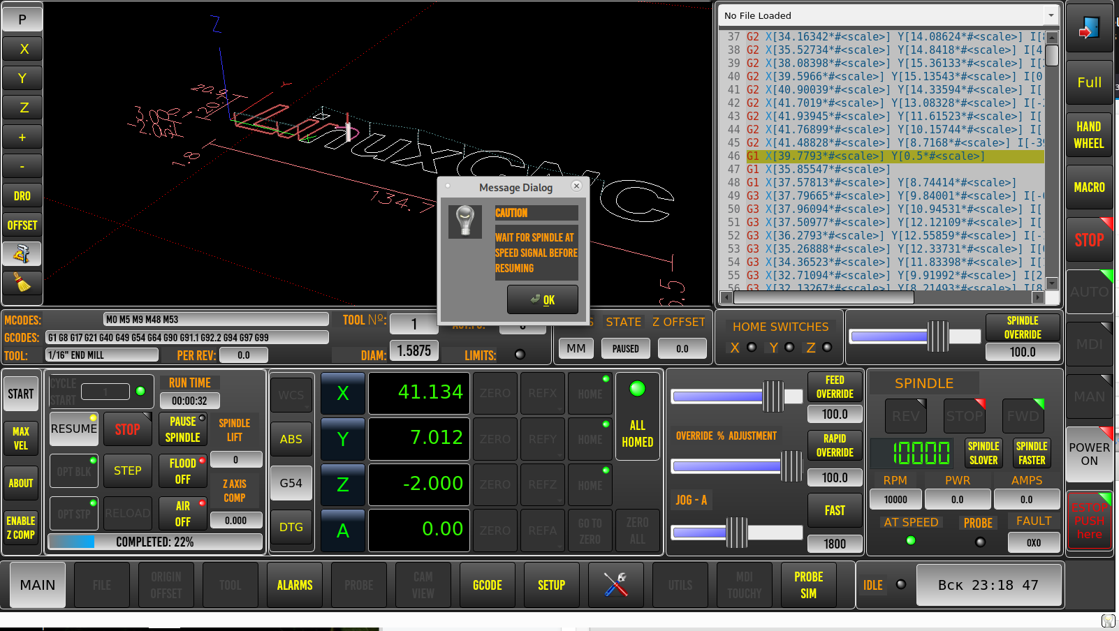

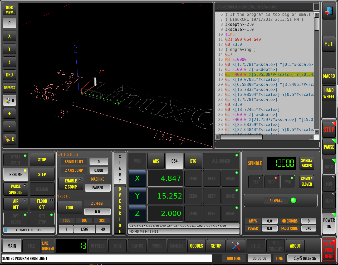

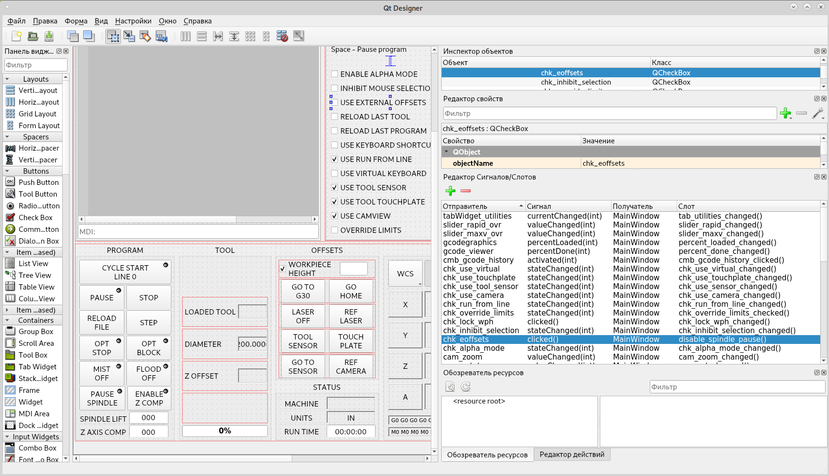

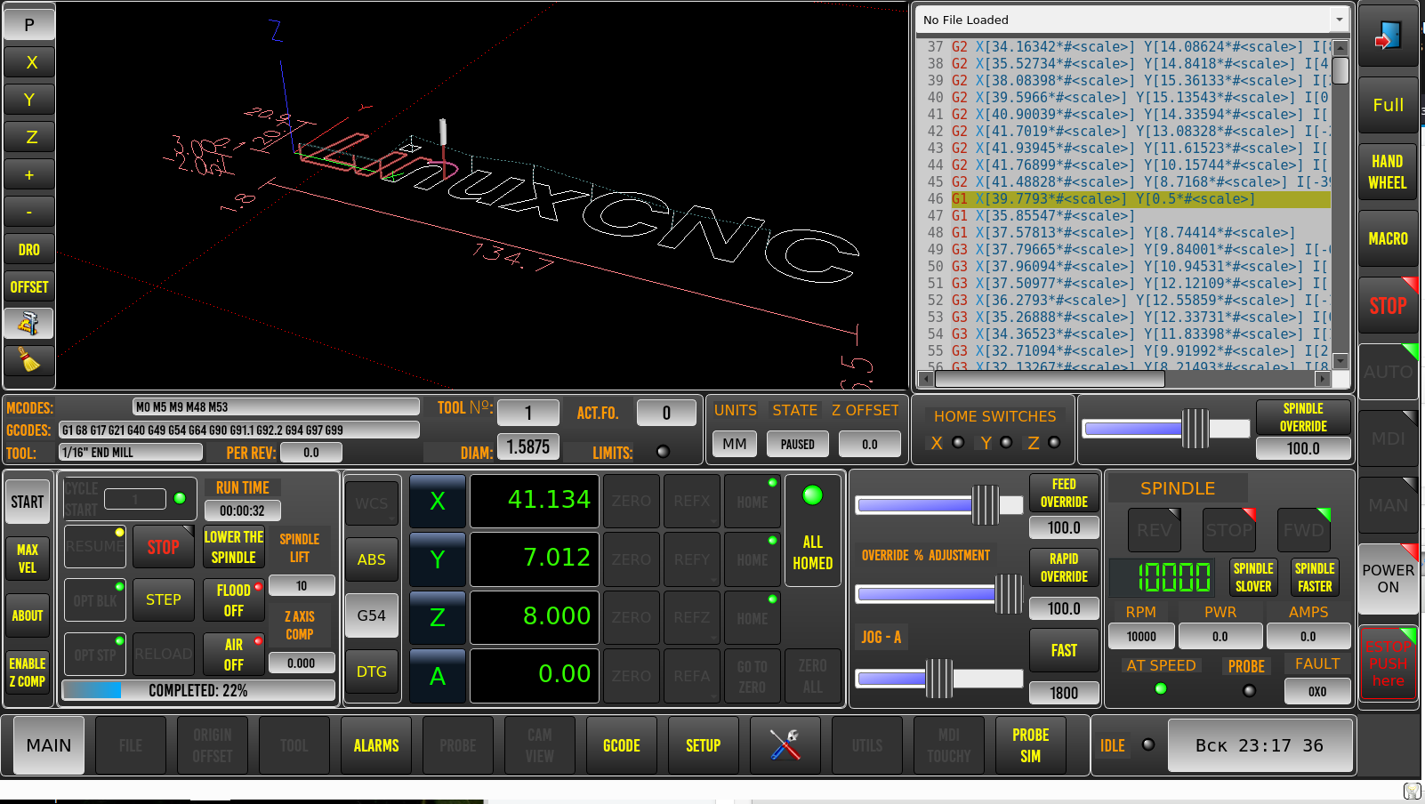

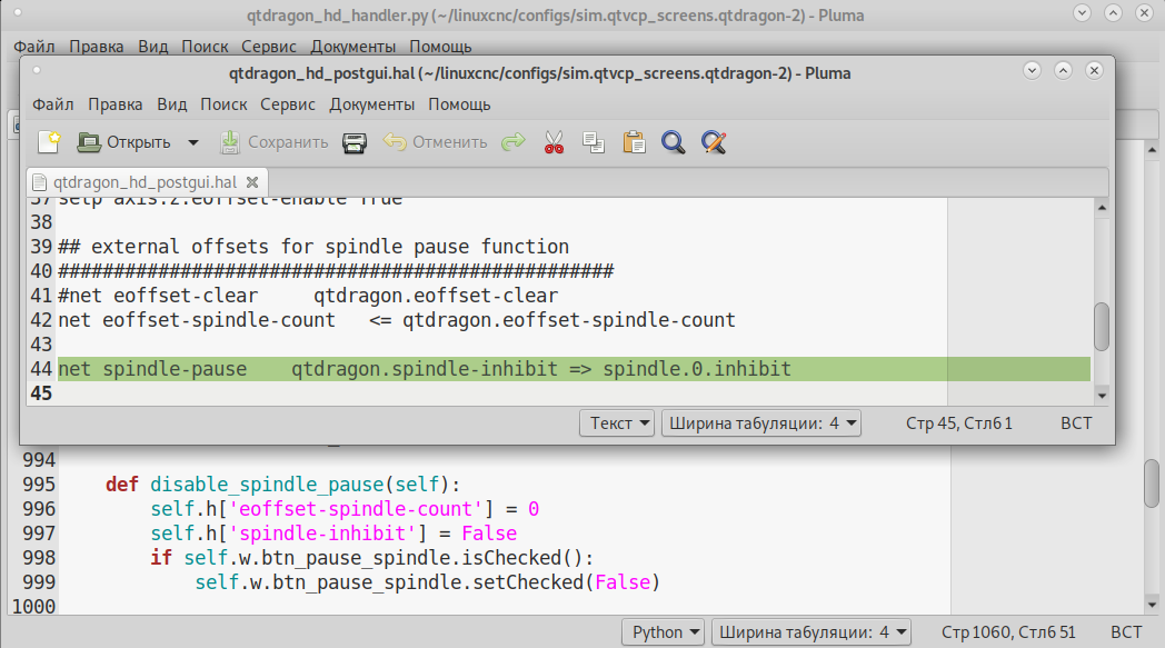

In QtDragon_hd disable_spindle_pause not working screenshot 1, 2. I propose to do as in screenshots 3,4. The btn_pause_spindle button function is disabled.

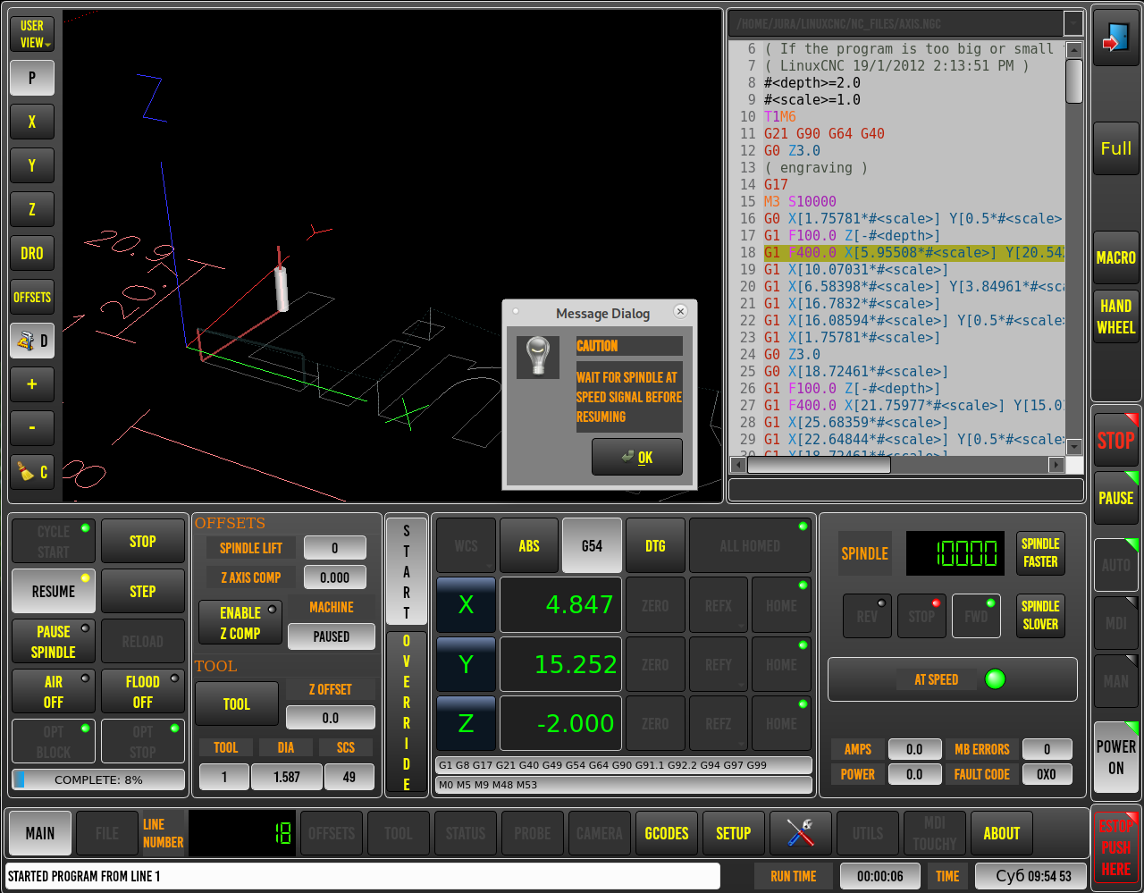

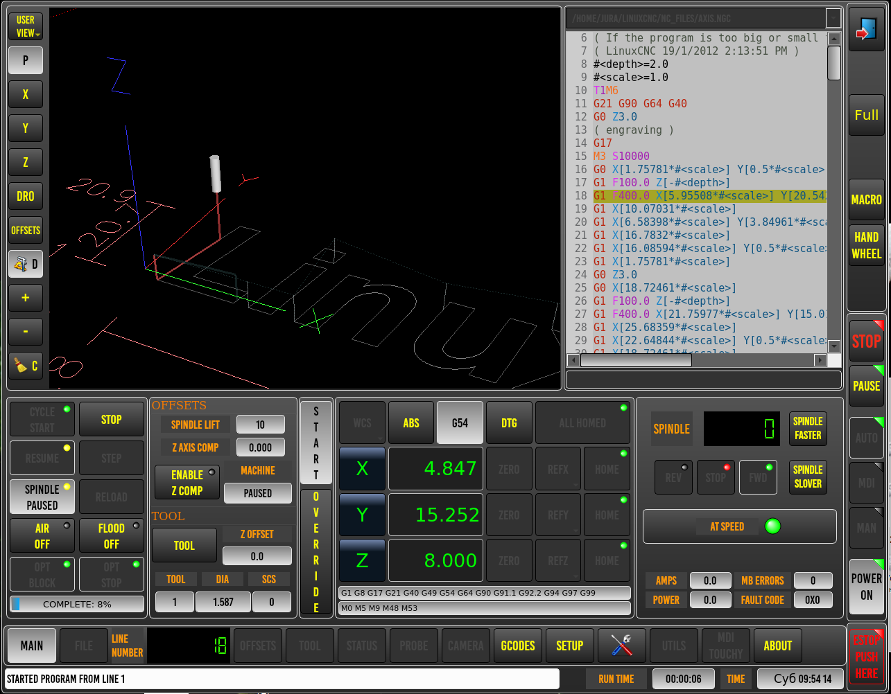

Hello! Is it possible to somehow make the lowering of the tool only after pressing the OK button? Please tell me. This is necessary so that the tool does not gain momentum on the surface of the material. Thank you!
- Posts: 7368
- Thank you received: 2181
21 Jan 2023 04:17 #262548
Replied by cmorley on topic Сustomization QTvcp
Probably this function:
I bet you need to set:
self.h = False
then put up the dialog
Then when the dialog returns set:
self.h = 0
self.h = True
Please let me know if you try it.

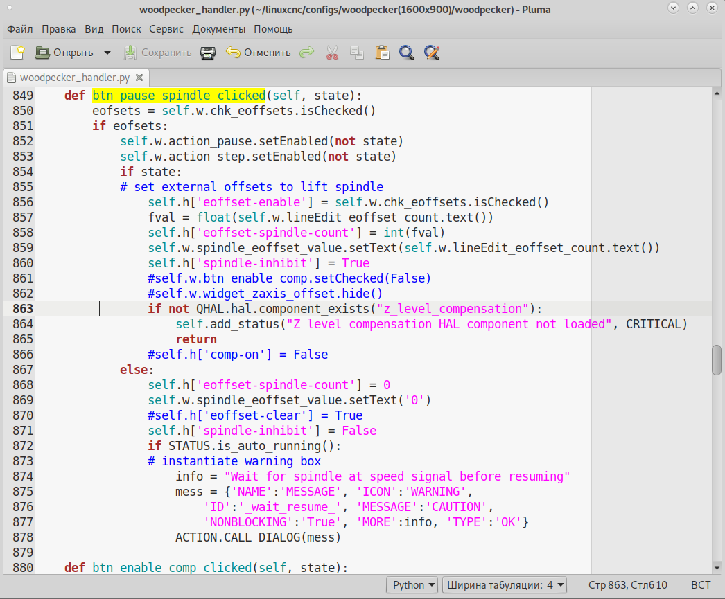

Here is the code:It is necessary to enter a delay for lowering the spindle ( G4 P5) or lowering after the OK dialog. Thank you for your attention.

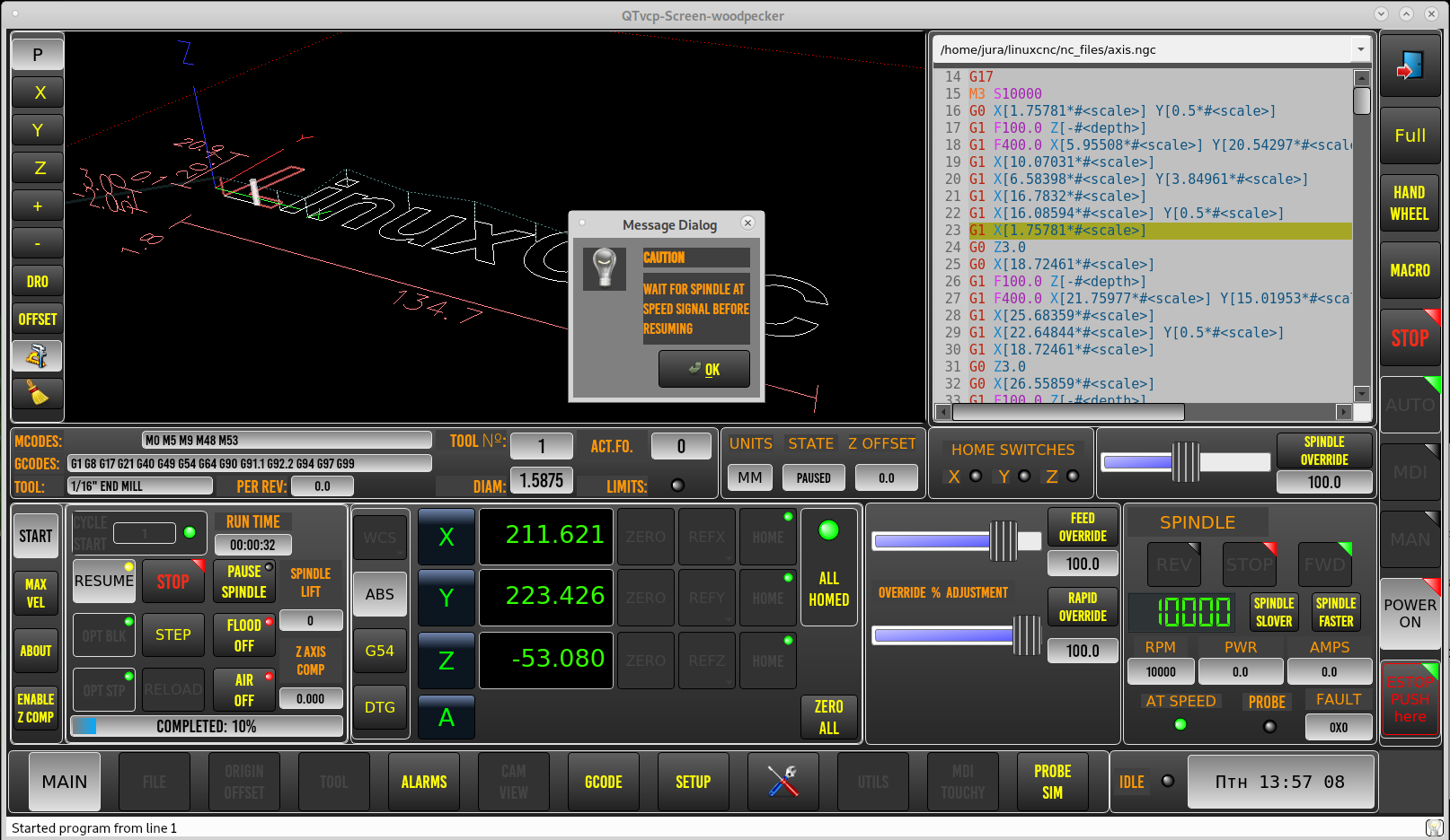

Everything worked out. I created a separate button for lowering the spindle. With chk_eoffsets non checked btn_pause_spindle no activated. I am attaching the code.
