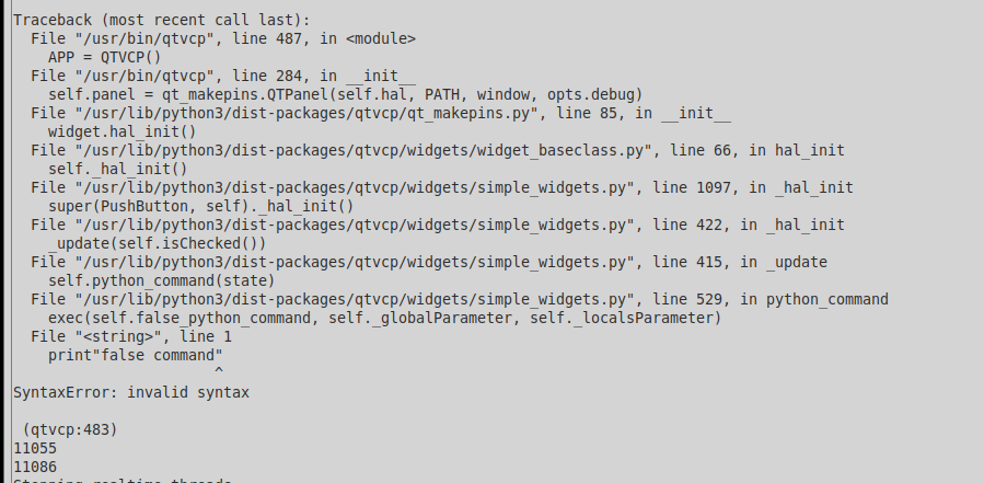

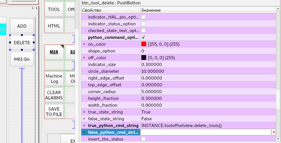

11 Jan 2022 04:11 #231423
by hottabich
Replied by hottabich on topic Сustomization QTvcp
After updating linuxcnc 2.9, an error appeared when opening the interface as in the screenshot. Can this be fixed somehow without the help of a designer?
- Posts: 7368
- Thank you received: 2182
11 Jan 2022 08:03 #231442
Replied by cmorley on topic Сustomization QTvcp
you could use a text editor to edit the ui file.
Looks like the file simple_widgets needs an update too.
change in to print("false command")
- hottabich
- Posts: 574
- Thank you received: 96
11 Jan 2022 08:21 #231447
by hottabich
In the designer, if the python command option is selected for the button, then the false_python_cmd_string field should be empty. I fixed one button and everything works. Thank you so much for the advice.
- Posts: 7368
11 Jan 2022 20:21 #231516
excellent. I will fix the action button print statement thanks.

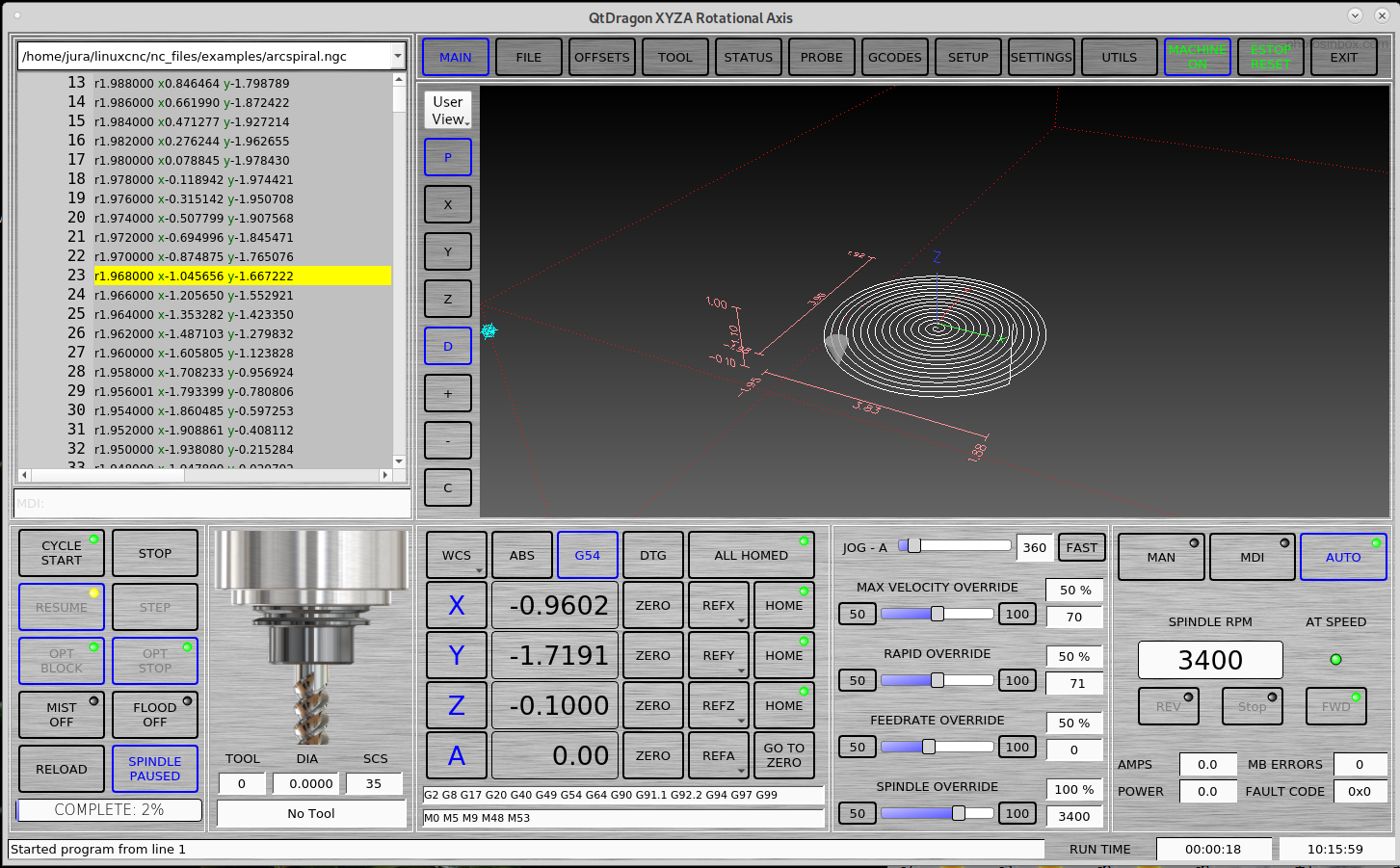

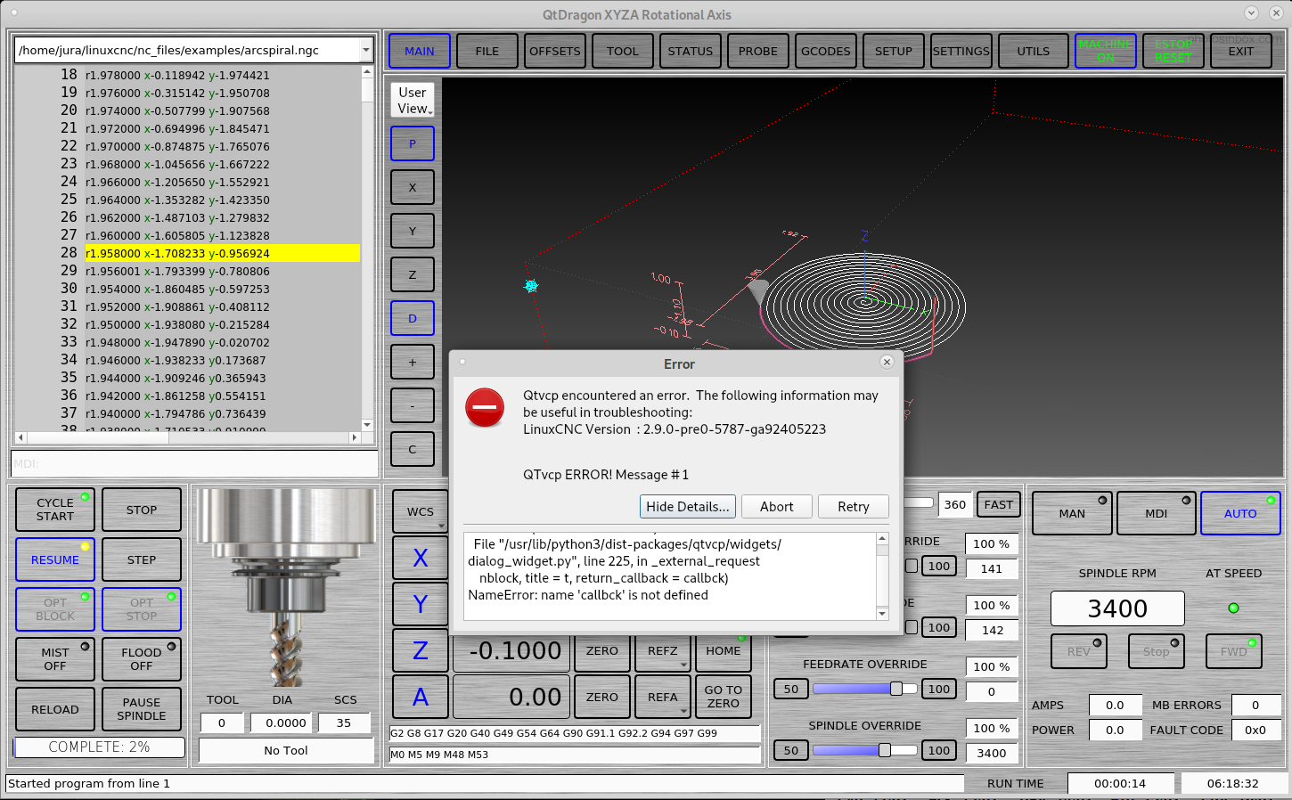

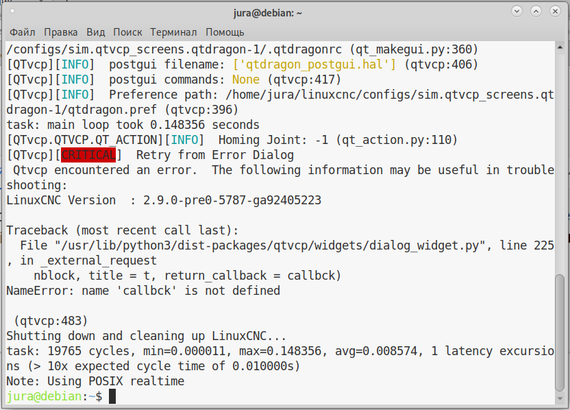

11 Feb 2022 10:32 #234589
by hottabich
After updating linuxcnc 2.9.0 pre. does not work
Pause Spindle function. Error as in the screenshot.
- Posts: 7368
11 Feb 2022 16:10 #234617
Ok I pushed the fix to master.
Please let me know if that fixes it.
