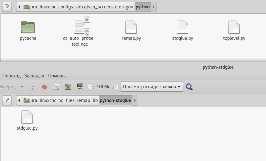

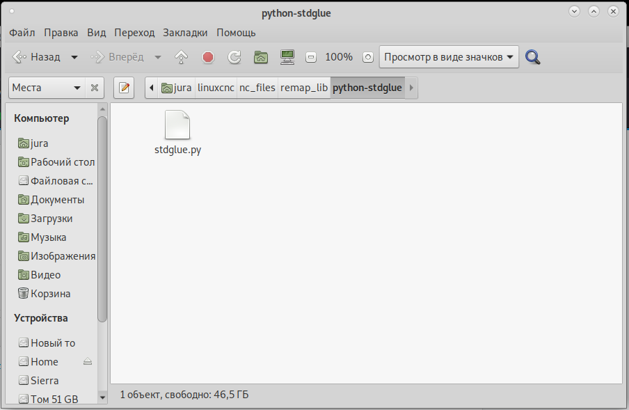

SUBROUTINE_PATH = /home/jura/linuxcnc/nc_files/probe/basic_probe/macros:/home/jura/linuxcnc/nc_files/examples/remap-subroutines:/home/jura/linuxcnc/nc_files/remap_lib. Can't see stdglue.

try:
/home/jura/linuxcnc/nc_files/remap_lib/python_stdglue

21 Jul 2022 10:03 - 21 Jul 2022 10:04 #247953
by hottabich
Replied by hottabich on topic Сustomization QTvcp
try:
It did not help. The error disappears if you replace the stdglue.py file from the bottom up as in the screenshot.

- Posts: 7368
- Thank you received: 2182
21 Jul 2022 15:01 - 21 Jul 2022 15:03 #247986
Replied by cmorley on topic Сustomization QTvcp
The problem I think is python_stdglue vrs python-stdglue
But adding the file to the configuration folder works too.

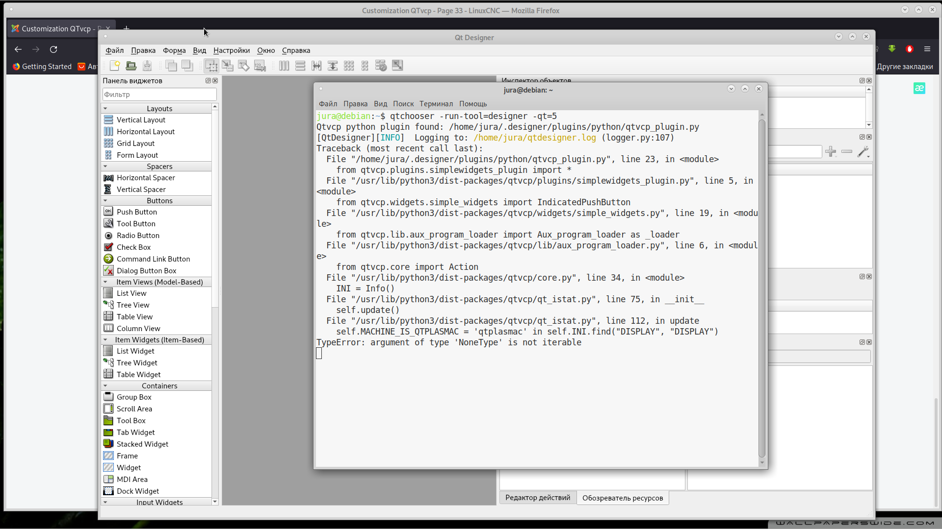

Widgets won't open in designer after update. How to fix it? Thank you!

22 Jul 2022 01:30 #248008
I pushed the fix just now. Thank you.

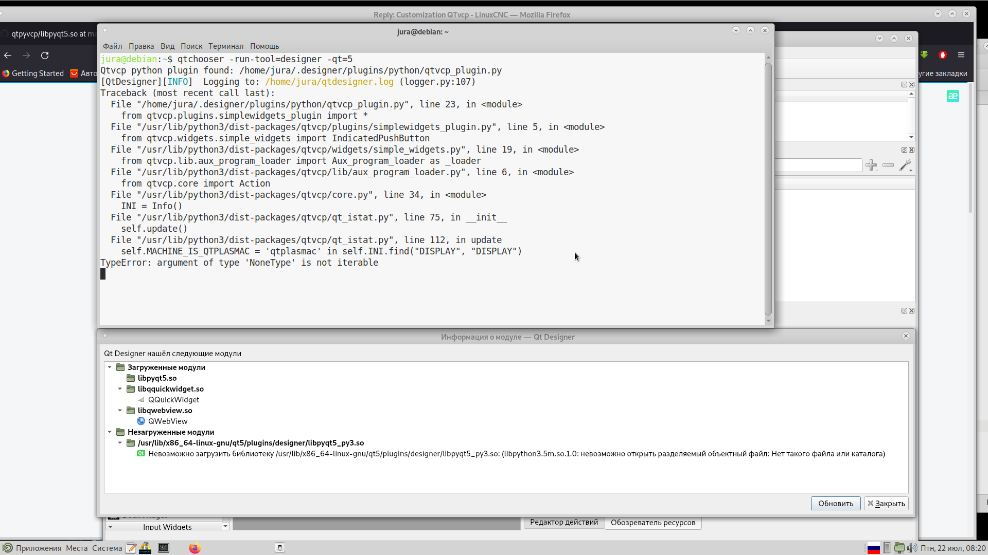

22 Jul 2022 11:43 #248053
by hottabich
Just updated linuxcnc no widgets.

22 Jul 2022 13:50 #248060
can you post the terminal printout?

22 Jul 2022 14:24 #248066
by hottabich
Here you are.

22 Jul 2022 14:50 #248068
I guess the updates haven't come through in master yet then.
here is the code if you would like to edit yours locally:
github.com/LinuxCNC/linuxcnc/blob/master...vcp/qt_istat.py#L112
