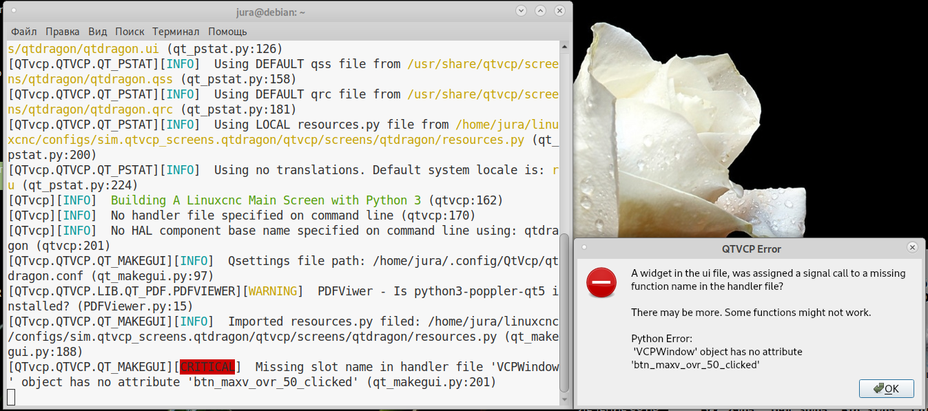

28 May 2022 05:53 - 28 May 2022 05:55 #244048
by hottabich
Replied by hottabich on topic Сustomization QTvcp
Hello! I want to slightly change Qt Dragon in linuxcnc 2.90 pre. I get an error like in the screenshot. I just removed the buttons macro. Please tell me how to fix this? Thank you!
Last edit: 28 May 2022 05:55 by hottabich.
- Posts: 7368
- Thank you received: 2182
28 May 2022 13:35 #244070
Replied by cmorley on topic Сustomization QTvcp
This seems unrelated to macro buttons.
You have changed the name of the function called by the button 'btn_maxv_ovr_50"
from:
btn_maxv_50_clicked
to:
btn_maxv_ovr_50_clicked
and that function name is not in the handler file
from:
btn_maxv_50_clicked
to:

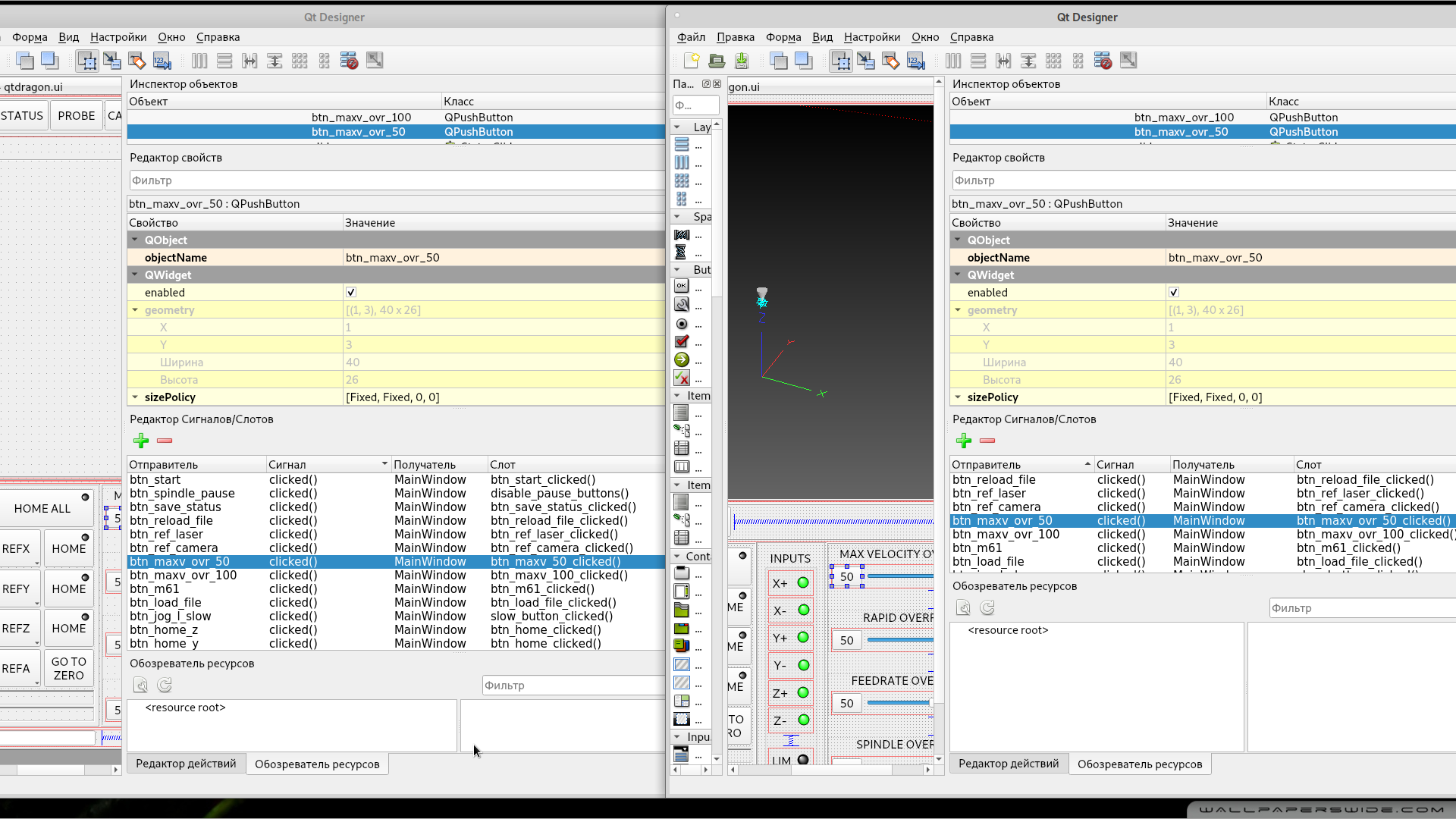

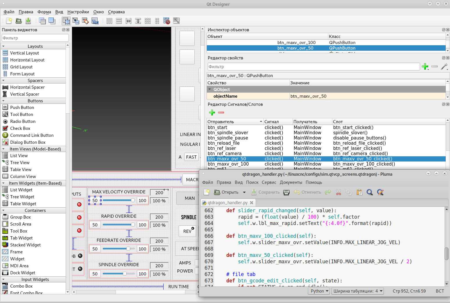

- hottabich
- Posts: 574
- Thank you received: 96
28 May 2022 14:30 #244073
by hottabich
Thanks, but it's not clear, is everything the same in the designer and hasn't changed in the handler?
- Posts: 7368
28 May 2022 16:05 #244077
Cnot:
The function name is different in Designer
