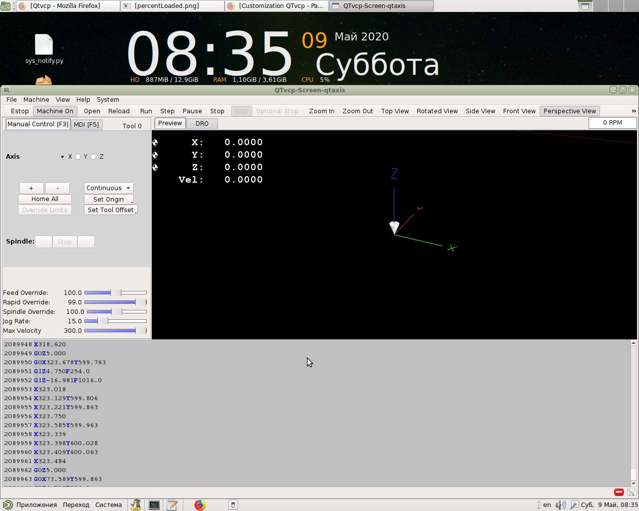

Updated linuxcnc. There is no percentLoaded signal in the designer. Qtaxis does not render the downloaded file. What am I doing wrong?
- Posts: 7368
- Thank you received: 2181
09 May 2020 05:48 #167100
Replied by cmorley on topic Сustomization QTvcp
Then you haven't got the updates yet.
Maybe the buildbot hasn't built them yet..

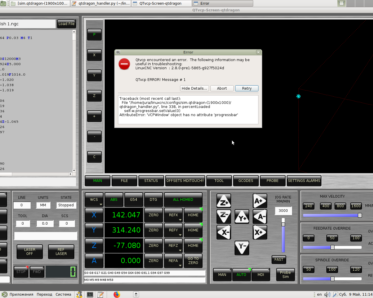

Did as in the screenshot. Got an error. Where am I wrong?
Last edit: 09 May 2020 10:06 by hottabich.
- Posts: 7368
09 May 2020 10:27 #167136
in .ui the widget is called progressBar, in handler progressbar

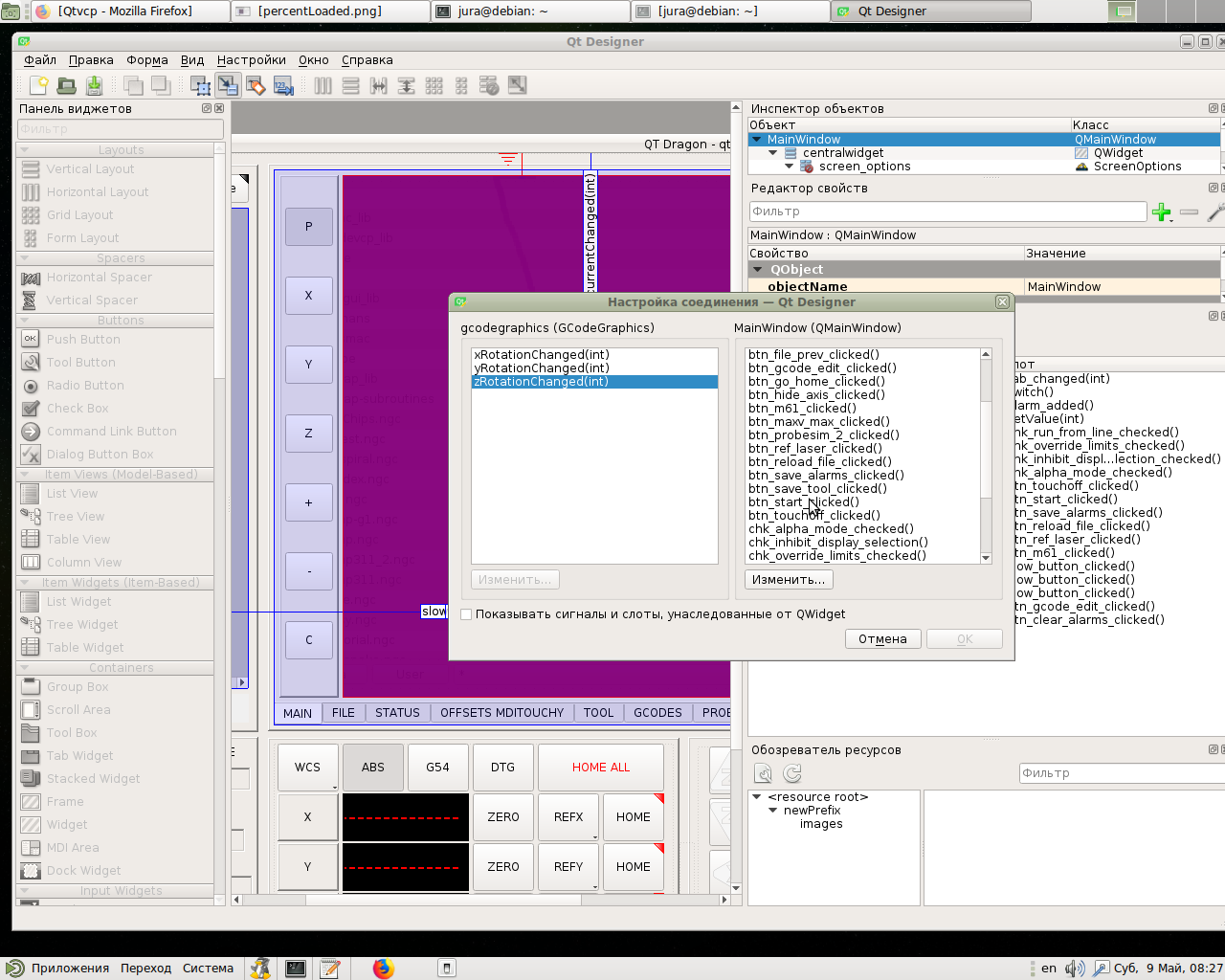

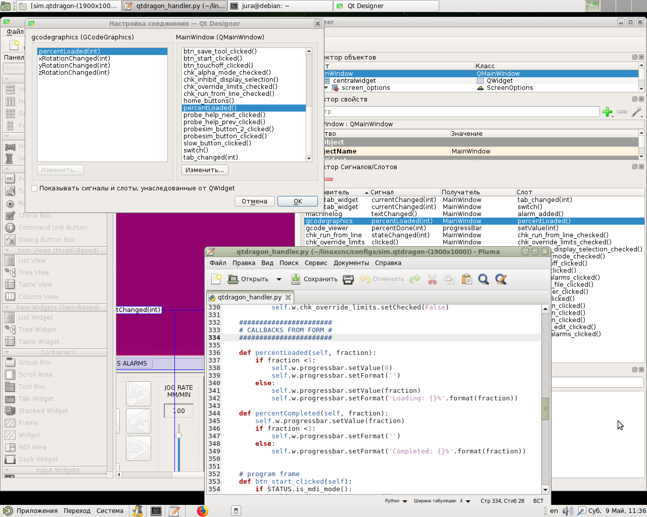

Thank you fixed it when, loading it works fine but when executed it does not display percentages, but filling is in progress.
- Posts: 7368
09 May 2020 13:08 #167143
There is a signal from the gcode editor 'percentDone'
use the same process to connect it in designer to the percenetDone function in the handler file.
- hottabich
- Posts: 574
- Thank you received: 96
09 May 2020 13:31 #167144
by hottabich
Replied by hottabich on topic Сustomization QTvcp
Connected, everything works !!! Respect and respect to you!
