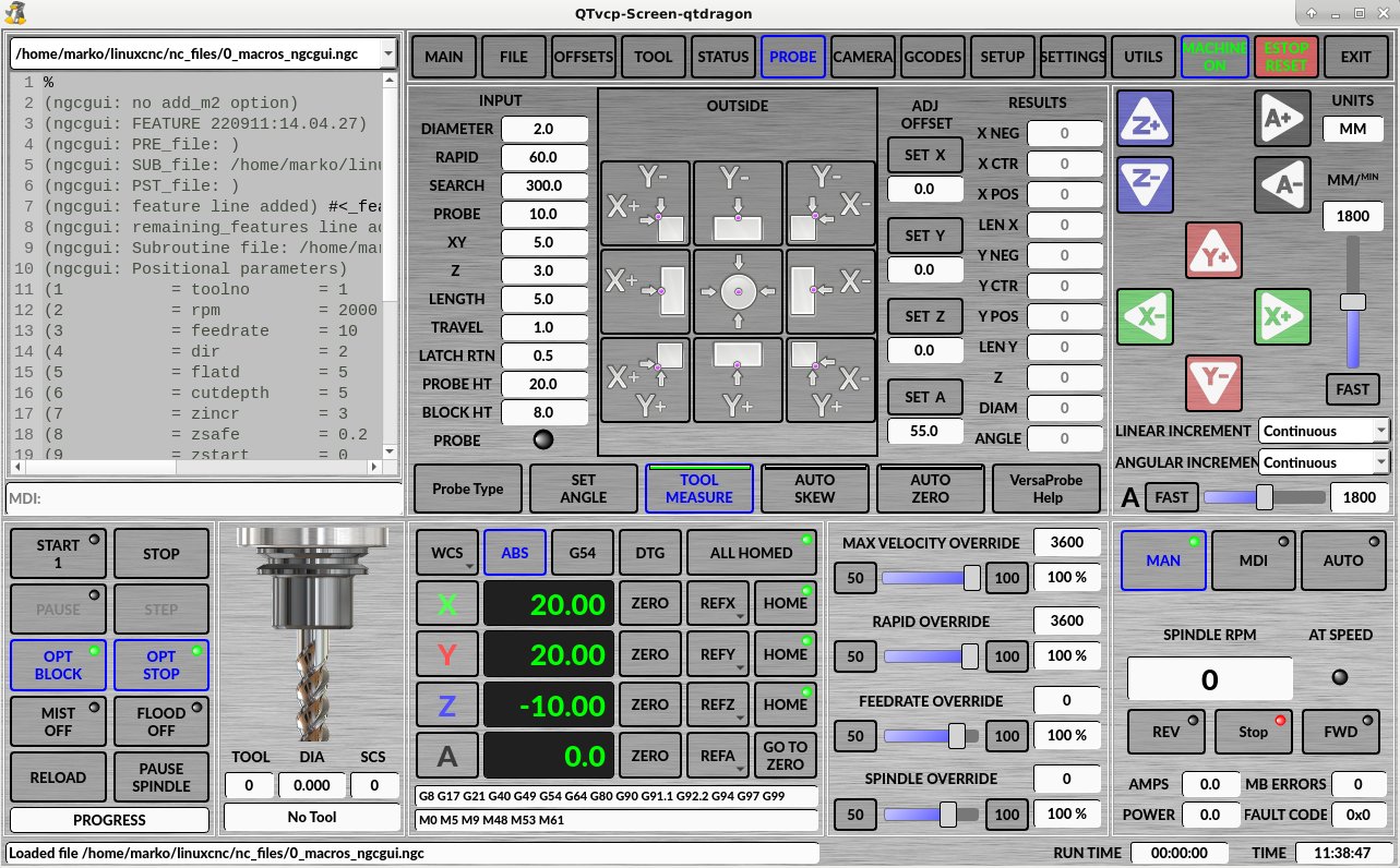

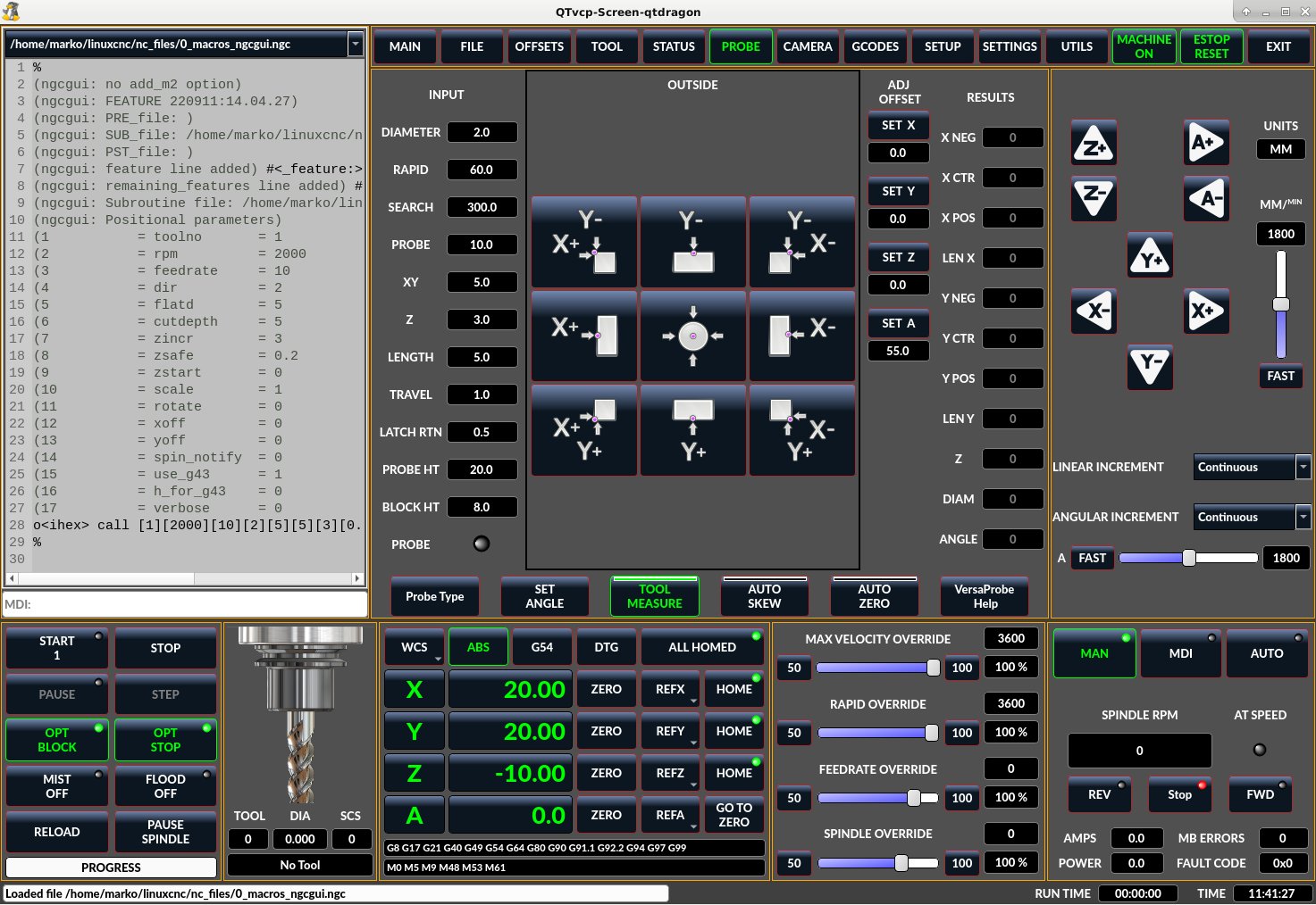

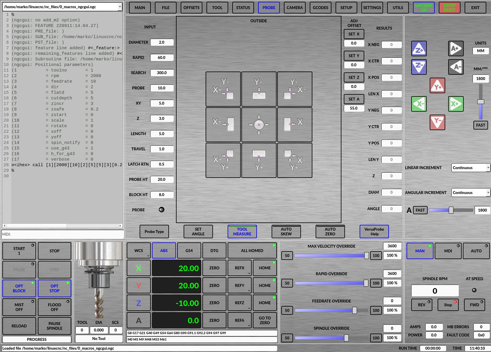

hello
After some initial testing it looks like the decimal issue has been resolved, Thanks Chris for your work.
I am sending my versa_probe proposal and some screenshots of what it looks like with qtdragon minimum size and maximum size.
It's very hard to make the buttons keep the proportions of the square, it would require more code rework, but I think it's not bad.

15 Jan 2023 00:04 #261998
by Roguish
Replied by Roguish on topic Error in tool_offsetview.py
I like that image34. looks nice.
don't worry too much about the exact scaling/stretching of the probe images. they are just that, images, representations.....

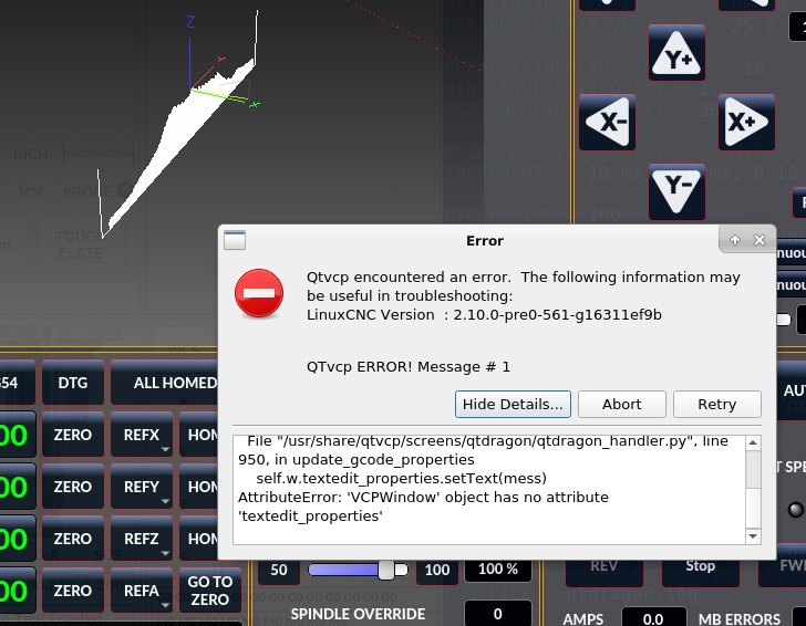

After the last update, an error appears when opening the file, as in the screenshot, probably because the properties tab in setup has disappeared. This tab was nice, it showed the execution time of the file, probably not very accurately.. Where can you see the code that calculates the duration? Maybe it could be used to calculate the current time to the end of the job?
- Posts: 7368
- Thank you received: 2181
18 Jan 2023 01:57 #262305
Replied by cmorley on topic Error in tool_offsetview.py
I did not remove the properties tab from setup.
Do you have an old .ui file being picked up? (looking in the terminal will tell you)
Estimation will be horribly wrong with short move gcodes.

18 Jan 2023 11:38 #262332
by MarkoPolo
Replied by MarkoPolo on topic Error in tool_offsetview.py
After the next update it's ok

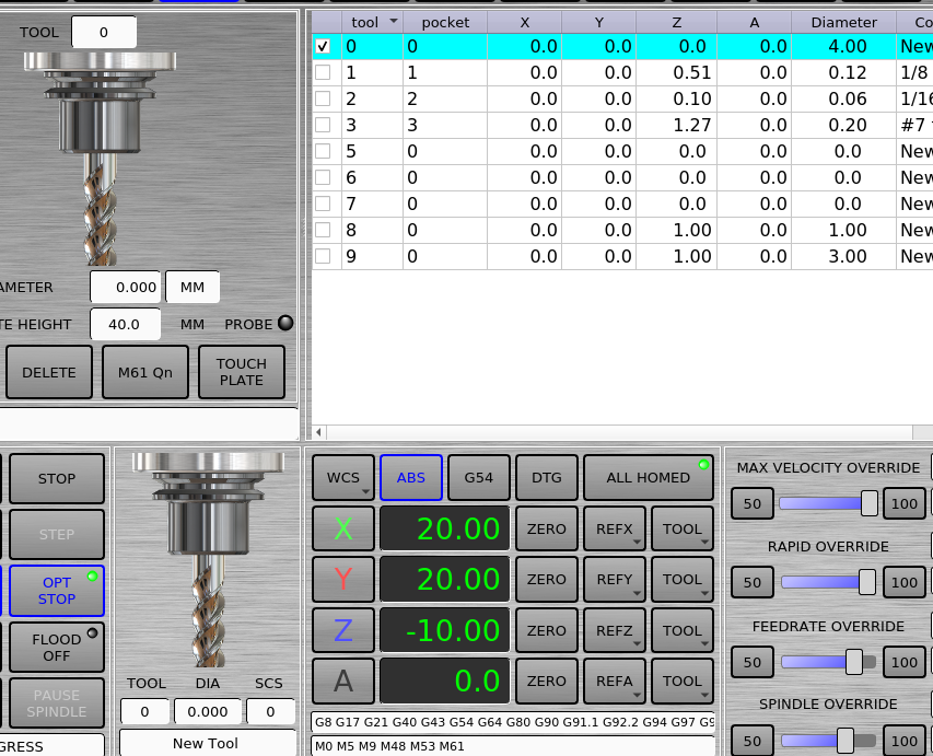

Long time no changes to qtdragon so I have two minor things.Minor fixes to the brushed_metal_color theme, and a problem with displaying the diameter of the tool if the tool is number 0.I don't know if it should be numbered from zero, but I guess so, since you can choose such a number. The problem is that the diameter fields show 0 instead of the correct tool value as in the screenshot.
