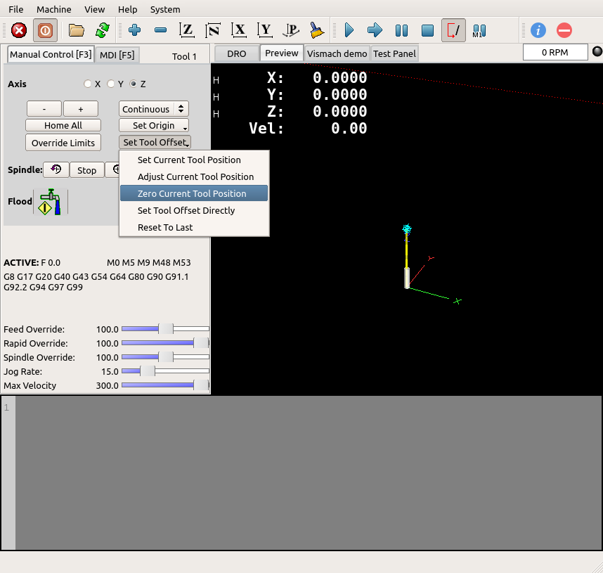

I do not use 'auto tool measurement.' But I do use tool length offsets, with the master tool length procedure. This is easily done in axis with the tool 'Touch Off' button.' And with G43 Hx for tool Tx. Ok, just checked. I use the 'Tool touch off to workpiece' at the present.
So, how ever, what ever, is going on in axis with the touch off button, it sure would be nice to have the same functionality in dragon, with a similar button. In the supplied version, not a customized version....
I have some machining to do, so yesterday I was able to get axis running and probing correctly by using some of probe routines in the source (I think you use them in the basic probe and versa probe) via ncggui. and the Touch Off button.
Note, I made a few minor changes in the probing routines that I use to avoid the aio errors, and some odd movements. I can explain and illustrate later.
But I would really like to use qtdragon, and need the Touch Off button. please.

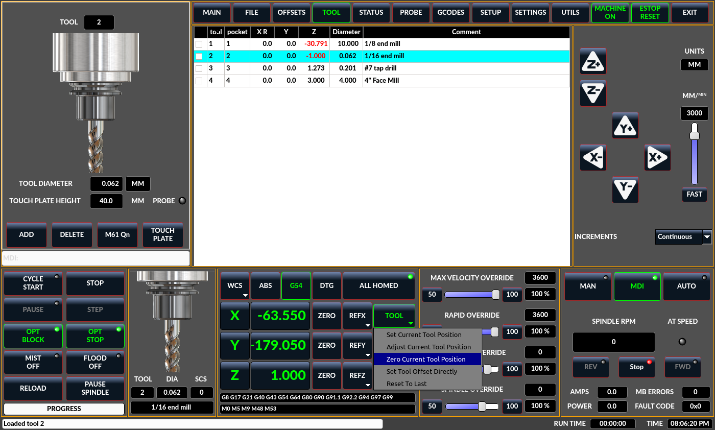

Did you notice the button added on the image? I think that is convenient - how about you?
The tool offset button only shows when the tool tab is selected though - otherwise it's the homing button. (I haven't pushed this work yet)

Yes all axes
Almost ready to push.
