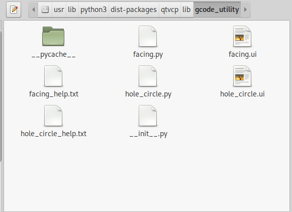

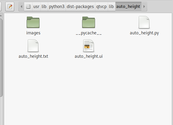

It doesn't work in the "probe" and "utils" tabs yet, but it needs to be changed in other files, I don't know where.

Perhaps this will help you.

I corrected the rest of the files and now everything works fine in the whole qtdragon.
