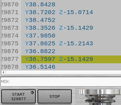

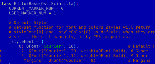

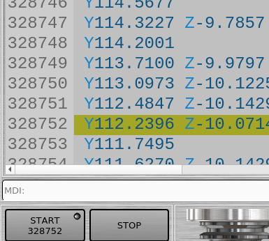

14 May 2023 14:38 #271343
by MarkoPolo
Replied by MarkoPolo on topic Error in tool_offsetview.py
Hi Chris
zooming in and out of the gcode window view is nice but it doesn't work very well because it doesn't enlarge the area with the line numbers and doesn't fit the numbering when zoomed in.
If I change the font size in gcode_editor.py then it works fine as in the attached picture.
So the idea is to change the font size by changing
font size in gcode_editor.py.
I tried to do it with the + - buttons in qtdragon, but I can't get to the font size value in gcode_editor.py.
Maybe you could look at it?

14 May 2023 17:39 #271357
Replied by cmorley on topic Error in tool_offsetview.py
Zooming margins fixed.

14 May 2023 18:45 #271364
by MarkoPolo
Great. I already had time to test, zooming
windows gcode works fine.
Yes, only now I see that the text disappears after the time in the status bar. This may be so, although some information may be useful, e.g. "Run timer stopped at 00:02:14" after stopping, or add some basic information in its place, e.g. about the current working mode.. ? (still to be considered)

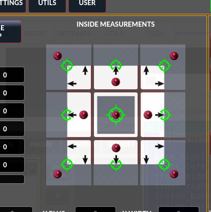

There was some free space on the bottom bar of the bar, so I added a 'machine' status, if it's useful, you can make changes.
Someone on the forum suggested replacing the probe ball with a ruby one, so I replaced all the balls with ruby ones.
Roguish. You want to achieve high measurement accuracy, I don't know if changing the ball to a ruby one will help but you can try
