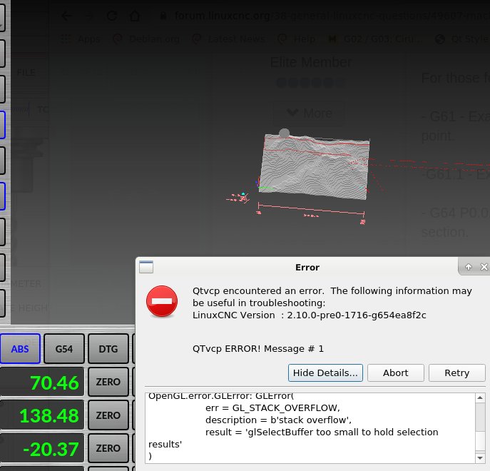

23 Jul 2023 18:08 #276095
by MarkoPolo
Replied by MarkoPolo on topic Error in tool_offsetview.py
Hi Chris
I have an improved brushed_metal_color theme file, and some minor qtdragon related stuff.
1. If the "inhibit mouse selection" option is unchecked in the settings and the preview is sufficiently far away, if you want to select some lines, an error appears, as in the screenshot. In the file /usr/lib/python3/dist-packages/OpenGL/GL/pointers.py on line 258, if the value of result is less than zero, this error occurs. I suspect that this is not a common case, but it could be improved.

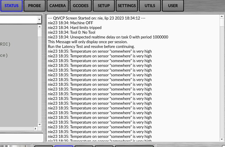

2. In the status, it would be nice if the scroll bar was at the bottom, i.e. the latest logs would always be displayed, because it is annoying to constantly scroll down.

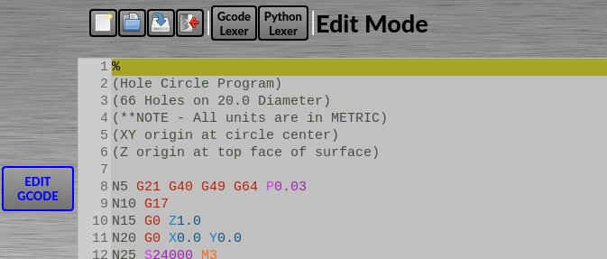

3. When editing gcode files, a file overwrite button would be useful, because sometimes you don't even know what the name of the open file is and which file to overwrite.
Marek

25 Jul 2023 07:25 #276208
Replied by cmorley on topic Error in tool_offsetview.py
Status logs should autoscroll now.
The save dialog should now pre-select the last filename - see if you like that.
Updated the stylesheet (thanks) - I find the gcode hard to read though, I need more contrast.
I'll have to look deeper for the gcode line pick problem.
pushed to 2.9 and master.

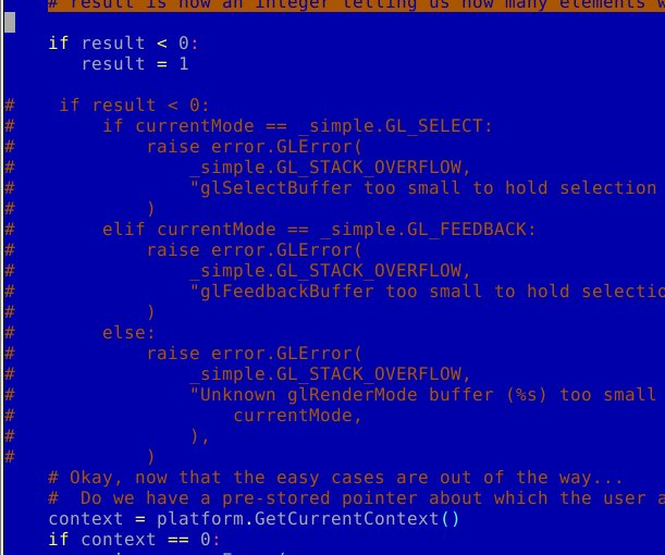

04 Aug 2023 17:57 #276921
by MarkoPolo
Problem number 2 and 3 has been solved, it works fine, thanks for the changes.
As for the pointers.py file, after commenting out the section "if result < 0"
and adding result = 1 action, it works fine. It marks lines even at a great distance and does not cause any errors.
As in the attached screenshot.
