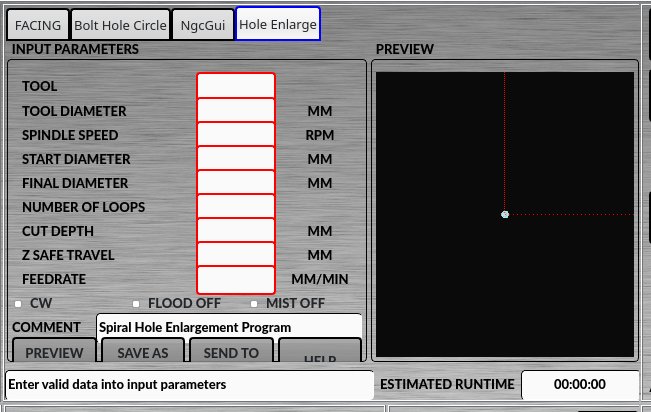

Hi Chris.
Many thanks for such a nice update of the qtdragon_ABOUT file.
As for the button icons, I can add the remaining letters, I just need a simple sketch in which directions the arrows of individual letters should go.

I made the button icons of the remaining letters, see if it can be like that or change something.

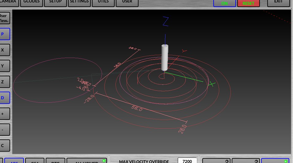

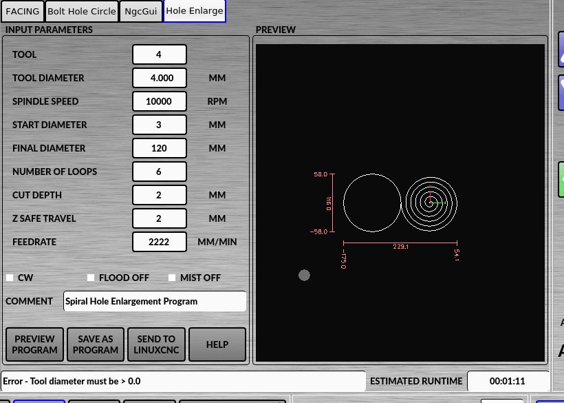

2. The second problem is that if I enter the "start diameter" value smaller than the "tool" value, then the last pass is in the wrong place, as in the screenshot.
If the values are equal, that's also a problem, but a little different.
It would be good to make a security that only an entry greater than the value of "tool" is allowed

Thank you for quick feedback - Jim made the utility for me - he is very good at them!
I pushed a start diameter check and the QValidator changes you posted.
Chris

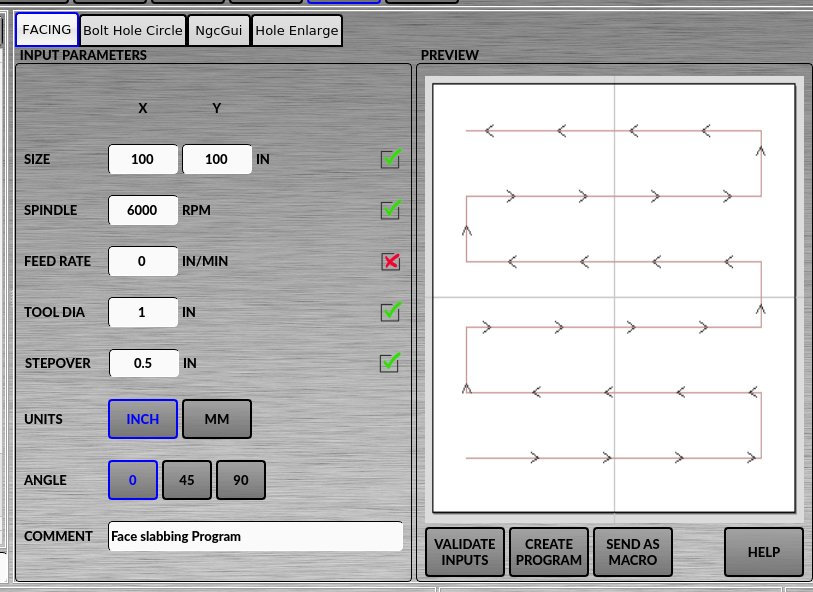

Great, I tested it quickly and it works fine.
Just one more really small thing before I go to sleep.
In the "facing" tool, program startup almost always starts in imperial units, as shown in the picture.
The bolt hole circle tool does not have this problem. You would have to make "facing" run in the units in which the machine is, because you can make a mistake with the dimensions..
(or that only the right button is active, but I don't know if that's a good idea)
- Posts: 7368
- Thank you received: 2181
20 Aug 2023 06:41 #278525
Replied by cmorley on topic Error in tool_offsetview.py
Try replacing the original facing program with this one.
Ultimately maybe the utilities should all just follow the current g20/g21 for consistency?

The modified facing.py now works fine.
I think all tools, as you say, should work only in machine units, but I still have little practical experience, so maybe someone else will comment.

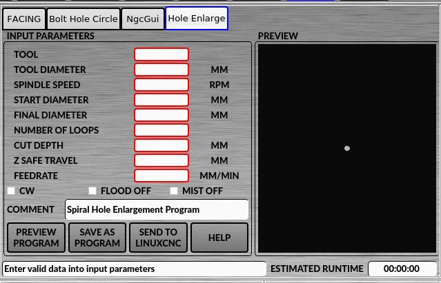

Another problem with the hole enlarger tool is that if you stop the program on the stop button while it is running, then when you start it again, the program does not start at x0 y0 but from where it stopped. Reloading the file doesn't help. Just like in the screenshot.
I modified the hole_enlarge.ui file so that it fits in the minimum size of qtdragon. If there is anything else to improve, please write.
