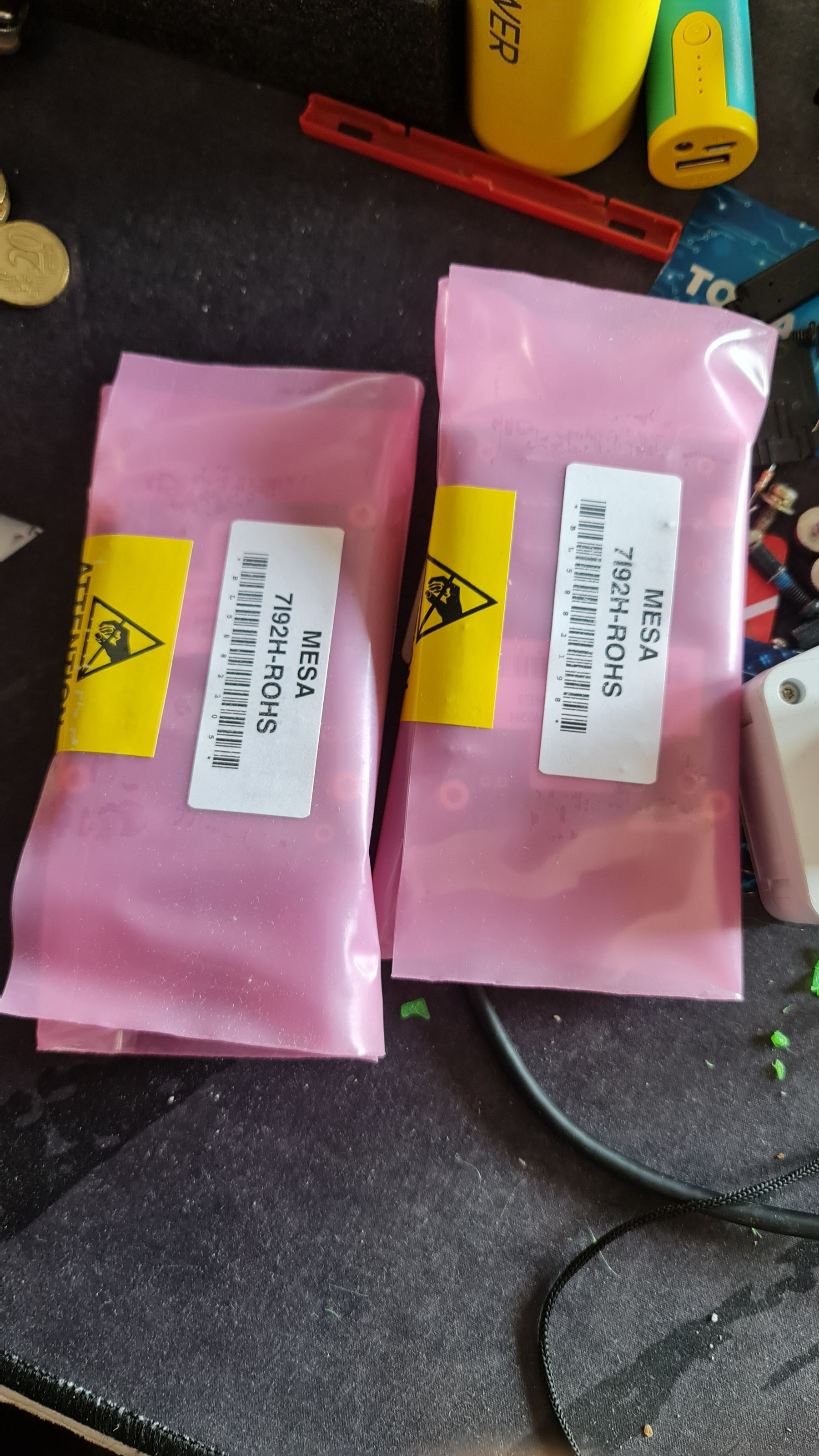

Finaly, got the two Mesa 7i92 from www.eusurplus.com today, tomorrow maybe i also get the 7i95 that is stuck at customs for several days, those m@#$%#
Back to work....
