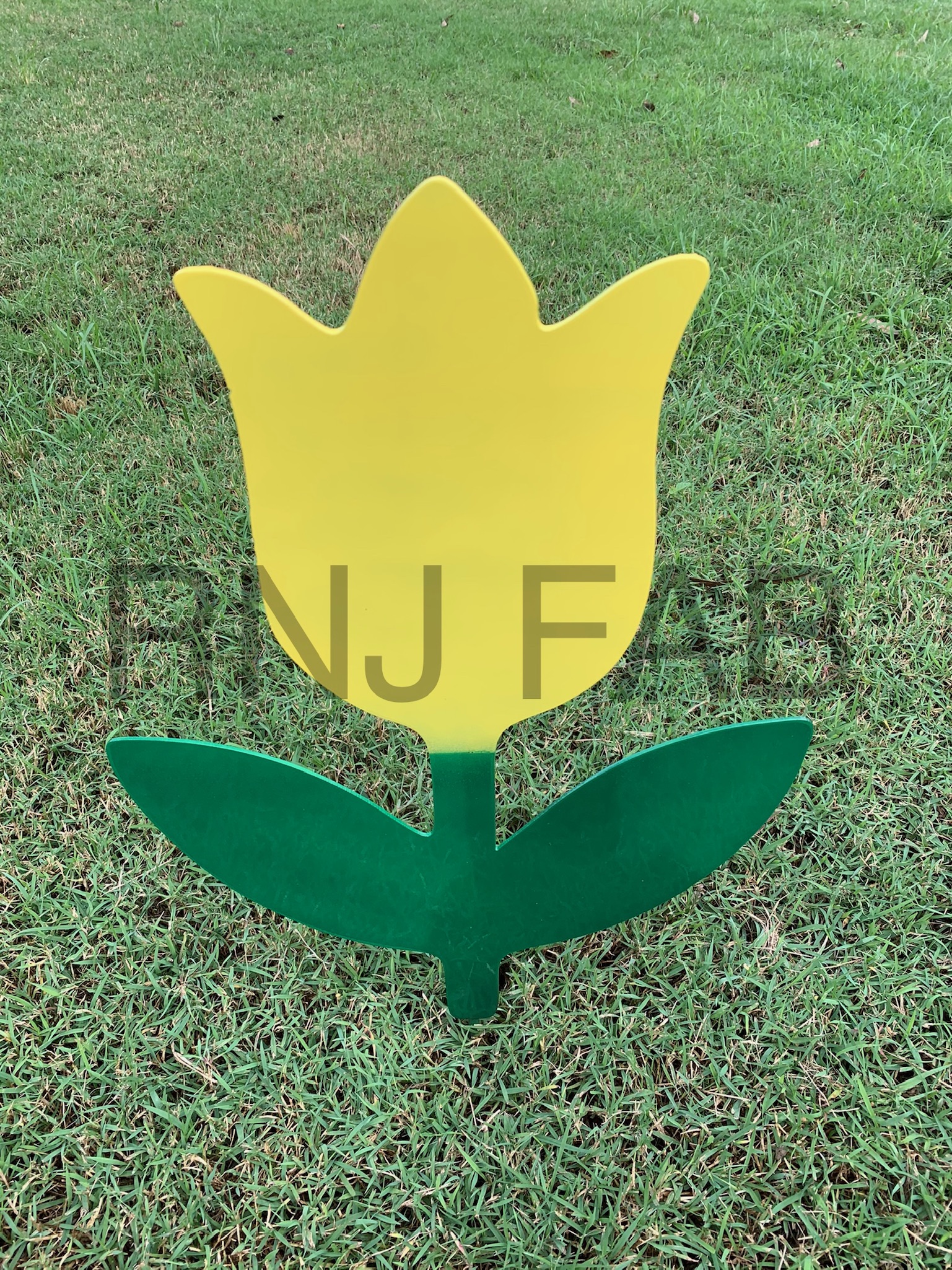

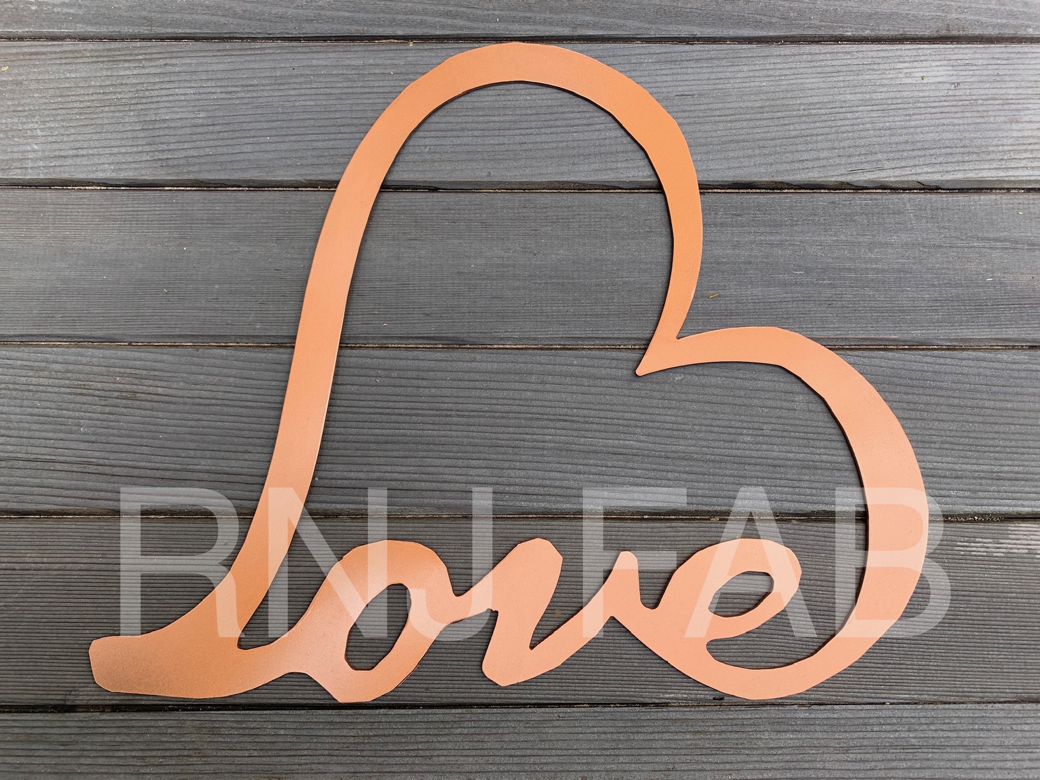

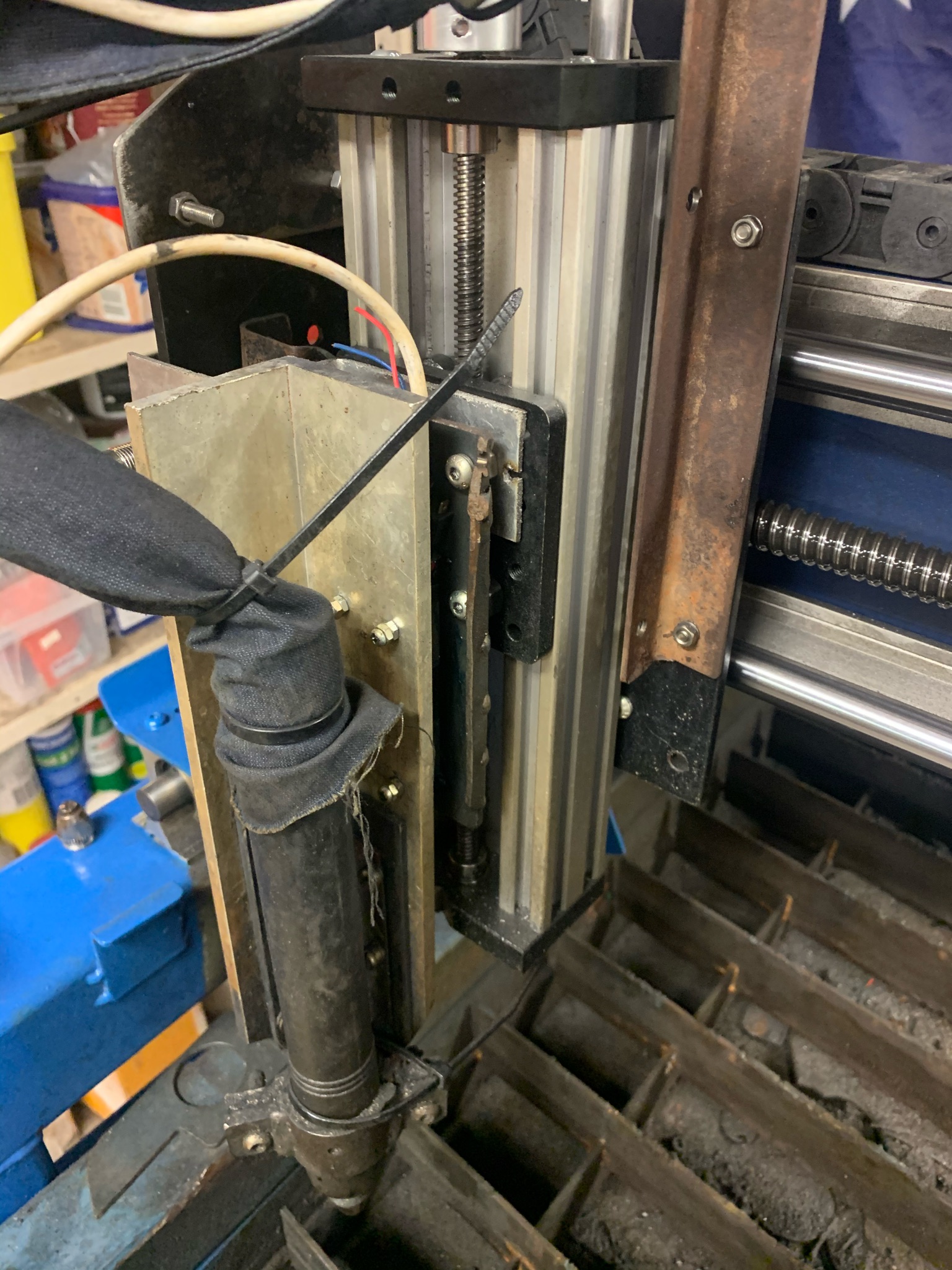

Fast forward a few more weeks and I have been reading lots on this forum, like I must have read hundreds of pages on linux and the different GUI and how to change and edit parts of hal and the reality is I now know just enough to get by, I’m no expert, I’m not even good at it, but I can get by. I have watched every video on you tube that has linux in the title !!!!
With the new MESA board in, new PC, load Debian, load LinuxCNC, test all pin connections on board, full movement control. Good start.
Check output, connect relay, run Plasmac. Great.
Cut. Working. Back to a basic machine, running LinuxCNC (PlamaC), cutting steel.
Then its time to try and work through settings again, lots of reviewing of old photo’s to see if I have screen shots of the settings I had worked out to be best for my setup.
I am still working on these settings and throw trying to setup the THCAD into the mix it making the process a bit longer than it was last time. Rod recommended a few resistors to help reduce the raw arc from the plasma to a point where the THCAD could read it, followed by some creative numbers in the settings have me at a point that I am able to have the THC working. It’s not perfect and I still need to get the settings right, but I’m on the right track.
I know there is lots I have missed and I’ll try and fill some of this in later along with more photos of getting setup when I changed over to Linux.

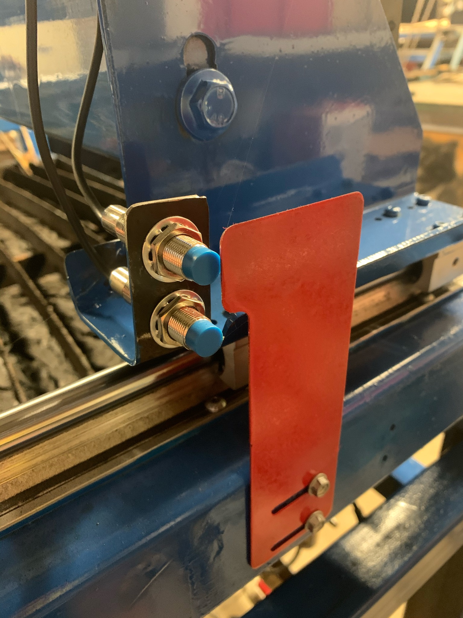

Hmm, this shed did look a bit familiar. Glad you are on track now . Your final home and limit switched look great compared to the dodgy ones we rigged up when I was there.

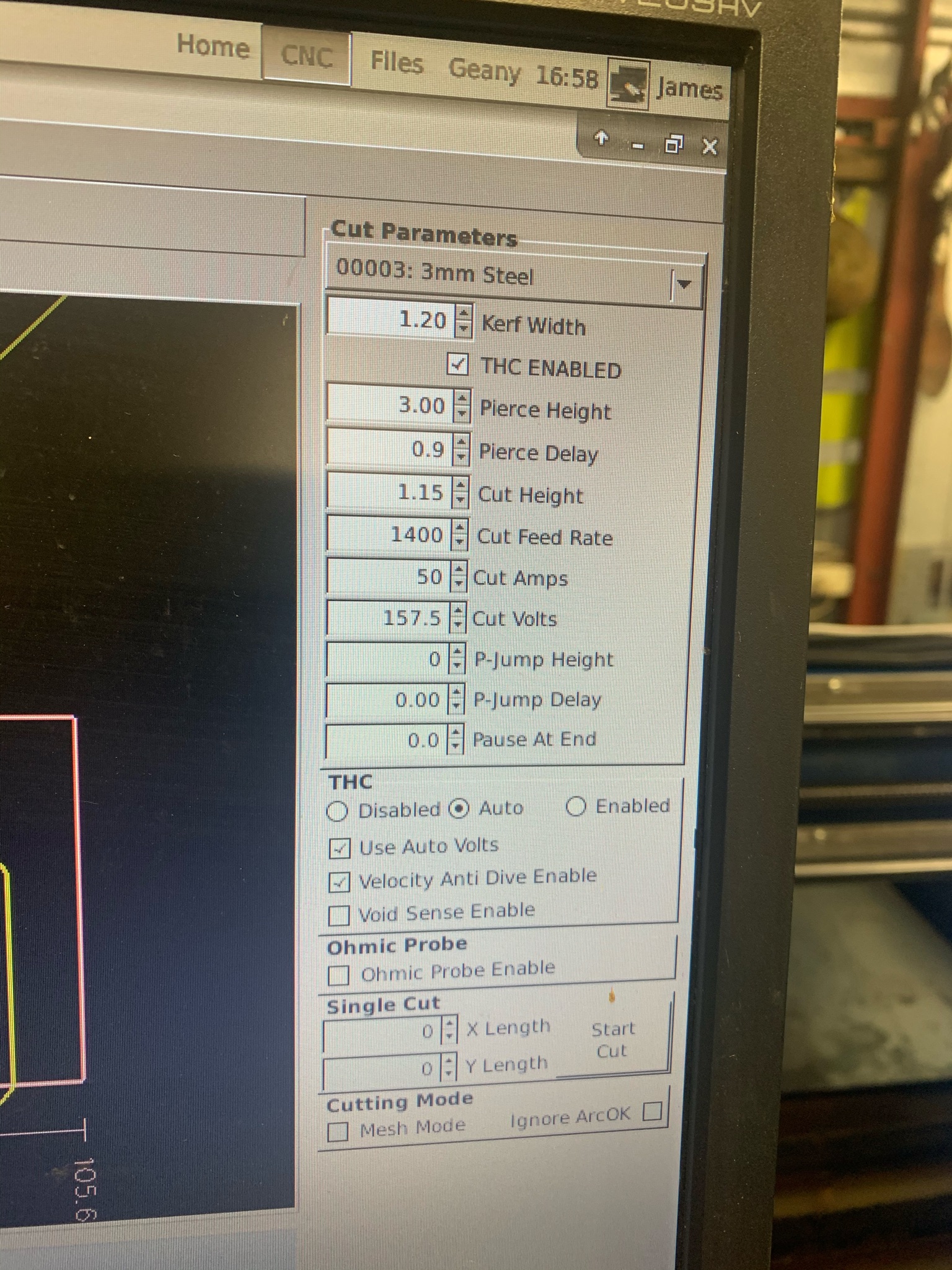

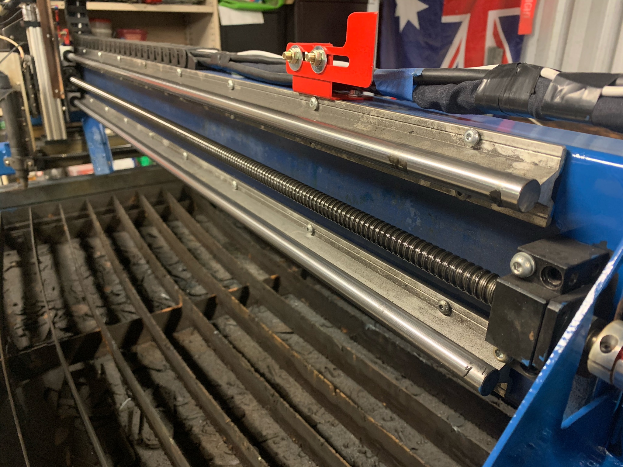

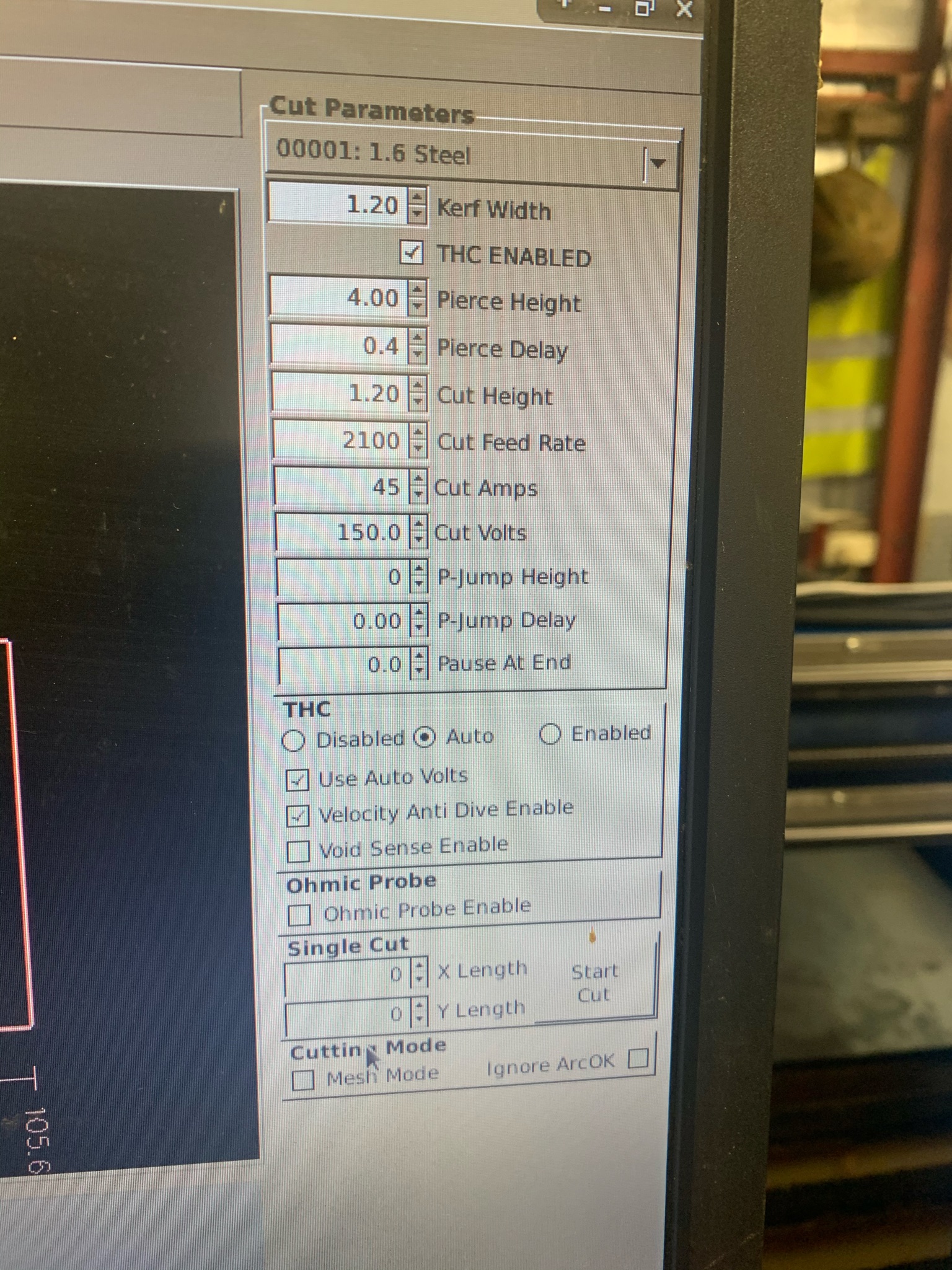

So this is my setup and settings.
MESA 7i96, THCAD10, TB6600 stepper drivers, nema23 motors, Cut50 Plasma.
Plasma connected to the THCAD10 with raw arc through 1K resistors.
Old PC running Debian 10, LinuxCNC, PlasmaC.
PNP proximity sensors (z home, x home & limit, Y & Y1 home and limit), micro switch for probe on floating z axis, 2x e-stops.
Settings in PlasmaC.
I haven't been able to get sheetcam to load yet, yes I have tried to make it an executable file, but it still won't open and I can't find what program will allow it to run.
So for now I'm just transferring the settings.
