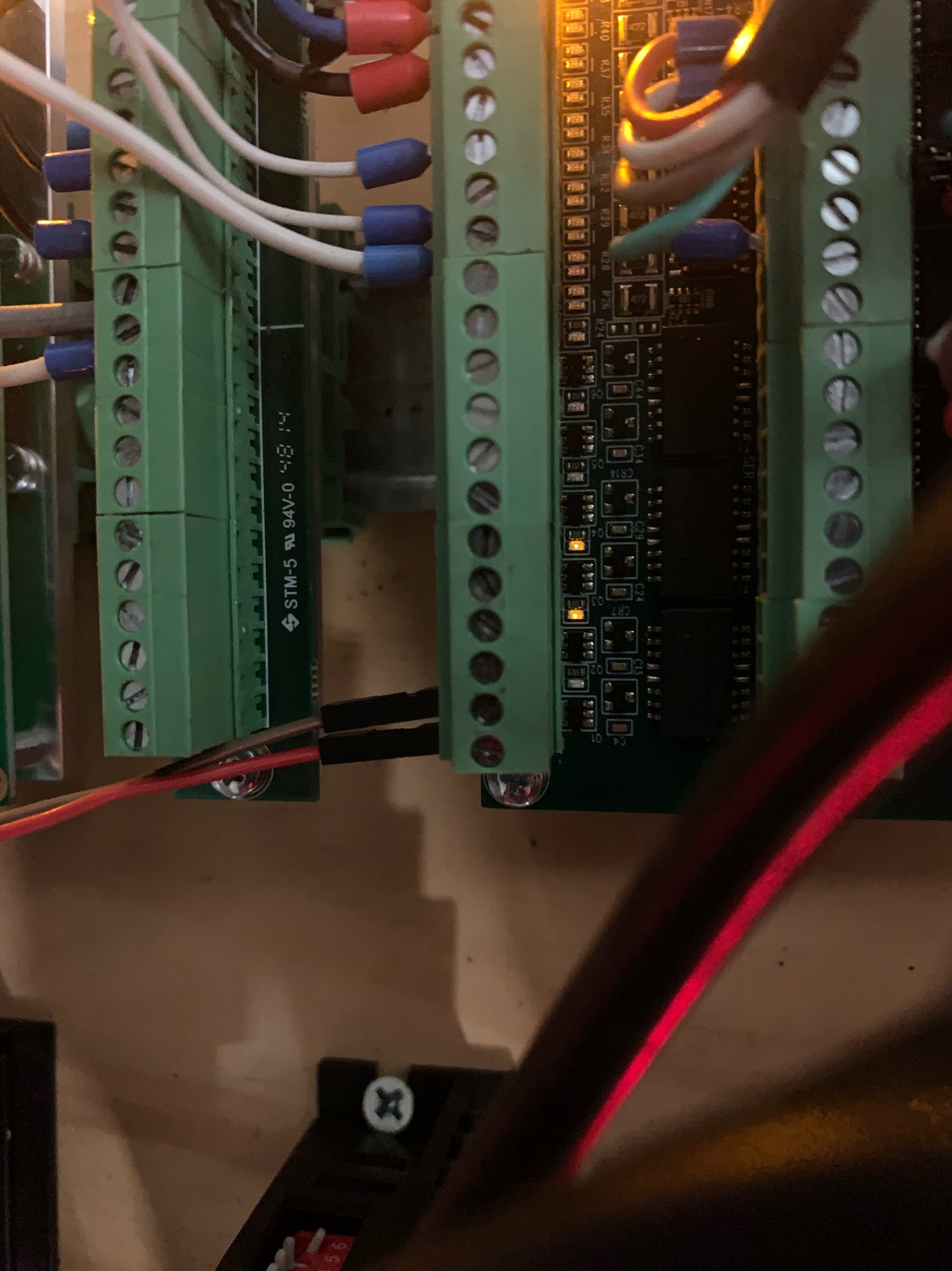

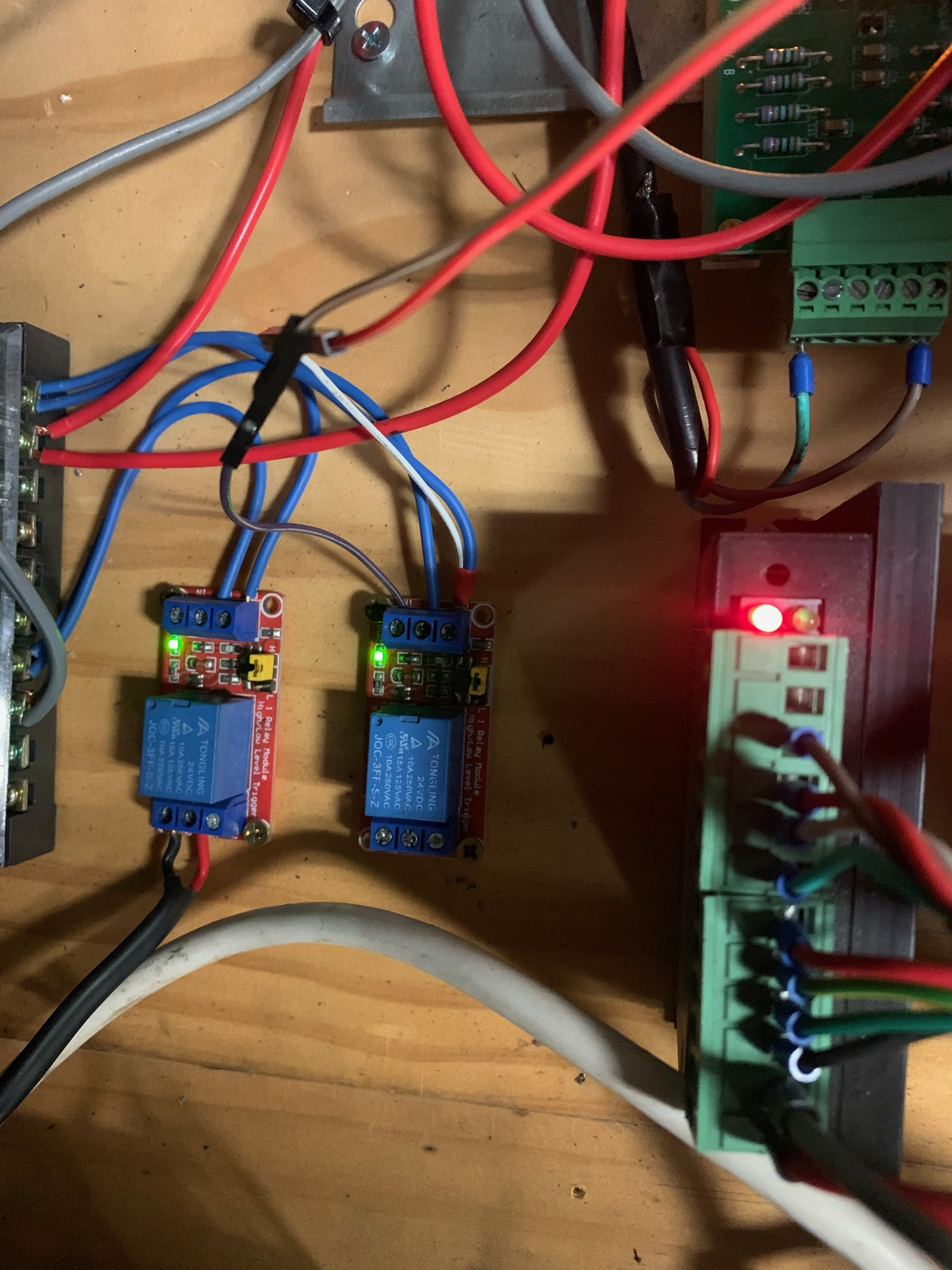

oh, the saga continues.
Yesterday managed to dial in the settings with some help for the thc. all cutting great, good height control, great lead in and out.
According to the statistics page I have over 200m of cutting and 1000's of pierces.
THEN ...................
nothing, no spark, check power to plasma - fine, power to MESA - fine, change nozzle - fine, still nothing,
The mesa output led seams dim compared to the other lights (input led's), but it still comes on and off like it should, replace relay and all wiring to plasma, still nothing. Give up for the night.
Tonight back at it trying to get it going. redo all the wiring again, change to output 2, change relay, double check everything from pictures of setup that worked, double check all MESA manual setup, etc.
NOTHING...........
Thinking there may be something wrong with he outputs I go all the way to output 5. change settings in the HAL. check to ensure the right output is firing, connect everything, test, BAM it's all working, torch fires as requested. SWEET.
Start to cut, first holes cut, second hole cut, third hole - torch doesn't fire. FFS. check in the control panel to find that the LED for output 5 doesn't light up when I activate the torch. BUGGER. upon closer inspection output 4 and 3 led's are glowing.
Just a random guess, but, I think the outputs may be fried, another MESA board gone. actually lost for words right now.
any suggestions?

If 7I96 outputs are being damaged, it suggests a major EMI, ESD or grounding issue
I would at the minimum:
Mount the control electronics in a grounded metal case
Ground the 7I96's frame ground connection to this case.
If your plamsa source is not designed for CNC use, feed
any control wires from the the plasma through a RF filter
(this may be as simple as a 0.01 uF 500V capacitor to frame ground)

As I explained in the other thread, the Cut 50 plasma source is a HF start
device, these generate massive amounts of EMI when starting the torch.
At least some of these have a spark-gap HF source, basically a Tesla coil...
HF start generates so much EMI that in general HF start plasma devices
are not recommended for CNC use at all. To use them requires very careful
shielding and grounding and keeping all wires from the plasma cutter far way
from any signal wires.

OK, new MESA 7i96 board has arrived. New UNIMIG Cut45 is in place. checked the resistors in the plasma to get 20:1 divider ratio to suit the MESA THCAD10.
Final connections tonight from the plasma to the SSR relay (for torch firing), Arc OK input on MESA board, IN+ and IN- to the THCAD.
maybe I'll get brave and try and get some cutting happening.
