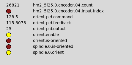

Now rigid tapping working and encoder count is set to 0 after hit index.Start orient after tapping with encoder count no past 232 encoder count working ok.But if turn spindle cw 50 times and stop. orient-pid.command and orient-pid.feedback is 50.0When orient start orient-pid.feedback is reset to 0 but orient-pid.command is still 50.0 spindle turn and not stop.
Actual hal
Actual hal

04 Sep 2023 19:00 #279862
Replied by Aciera on topic Mill atc configuration
Something went wrong with that Hal file upload.
I don't think we should be resetting the encoder count, so i would suggest to revert the last change.
So remove this:
net spindle-index-enable <= hm2_5i25.0.encoder.04.input-index
net orient-enable => and2.1.in0
net spindle-input-index => and2.1.in1
net encoder-reset <= and2.1.out => hm2_5i25.0.encoder.04.reset
and replace with this:
And remove the 'loadrt/addf' for the 'and2.1' component.
I would try again with this and check 'orient-pid.command' and 'orient-pid.feedback'. Maybe that points us in the right direction. Other than that I have run out of ideas for the moment and I don't have a system to test spindle.orient with.
So remove this:

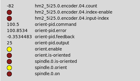

05 Sep 2023 09:40 #279937
by Artur_1617
Replied by Artur_1617 on topic Mill atc configuration
On 1screenshoot we have working orient with pid.coomand and pid.error after 100 turns of spindle and spindle turn and not stop. The pid feedback was to 100 but after hit index is set to 1
Aciera I make the change from Your last post today morning Rigid tapping working but Orient want to back to 0 encoder count 2scrrenshot
Anybody work with both orient and rigid tapping?

05 Sep 2023 13:42 #279970
by Artur_1617
I found solution.
In toolchange.ngc go to write (today tested and working)
M3 S30
G33.1 Z 0.1 K0.1
M2
After that command spindle is indexed and on position 1-4 encoder counts which is easier to setup orient pid becouse all time start from the same position.
Last things for now;
1. When orient point is close to 116encoder count for example 117 then back to 115 but passing by 116 and orient.is-oriented is set to High. Need to delay this. If is on 116 encoder position 1 second then orient.is-oriented go High.
2. Is possible make some output checking if encoder position is 114-117 then output is high? spindle.is-oriented go to high only for moment.
M3 S30
G33.1 Z 0.1 K0.1
M2

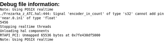

06 Sep 2023 10:04 #280080
by Artur_1617
- Posts: 4818
- Thank you received: 2176
06 Sep 2023 11:15 #280089
A type mismatch, encoder count is of type s32 while near expects type float.
option 1: use component 'conv-s32-float' to convert encoder counts to float type.
linuxcnc.org/docs/html/man/man9/conv_s32_float.9.html
option 2: use encoder position instead of encoder counts.
The following user(s) said Thank You: Artur_1617
