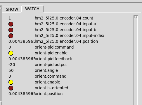

Yes but does 'orient.pid-.feedback' grow from 0 to 1 in one revolution? Theoretically it should get to 1.0 and then go to 0.0 but that may be difficult to do by hand.growing to next index pulse and set to 0.

Before we make scale orient.pid-feedback going from 0 to 1 and set to 0
Now with scale go from 0 to 0.00434782 and set to 0

If you look at 'hm2_5i25.0.encoder.04.position', what value does it count to in one revolution of the spindle?

Encoder.04.position go from 0 to 1 and on index is set to 0

I'm sorry there seems to have been a misunderstanding at some time because
if your hm2_5i25.0.encoder.04.position already counts from 0..1 we don't want the
'scale.orient' component.
So in your hal file change this:
# Encoder position into orient component and orient pid
setp scale.orient.gain 0.004347826
net spindle-revs scale.orient.in
net spindle-revs-scaled <= scale.orient.out orient.position orient-pid.feedback
to this:
net spindle-revs orient.position orient-pid.feedback
You can also remove the 'loadrt' and 'addf' for scale.orient.

I make the changes.
Today I try this before:)
But still orient want to go to index.
orient-pid.command and orient command is still 0
Screen with orient on

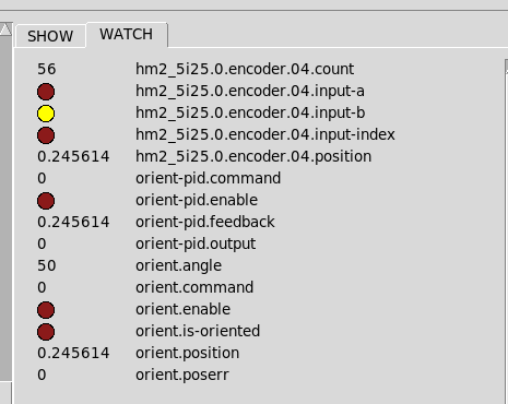

Hm, not sure, could you add 'orient.poserr' to the halshow?

Ok, it's taken me a long time but I think I found the problem:
Try and add this to all the 'addf' lines in your ini:
addf orient servo-thread
