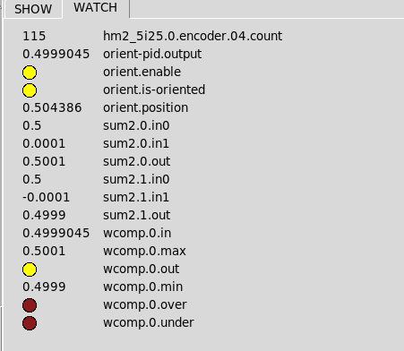

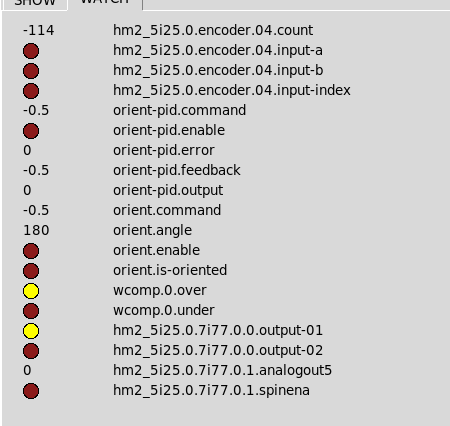

Orient start working but...
I ask R180 with M19 and this is 114 encoder count from index.
Spindle turn to this position and hit orient.is-oriented but is still on orient.enable should off?
If spindle turn last time in orient mode cw the output is still active and is imposible turn spindle cww try to press esc button orient.enable go off but cw output is still high
1screen orient.is.oriented High
2screen after press esc button

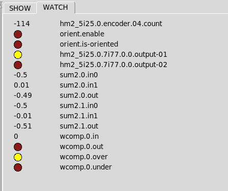

Still after orient dont off and spindle relay is on. After esc orient is off but relay is on.
Another cuestion is after orient high spindle still looking exact point of orient. If oscilating betwen 113 and 115 encoder count hit orient.is-oriented but still working and try to stop on 114 encoder position.

For problem 1:
We need to see if 'spindle.0.is-oriented' goes HIGH. Then check if 'spindle.0.orient' goes LOW.
For problem 2:
The wcomp component will output 'wcomp.0.under' = True for wcomp.0.in = 0.
So I would suggest to add a 'and2' component after 'wcomp.0.under'
Change this:
net o_rev wcomp.0.under
net o_fwd wcomp.0.over
To this (don't forget to add 'loadrt' and 'addf' for 'and2.1'):
net wcomp-under <= wcomp.0.under => and2.1.in0
net orient-enable => and2.1.in1
net o_rev >= and2.1.out
For problem 2:
Change this:

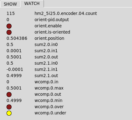

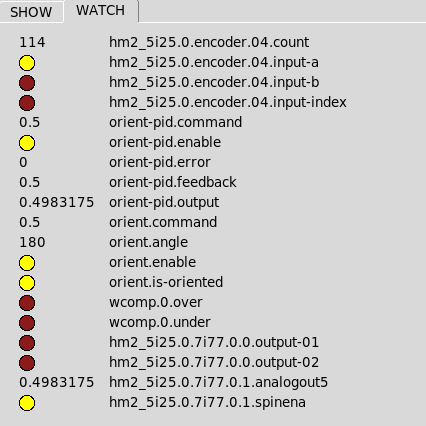

Replied by Artur_1617 on topic Mill atc configuration
Problem 2 is gone.
After hit orient spindle.0.is-oriented is HIGH and spindle.0.orient is LOW
