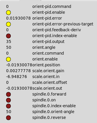

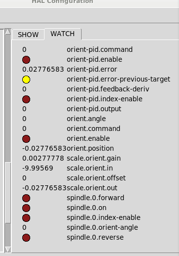

20 Aug 2023 13:20 #278544
by Artur_1617
Replied by Artur_1617 on topic Mill atc configuration
Not working.
screen8 is after turn 10times cw spindle with hand
screen9 is after start orient. And finish turn 10times cww for orient

Replied by Aciera on topic Mill atc configuration
If you look at 'orient-pid.feedback' and turn the spindle by hand, does is go from 0 to 1 in one revolution and then start at 0 again?

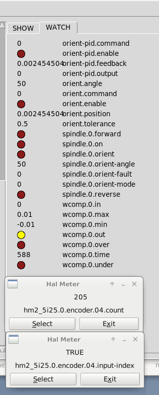

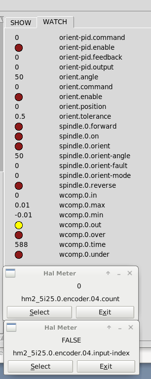

20 Aug 2023 15:58 - 20 Aug 2023 16:16 #278553
by Artur_1617
Maked the changes and;
If turn spindle cww encoder.04.count go from 0 to 232 then set to 0 and go again 0 to 232 and we have some orient-pid.feedback working
If turn spindle cw encoder.04.count not count nothing only when past index show 1 and back to 0. After this orient not start orient-pid.feedback is 0
When orient direction is close for run cww start orient and still turning becouse not count on encoder.04.count input
Encoder 04 is true out of index and is false when is on index is important?
Screen11 after turn spindle cw
Screen12 after turn spindle ccw
Sounds like your encoder scale is not correct, so you'll have to fix that first.If turn spindle cww encoder.04.count go from 0 to 232 then set to 0 and go again 0 to 232
