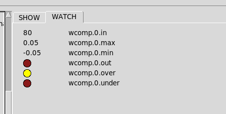

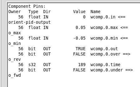

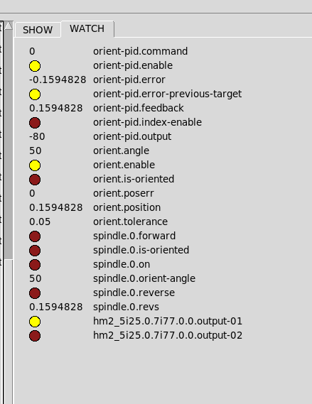

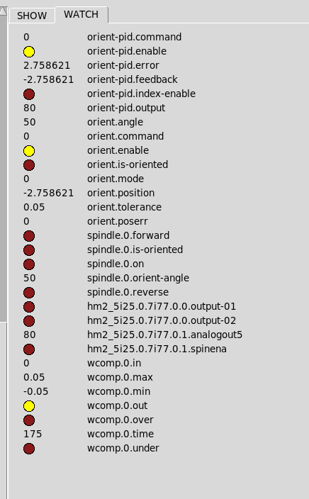

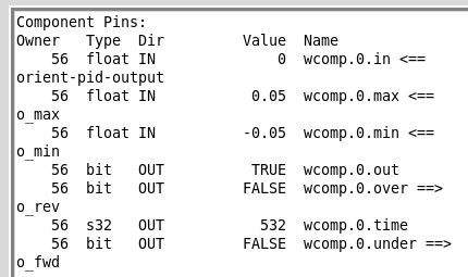

20 Aug 2023 09:19 - 20 Aug 2023 09:28 #278532
by Artur_1617
Replied by Artur_1617 on topic Mill atc configuration
Screens 2,3 with net orient-pid-output orient-pid.output => wcopm.0.in and #net spindle-orient-output orient-pid.output => mux2.0.in
Screens 4,5 with net orient-pid-output => wcopm.0.in and net spindle-orient-output orient-pid.output => mux2.0.in
Last edit: 20 Aug 2023 09:28 by Artur_1617.
- Posts: 4811
- Thank you received: 2164
20 Aug 2023 09:44 #278533
Replied by Aciera on topic Mill atc configuration
Could you add the wcomp pins to the halshow watchlist you had in this post?
forum.linuxcnc.org/10-advanced-configura...tion?start=50#278523
Otherwise we are just going around in circles.

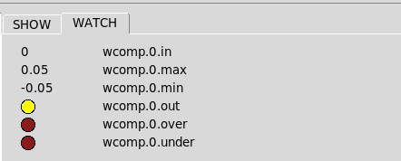

- Artur_1617
- Posts: 160
- Thank you received: 5
20 Aug 2023 09:57 #278536
by Artur_1617

20 Aug 2023 10:22 #278537
I'm sorry, I got confused:
1. In your hal file delete this line:
net orient-pid-output => wcomp.0.in
2. then change this line:
net spindle-orient-output orient-pid.output => mux2.0.in1
To this:
net orient-pid-output orient-pid.output => wcomp.0.in => mux2.0.in1
To this:
The following user(s) said Thank You: Artur_1617
