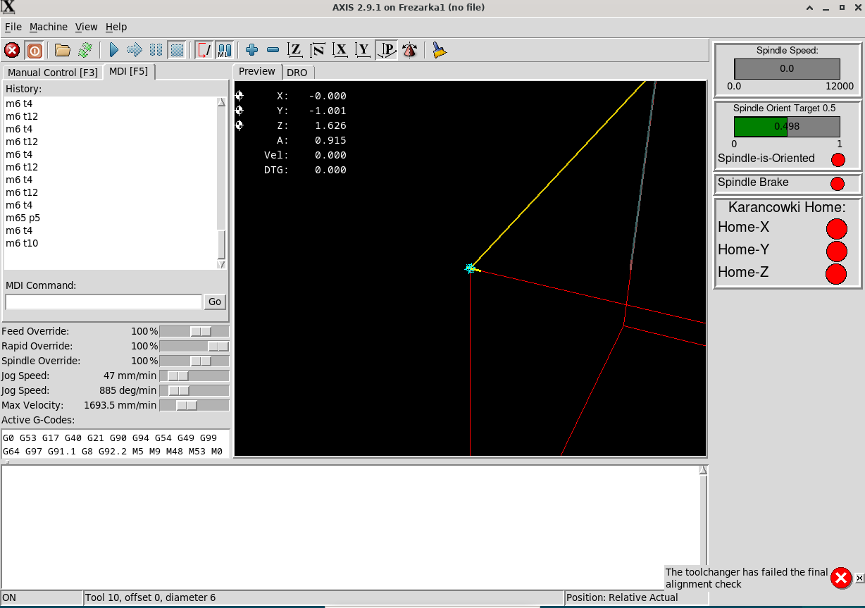

Back to setup.
After install linuxcnc 2.9.1 I start my program for try tool changer who changes tools from 1 to 12
First is M6 T1 the tool changer looking index and turn to the 1 pocket take the tool
Second is M6 T2 Tool 1 back to pocket but changer start turn only for short time and get error "The toolchanger has failed the final alignment check"
After that program is still going M6 T3, M6 T4... But changer dont turn only load and unload to First pocket
When I test atc in 2.8.2 version it didn't happen

Problem found
M64 P0 ; start carousel
;G4 P2
