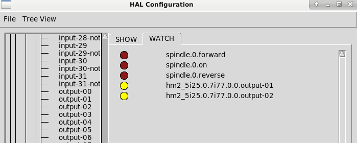

net spindle-cw => or2.2.in0
net o_fwd => or2.2.in1
net spindlecwall <= or2.2.out
net spindlecwall => hm2_5i25.0.7i77.0.0.output-01
net spindle-ccw => or2.3.in0
net o_rev => or2.3.in1
net spindleccwall <= or2.3.out
net spindleccwall => hm2_5i25.0.7i77.0.0.output-02
Linuxcnc start.
I can still using spindle cw/ccw buttons.
But when start orient spindle dont wont turn. Whatching hal pins and starting orient only see orient.on without spindle.on or spindle cw/ccw.

Some progress
Add;
adff sum2.0
adff sum2.1
Now linuxcnc start without on relays cw/cww
But try M19 R50 Q10 P5 spindle dont turn any relays cw/ccw on with orient
screenshot when start M19...
Last hal
How to look what missing for start the spindle with orient?

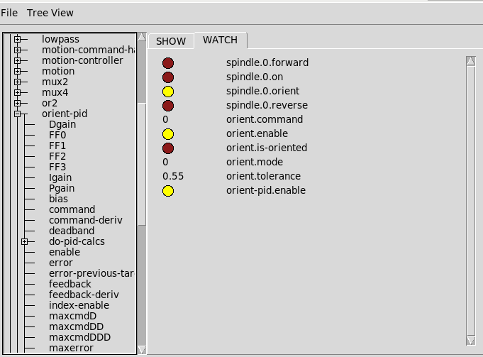

Add;
adff sum2.0
adff sum2.1
Last hal
- Posts: 4819
- Thank you received: 2176
15 Aug 2023 13:22 #278045
Replied by Aciera on topic Mill atc configuration
Seems that you have not connected 'wcomp.0.in' to anything.
Maybe that needs to be connected to 'orient-pid-output' so you actually get a signal from the wcomp to run the spindle forward or reverse.

15 Aug 2023 13:46 #278046
by Artur_1617
Replied by Artur_1617 on topic Mill atc configuration
net orient-pid-output => wcomp.0.in dont change anything...Seems that you have not connected 'wcomp.0.in' to anything.
- Artur_1617
- Posts: 160
- Thank you received: 5
15 Aug 2023 15:47 #278049
by Artur_1617
When make M19.. and watch orient-pid.output in hall config Value dont change is still 0
- Posts: 4819
15 Aug 2023 16:06 - 15 Aug 2023 16:06 #278050
so you will need to go and look further upstream.
Look at 'orient-pid.enable', 'orient-pid.feedback' and 'orient-pid.command'
Which brings me to the next issue as it looks like you are missing a link from 'orient.command' to 'orient-pid.command'. This would explain why 'orient-pid.output' remains zero.
