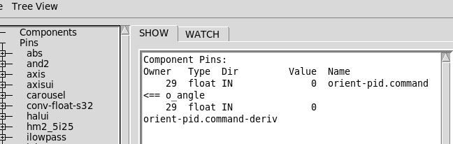

You have two options:
1.option: change your signal definition to this:
net o_angle orient.command sum2.0.in0 sum2.1.in0 orient-pid.command
2.option: reuse the already defined signal and just this line:
net o_angle orient-pid.command

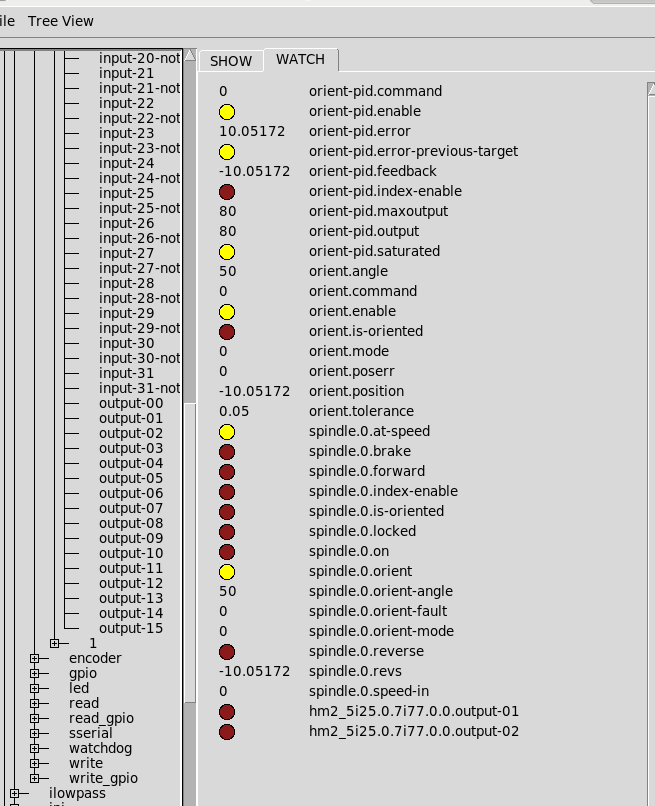

Try to change all settings from ini P, I, D etc.
But see only change in orient-pid.output if change Bias, now is set to 80. I can put more but limit is MAX_OUTPUT set to 80 for now.
But not relays cw/ccw on, or turn spindle.
M19.. finish with TIMED OUT.

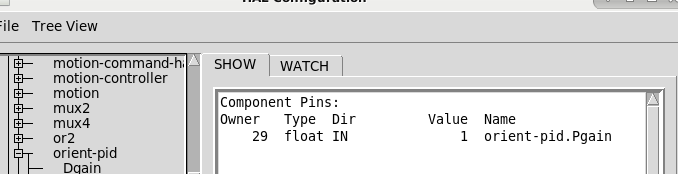

Not sure why that pid is not doing anything really. I'm afraid I have run out of ideas for the moment.
Other than maybe check in halshow if it really has those parameters like 'orient-pid.Pgain' and so on actually loaded.

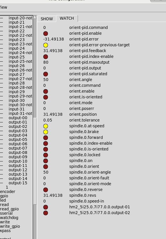

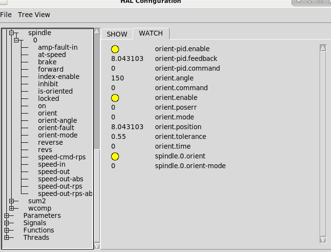

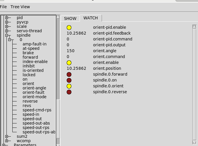

19 Aug 2023 17:15 - 19 Aug 2023 17:18 #278479
by Artur_1617
Replied by Artur_1617 on topic Mill atc configuration
When start M19.. spindle dont turn, relays dont on.
See in halshow start orient-pid.enable etc.
orient-pid.output change to 80 is max value from maxoutput
Before start spindle.0.orient-angle and orient.angle is set to 0 after M19 is set to 50 and dont change. Must close linuxcnc and value is set to 0 again
In ini Set P6000, I300, D90
Screenshots from halshow before orient and with orient ON and connection from orient-pid.command
What more I can do?
What more I can do?

20 Aug 2023 04:11 #278520
Replied by Aciera on topic Mill atc configuration
Looks like the orient-pid is suddenly working now so following the pid-output downstream it seems you have commented out the connection to the wcomp input:
#net orient-pid-output orient-pid.output => wcomp.0.in
That would explain why nothing is happening at the spindle.
