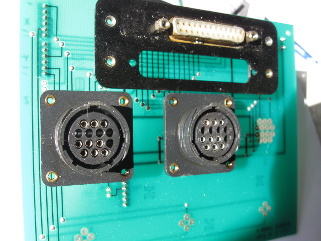

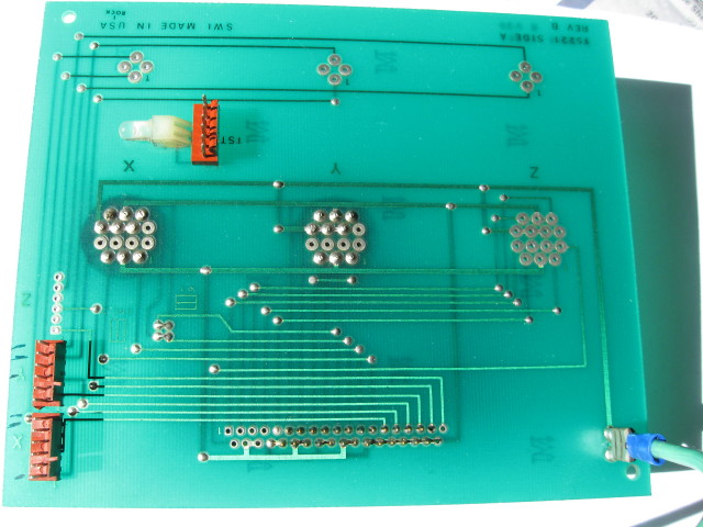

19 May 2016 01:59 #74831
Replied by Todd Zuercher on topic retrofit Bridgeport Prototrak Plus
Upon closer inspection of the two pictures above, of the breakout board (that may be generous to call it that even, since it is only a bunch of traces connecting some plugs.) It looks like the 3 control wires that go to the amps, may in fact only be connecting 2 of those wires to anything. There does appear to be a set of pins jumper-ed with a loop of wire at the amp end of the control cable (other red plug). It is possible that the jumpered connection at the amp is the enable, and the only connection to the control is the analog signal.
I guess we must assume that the control disables the amps simply by cutting power to them?
In fact I am almost certain of it. After reading some of the diagnostic procedures in the manual, one of them is a test of the control signal to the amps, by unplugging the red plug from the amp and plugging it into the "test port" on the breakout board above, commanding a move in one direction causes the led to glow green and revearsing direction past in the opposite direction causes it to glow red.
To add an amp enable circuit you will have to experiment a bit (my money is on that black jumper wire), or ad a relay or contractor to cut power to the amps like the old control.
As to your encoders they look to be the ordinary differential type without an index signal. I was able to find pictures of ones like yours that made it pretty clear which wire was which at the encoder, you probably will have to disassemble the plug to double check the pin-outs. (not to big a deal).
